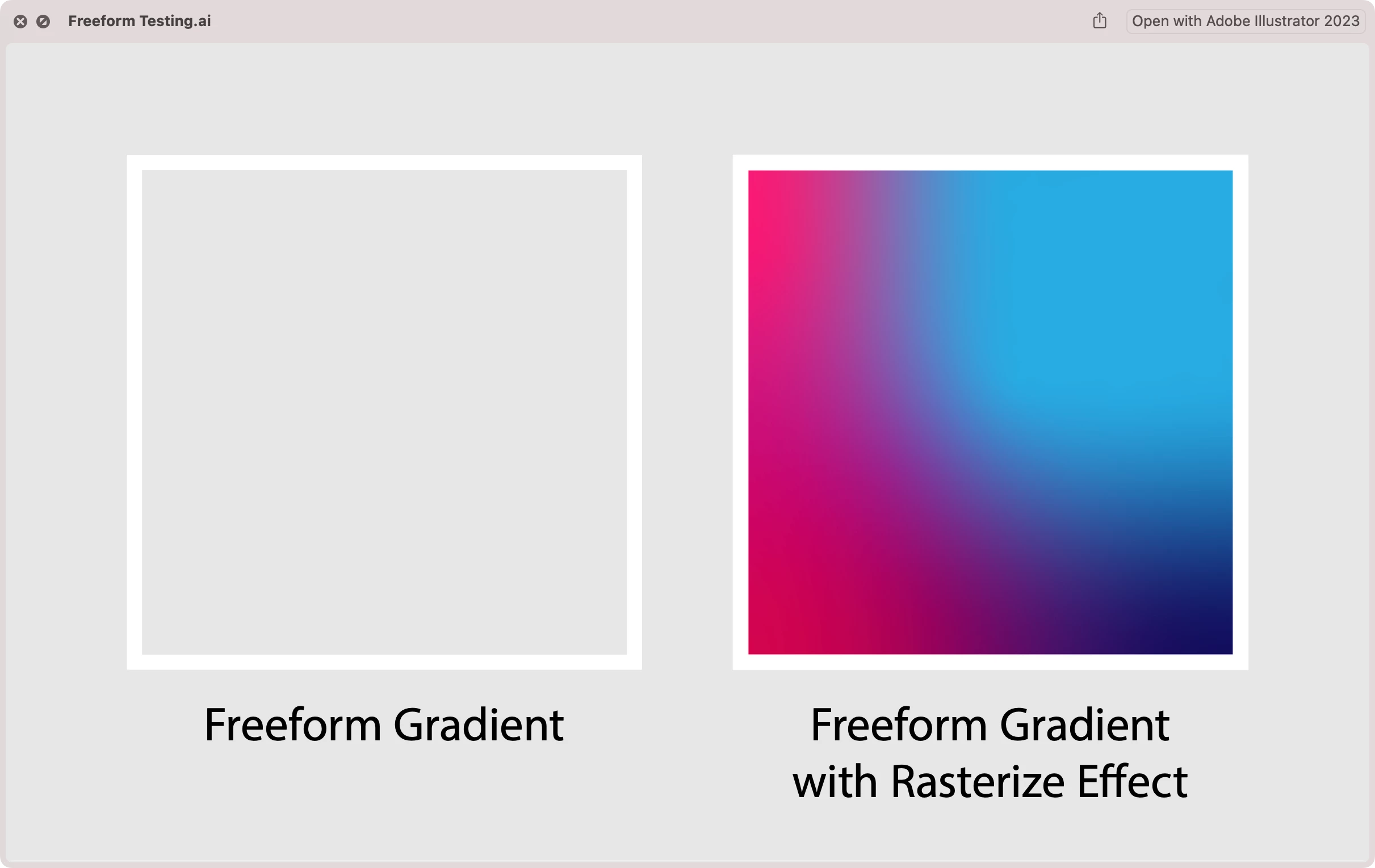

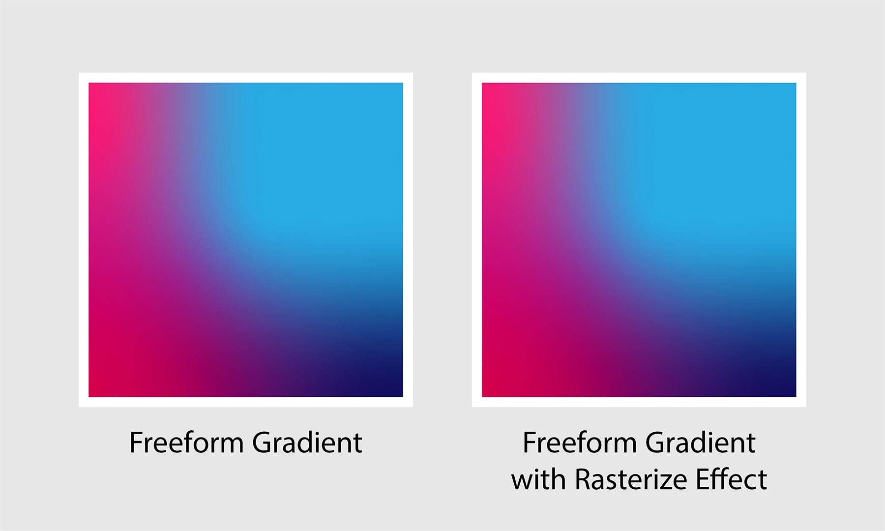

I'm having the same problem. Ever since upgrading my M1 MacBook Pro to MacOS Ventura, Freeform gradients are not visible in QuickLook Previews or the Preview app. The data is still there and can be seen in Acrobat or Illustrator. This is definitely an issue with MacOS as this problem is present in old files with Freeform Gradients as well. Very frustrating.
As I continue to hunt for a fix, I'm going to be looking at what has changed with Preview that prevents freeform gradients from rendering.
In the meantime, seems like Effect > [Illustrator Effects] Rasterize... is the best bet for keeping the gradient editable and preserving its appearance in the default programs.
I've attached a sample file as an AI, PDF, and exported as a PNG. Then a screenshot of the preview as it appears in Finder.
