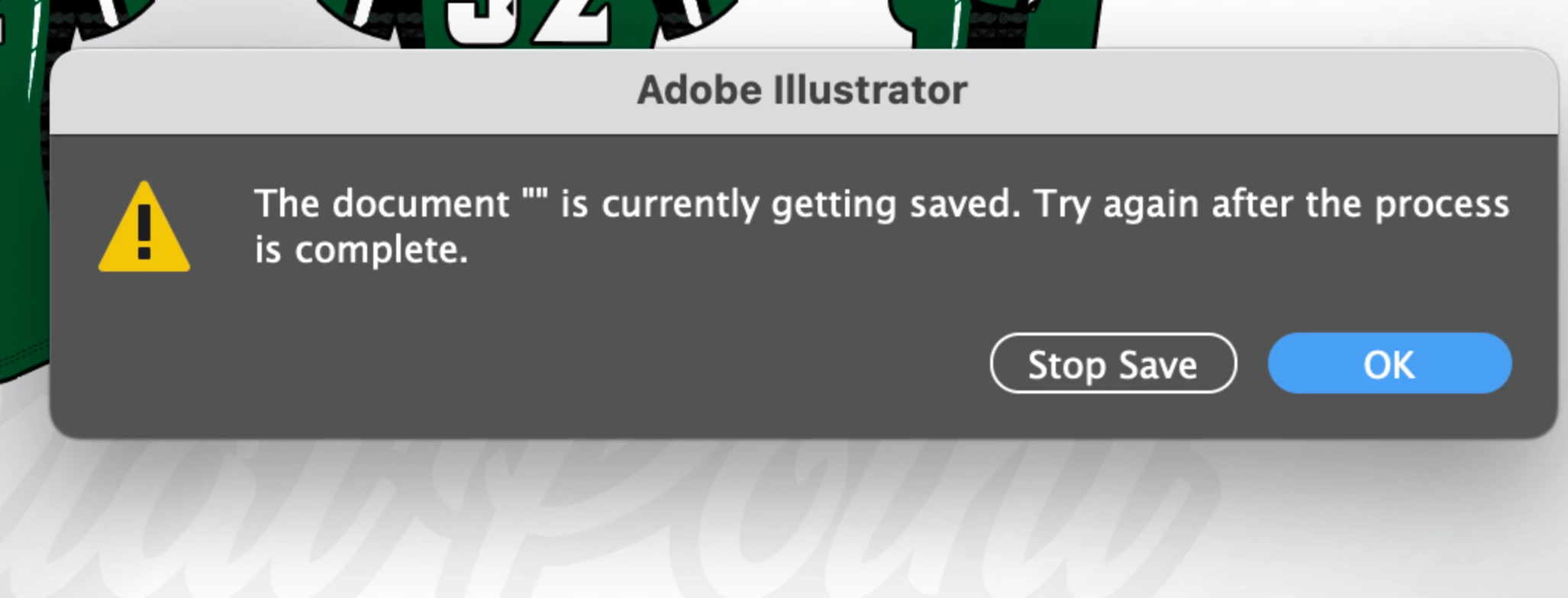

Hi
I keep getting this pop up message when I try to save a file after I recently saved another file.
Does anyone know what this means/how to resolve the issue?
Thanks!

I'm also having the same issue at work with the latest version of Illustrator. Hopefully it gets resolved soon -  making it difficult to get things done.

Did you already try turning off "Save in background" in the Illustrator preferences?
August 27, 2025
I did and it seems to help, but the saving process is a lot slower than it used to be.

It sounds to me like Illustrator's background saving feature may be causing the problem. This feature allows you to get back to work on a file while the document continues getting saved. This is especially helpful with large files that take a long time to save as without this feature you would not be able to resume working on a file until the save was finished. If you tried saving a second document while still background saving the first then I could see getting the popup that you did. If you would prefer not to use background saving then you can turn it off in the File Handling section of your Illustrator preferences (settings).

I forgot to mention that I just updated to the latest version of illustrator, 29.7

Hello @Alexisbaer,
I'm sorry to hear about the trouble you're having. Our team has pushed an update to Illustrator 29.7.1, which should help alleviate this problem. Would you mind updating Illustrator and letting us know if it helps?
Looking forward to hearing from you.
Anubhav
