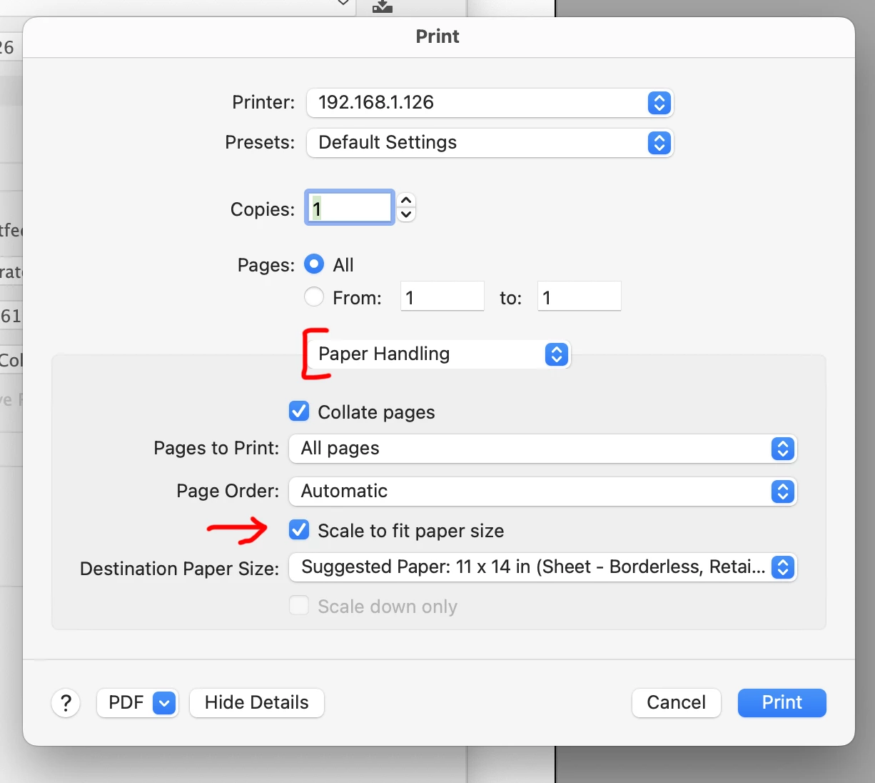

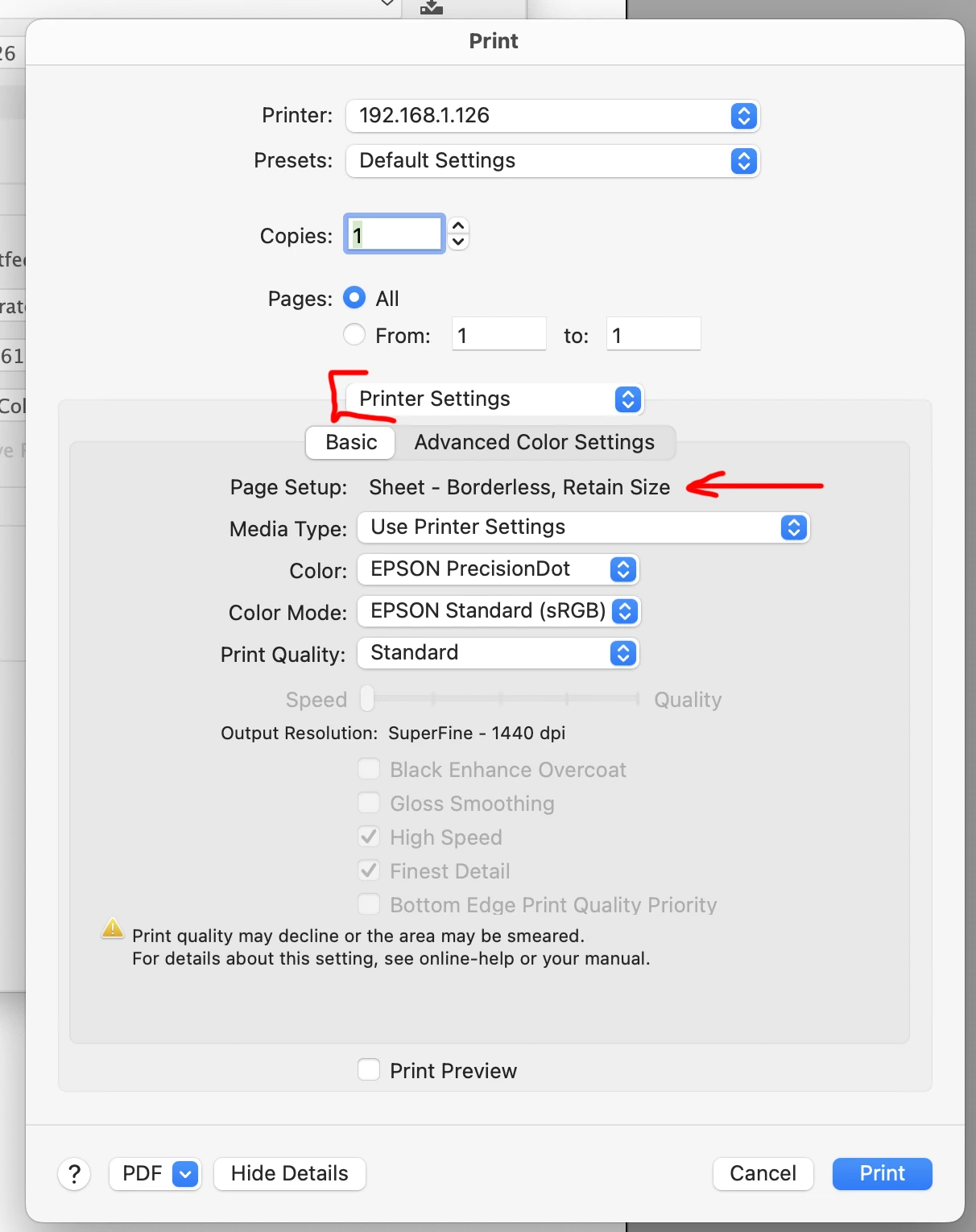

That increase is 4% which is Epson's usual increase for borderless.
Can you show us a screen grab of the paper size you have selected in Page Setup. (You didn't say you created a Custom one).
Also, there are a couple more places you have to check for settings. Even if you areusing a Custom Page size with set margins, and even if you are printing at 100% in Illustrator's Print Dialog, the P700's driver has settings that may conflict with this: particularly:
