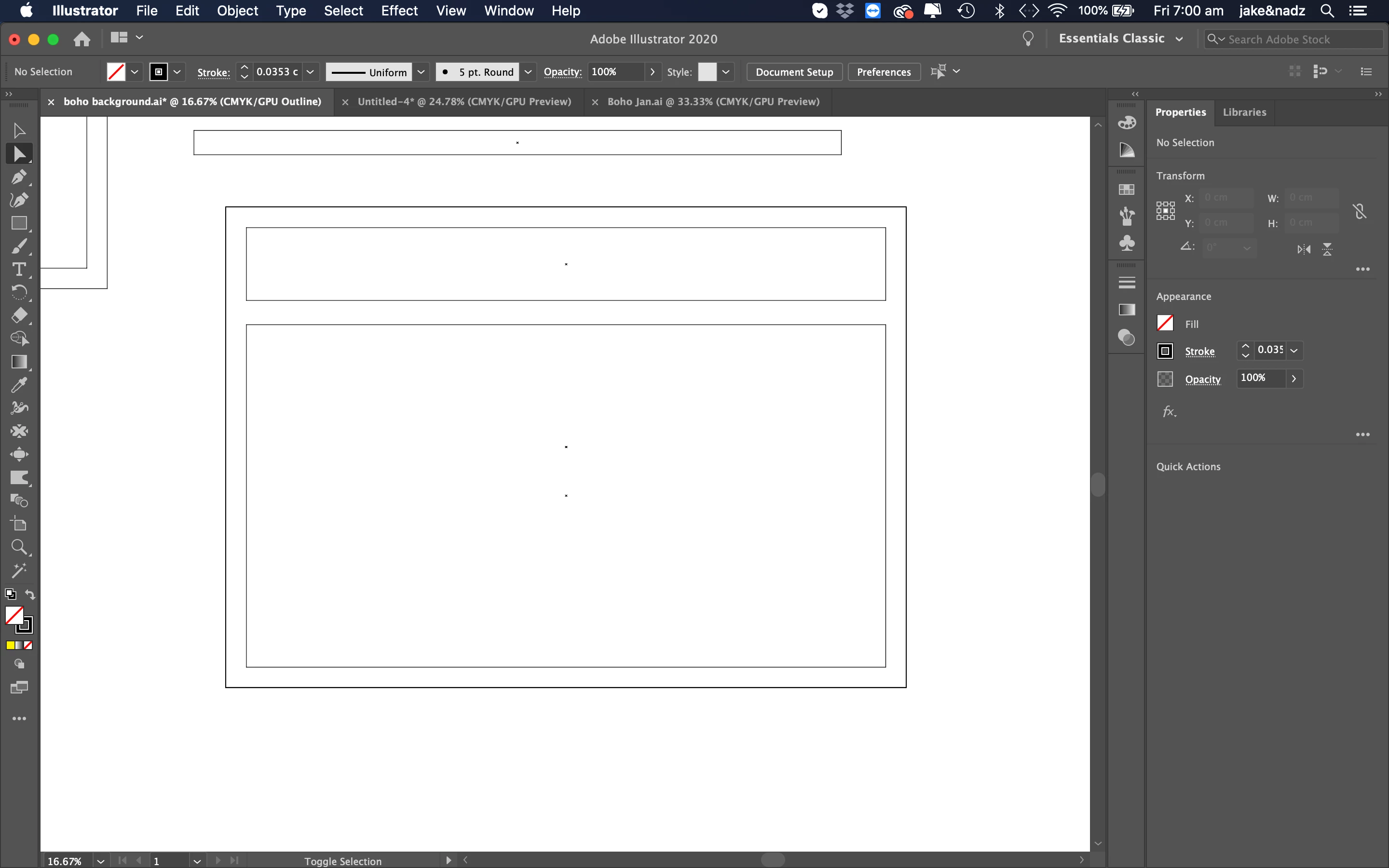

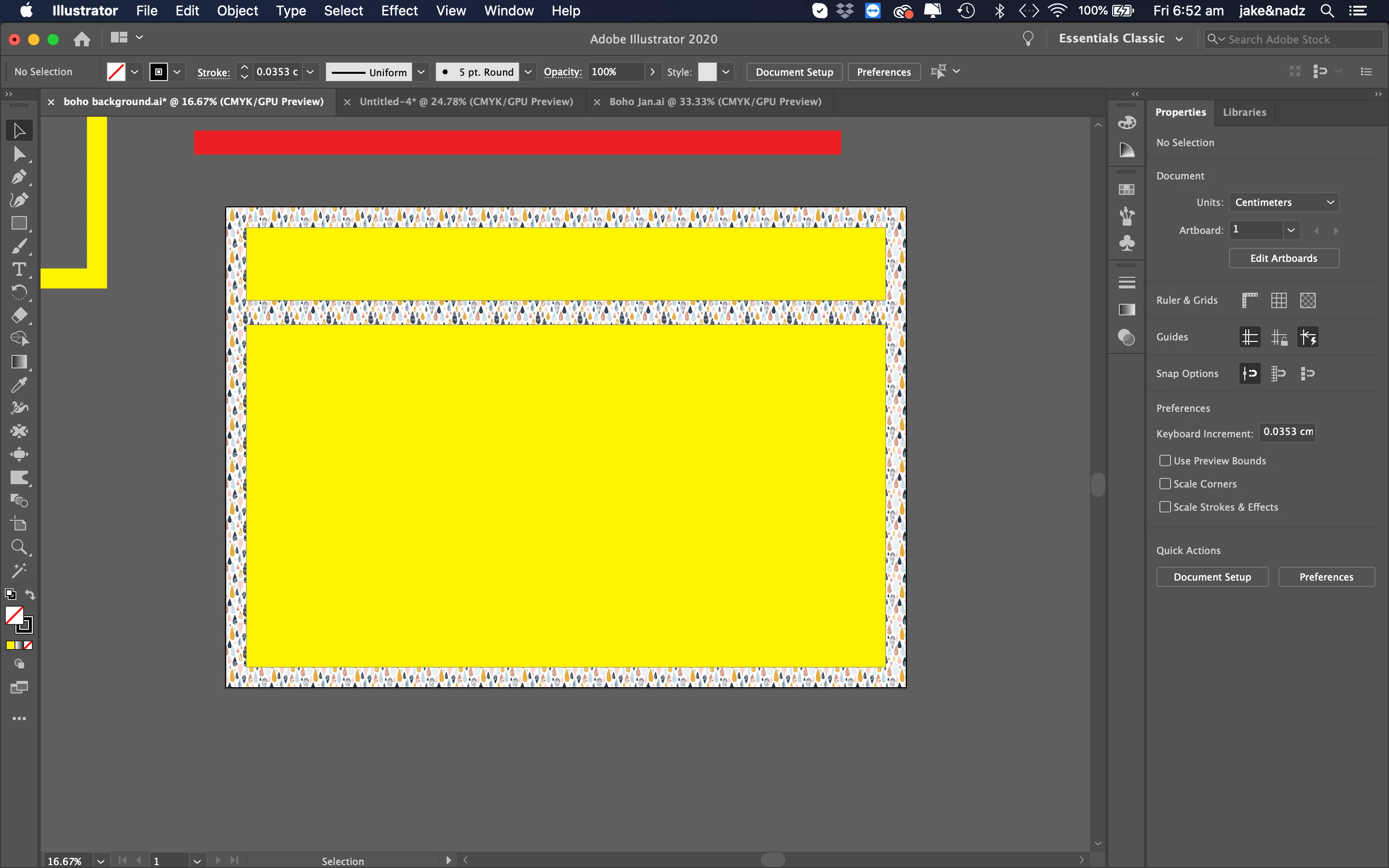

I'm trying to delete the yellow rectangles with Pathfinder (click to minus front) so that there's transparency in those areas.

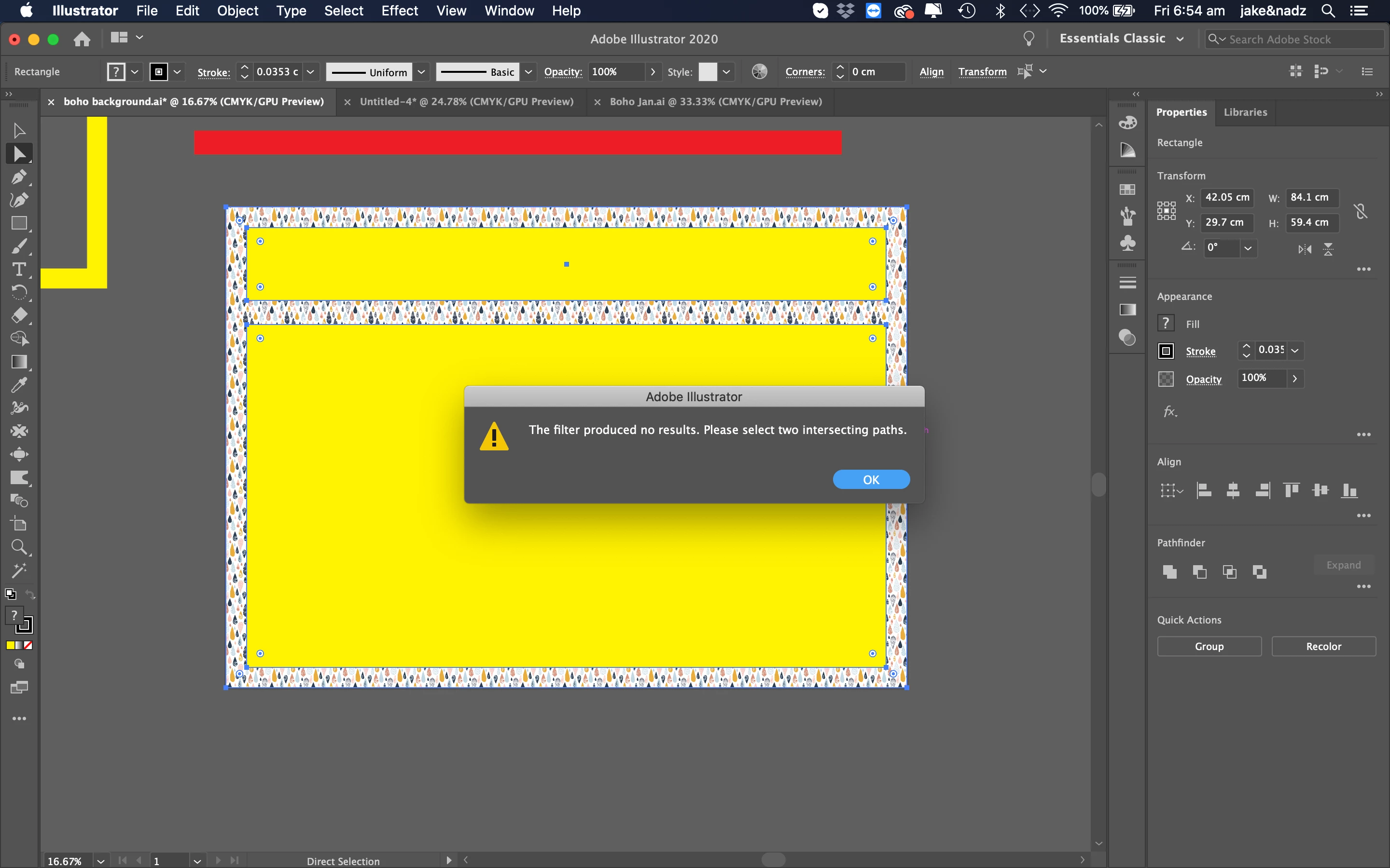

I did it before with no issue but I'm now getting no results and the message "Filter produced no result. Please select two intersecting paths."
Mac OS Catalina 10.15.6
Illustrator version 24.2.3

I had the same thought regarding the pattern. However, I ran a test and I was able to happily cut holes in an object with a pattern. Perhaps you could cut holes in your objects and then just apply the pattern afterwards?
I got it to work! Yay! I had to only have one yellow rectangle that I wanted to minus on the artboard at one time over the fill for some reason (instead of the two).
Thanks for your help and suggestions!

Sometimes, strange temporary corruptions appear, and I believe this may be one such case. It may heal itself when you close down/restart, and then you can do it/similar in the normal way.
My guess is that your clever roundabout solution with minus one path (at a time) would also (have) work(ed) if you (had) turn(ed) the two into a Compound Path (Ctrl/Cmd+8).

Thank you Jacob! I think you are correct in that Illustrator was having a bad attitude yesterday (however you said it more eloquently) because it was doing other strange things. I kept getting a spinning wheel when I was trying to expand appearance or offset path. Also, it would adjust both size measurements of an object when I had the link unticked. I tried restarting illustrator. I tried restoring default settings. I spent hours in frustration with no luck.
Going forward, if I have the issue again, I'll turn them into a compound path. Thanks for the suggestion!

Check the stacking order of your objects. I get the same error message when the large shape to be cut out is in front, instead of behind, the objects that are to do the cutting.
JNKAJ7Author
August 7, 2020
Thanks for your reply Michael. The yellow rectangles which I want to minus are definitely in the front because the fill is on the rectangle in the back. I did verify to make sure they are in the front. Any other suggestions please? Thank you in advance, Nadya
JNKAJ7Author
August 7, 2020
It must have something to do with the pattern fill because I can do what I want to do when there's just a solid color fill but I need the pattern.
