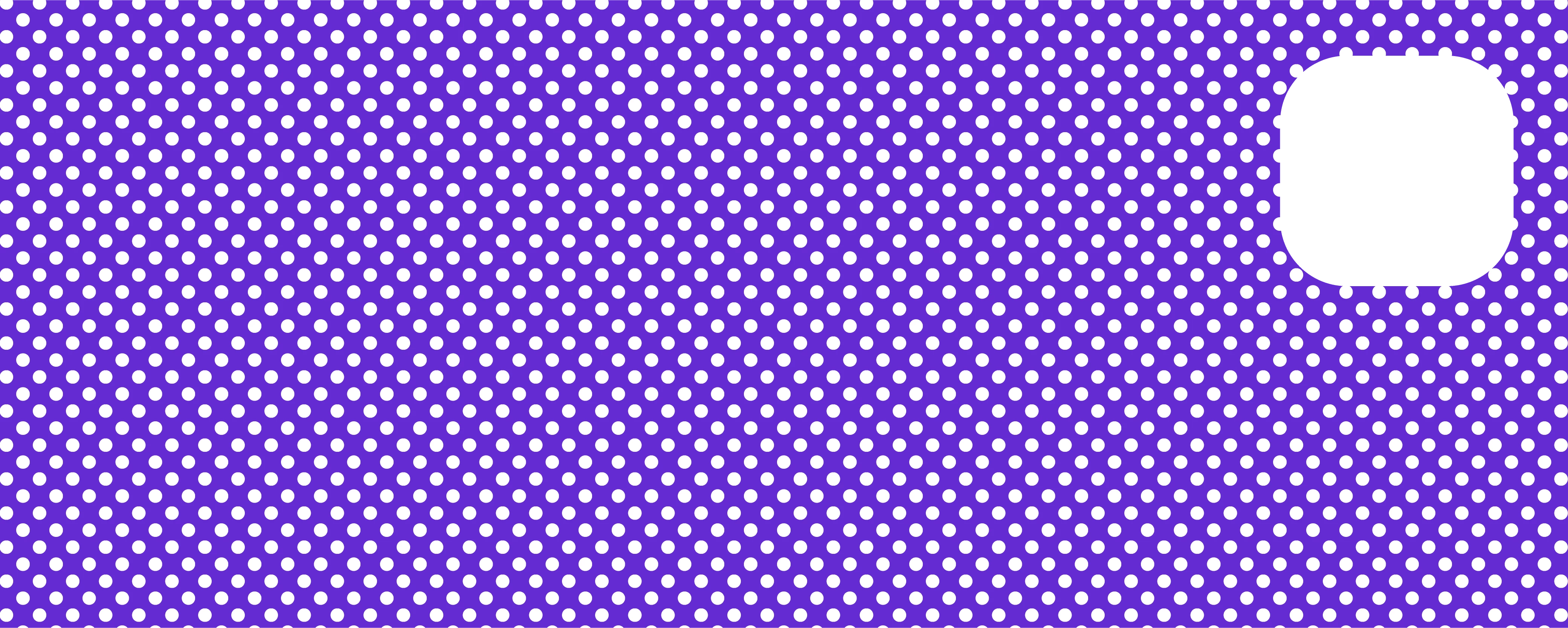

Hi all. Have stumbled onto a massively frustrating glitch on the Illustrator pattern tool.

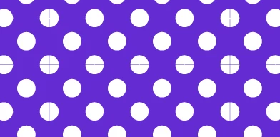

I've made a seamless repeating pattern which I'm using for a series of banners. The pattern tiles seamlessly on Illustrator, but when I export as a JPEG (for my client's social media banners) a tiny joinline becomes visible on the edges of the pattern.
I've zoomed right in on the pattern on Illustrator and join lines definitely aren't there. They only show up in the exports. Anyone had any experience with this? It's a polka dot pattern so don't really have the time to manually paint the join line out every time I need to use the pattern.
Jpeg attached so you can see the issue.

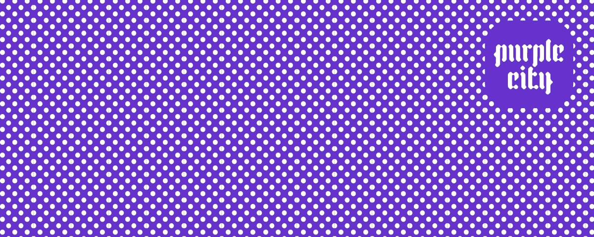

Please help me to understand.
Go to my first post in this thread. I uploaded an exported PNG file from that AI file. I cannot see any lines or other stranges things. All was done with Illustrator CC 2020 (24.0.2)
Can you see any lines in this uploaded image?

You were probably lucky. You probably exported with Art Optimized  anti-aliasing at 300ppi
Type optimized shows the lines.

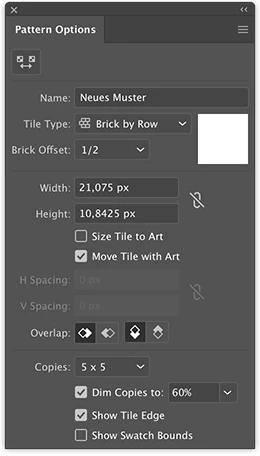

But it is caused by another problem, your pattern was originally made in mm and that does not convert to whole pixels. Fractional pixels in pattern dimensions cause these anti-aliasing artifacts (lines).

Images have their limitations, you cannot use a fractional pixel size, there is no such thing as half or a quarter of a pixel. Only whole pixels exist. When Illustrator has to export a fractional pixel it will generate a new pixel which can cause a visible line.
You may check the size of your pattern in pixels, and work in pixels (or points) when you want to export later to an image format.

Alright for whatever reason this forum has made that banner so small you can't see the error.. Not sure what I can about that.
Another classic bit of Adobe service.
