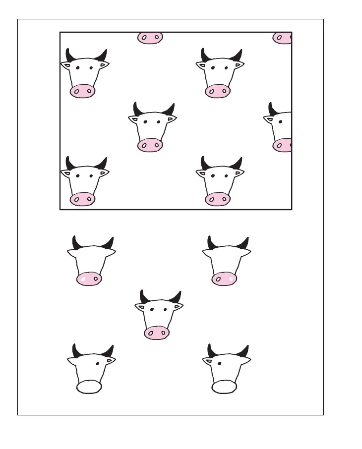

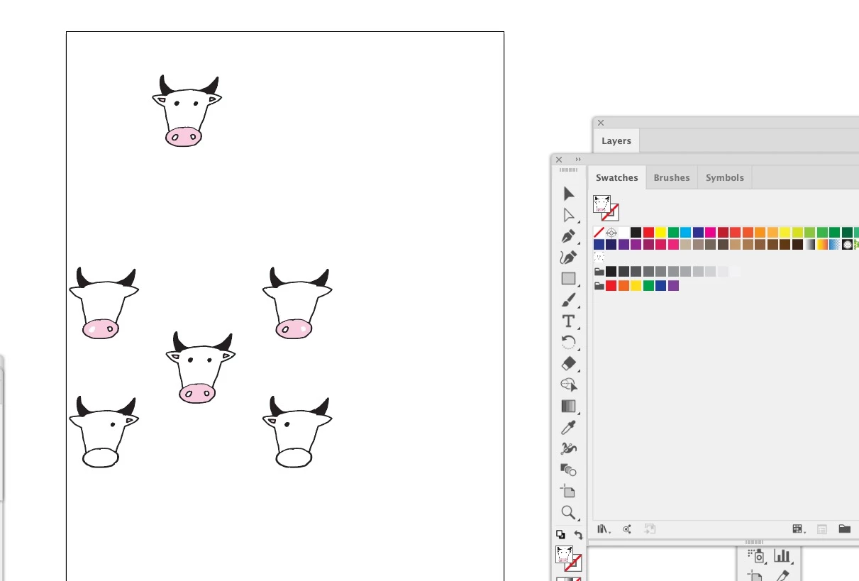

So I've used the swatch and pattern functions well in the last few weeks. But now this is happening. When I create a pattern from my vector and save it as a swatch, everything appears the way it is supposed to. But after the swatch is created and saved, when I drag the swatch and apply it on my page, the pattern is missing some elements (eyes, nose etc.), The actual pattern created displays the items correctly with no missing parts. This only happens when I drag and apply the pattern swatch to the page. Help!!
Correct answer melissab82018159
So I just figured out what happened 🙂 When I create an empty square on my page and then click the created swatch from my swatches to populate the square, it works fine. What I was inadvertantly doing was dragging the created pattern swatch from the swatch panel and plopping it down onto the page. The result of dragging and dropping the pattern swatch onto the page (as opposed to placing the swatch inside a defined square) was resulting in missing elements from the pattern. Thanks for the help!!

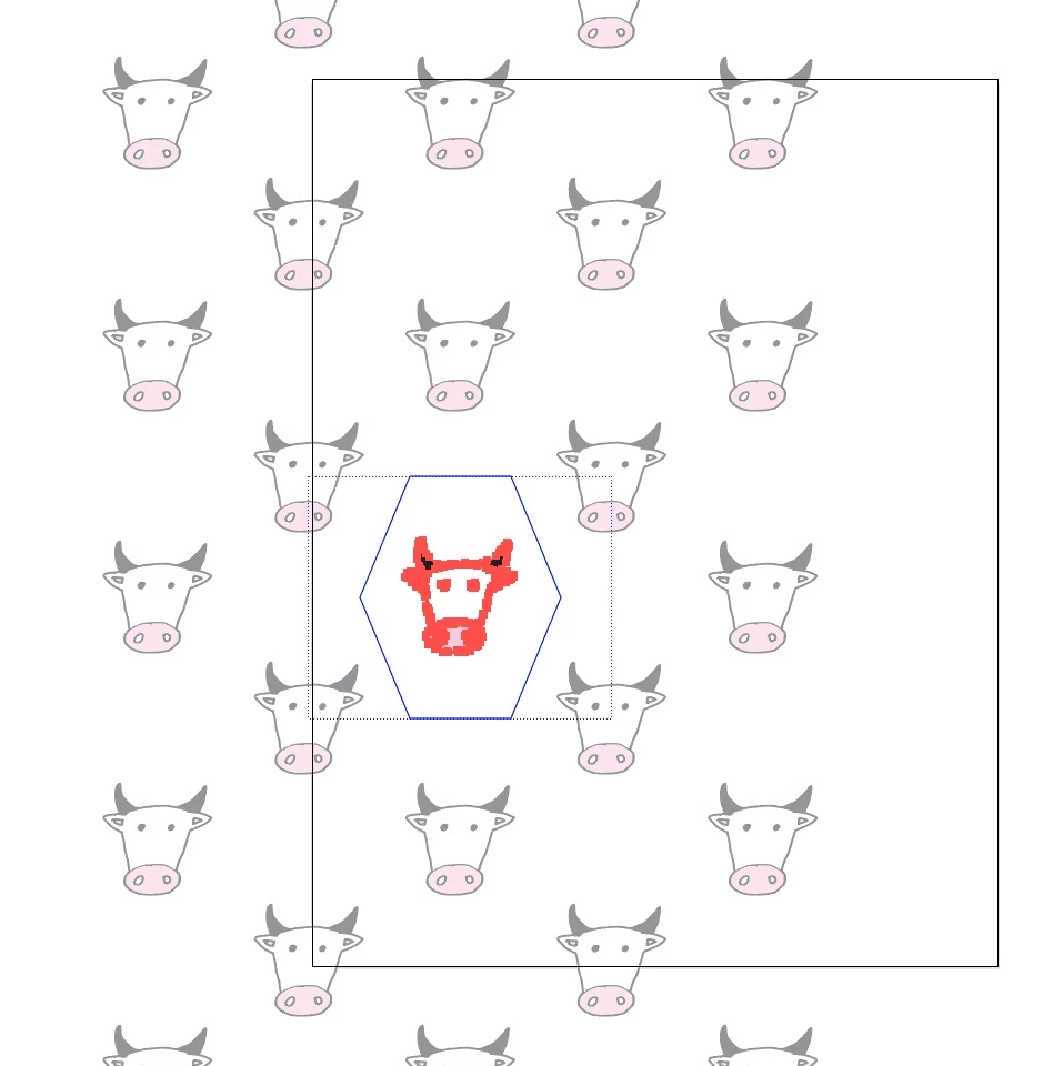

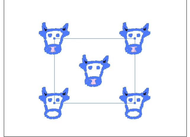

Did you create the pattern with the Pattern Maker?
When you drag the pattern from the Swatches panel, is there an invisible rectangle at the back of the pattern? You can see that in the layers panel at the bottom of the group.
Everything inside this rectangle defines the pattern, everything around it is generated by the Pattern maker and shows only parts.
February 28, 2020
Hi, yes thanks. There is a rectangle around the vector that defines the pattern. Attached screen shots.
