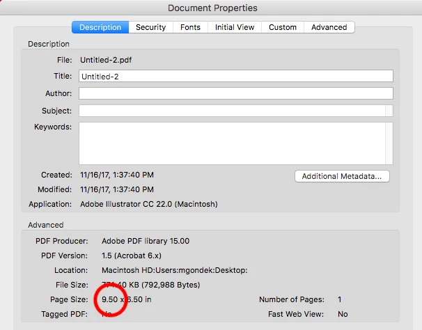

This is because the marks take up more than .25"
With .25" bleed your marks go outside the bleed (shown in red).
Mike_Gondek10189183
November 16, 2017
If you do .5" bleed then you would get the number you expected.
