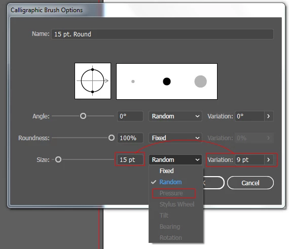

If I understand you well, you've done just a part of needed actions.
When you set the pen sensivity, it's not enough. You have to set the sensivity of the brush that you're creating. Here is the example for Calligraphic brush, and I don't have a tablet on this comp, but the way is the same for all brush types:
Set the basic brush size, choose Pressure as a control and define the variations (the amount may be from 0 to Size value). If Variation =0, you have the uniform line, if it's near the Brush size, the stroke weight varies from 0 to double Brush size. Yiu can set limits like you need.

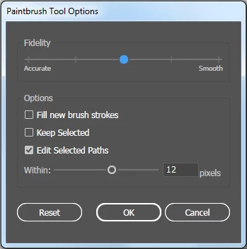

To decrease the line corrections, use the Brush Tool settings (double-click on the Brush tool)
the more left the Fidelity slider, the more accurate your line/
September 23, 2018
Yeah I know I already did all that and I'm still having my afforementioned problem...  For the life of me can't figure out why Illustrator corrects my lines to have no changes in weight...  To reiterate, yes I have fidelity set to most accurate (left).  But thanks for replying.
