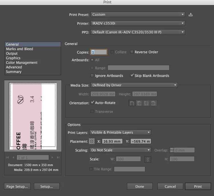

I have this issue multiple times. I try to print the artwork but it has this imaginary white border below my artwork and just cuts off everything else. I've tried rotating but the white border follows the rotation. Also tried restarting the programme but it doesn't work.

The document is listed as 1500 x 350 mm; the media is 420 x 297 mm. With Do Not Scale turned on, it's never going to fit. What are you trying to achieve?

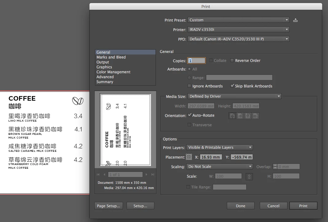

I understand it will not fit. I think it's easier to see in this screenshot as the image has been cut off by an invisible border.

Why is the Y value of the Placement set to -569.74 mm?
Did you check your Print Tiling tool (Hidden under the Hand tool)?
