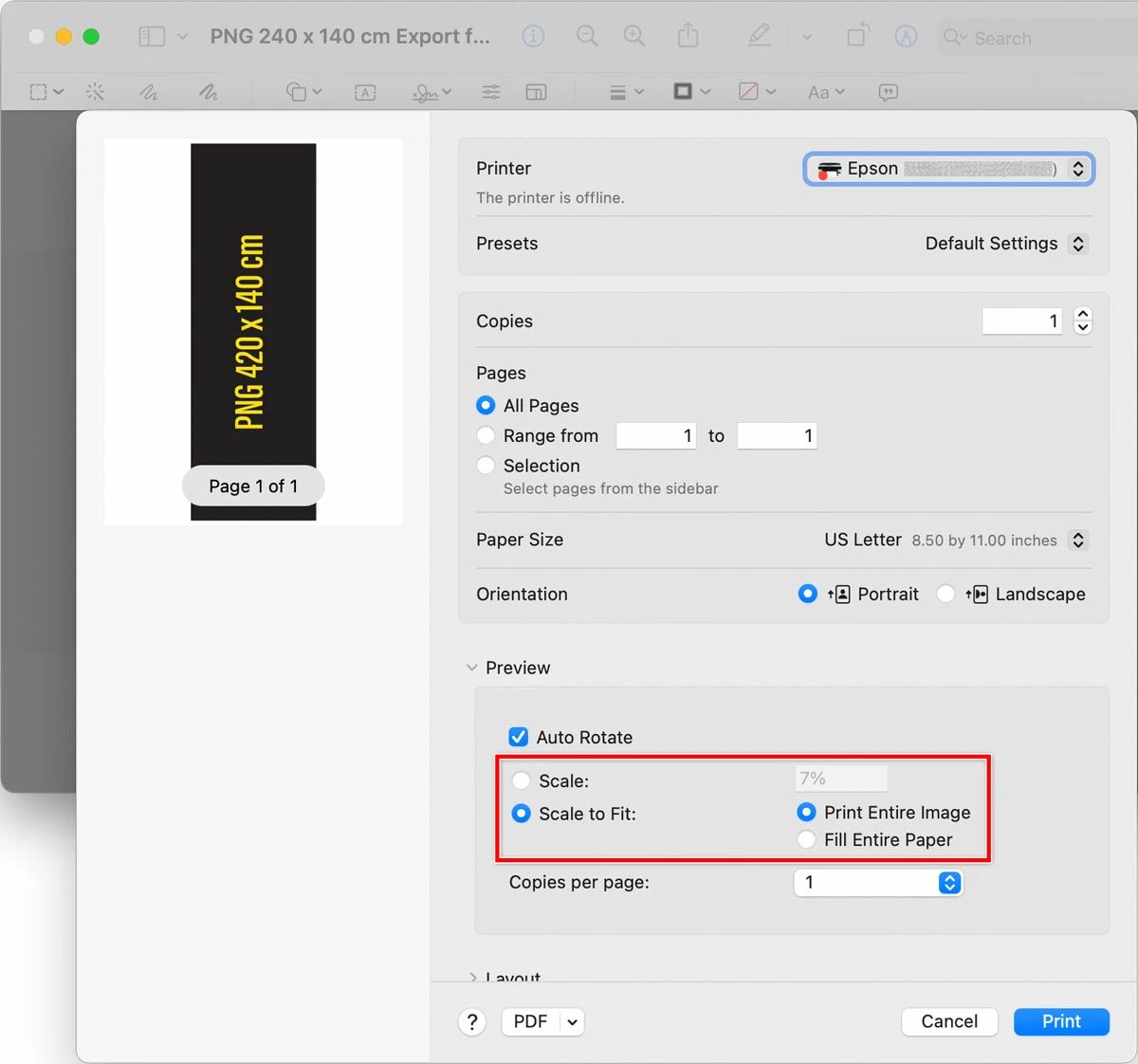

The problem might be related to printing them from Apple Preview, which is a basic application. It is better to print from a professional application such as Photoshop, for the reasons below.
When I open an image in Preview and choose File > Print, it allows Scale (by percentage) and Scale to Fit (where the print size depends on the printable area of the selected paper size). But nowhere does it tell you how large the document will actually print, in cm. It just wants to scale it to the paper size, or scale by percentage. But not by cm, so you are not sure what size you will actually get.

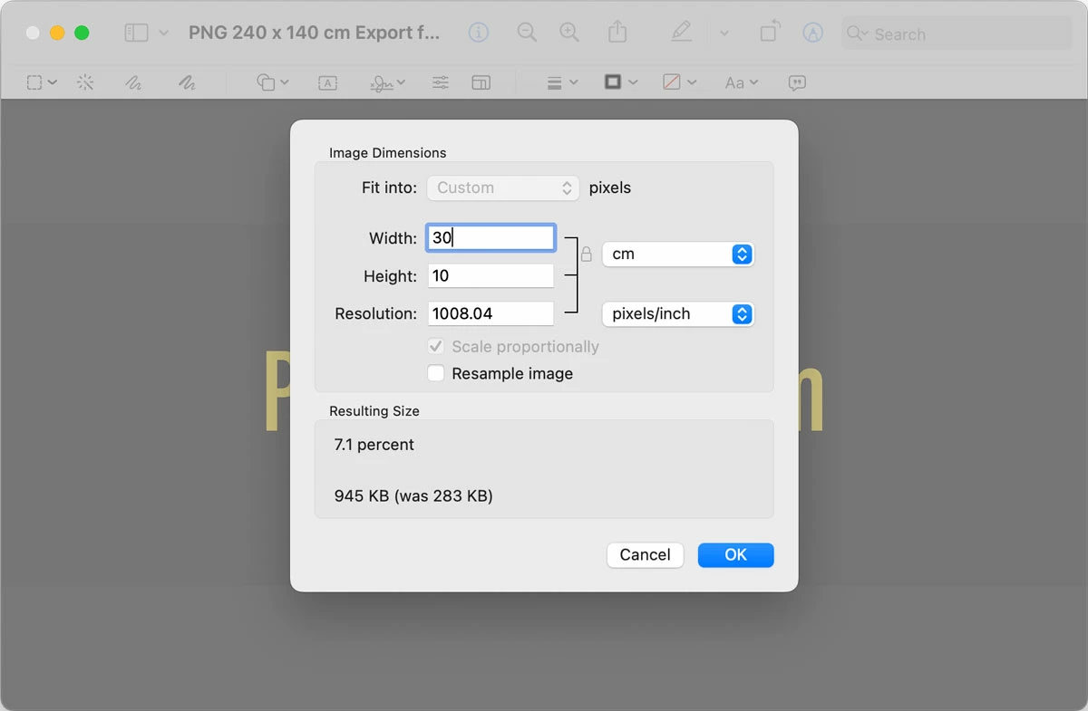

If you want to print from Preview at an exact size, before printing, it might work better to first choose Tools > Adjust Size. Set the Width to 30 cm, the other dimension should be adjusted proportionally, click OK, and then print that, and if the paper is large enough, see if the print comes out at the correct size.
“If the paper is large enough” is important here, because if you ask for a print 30 cm long, the very common A4 paper size is only 29.7cm long so it is not large enough to give you the print size you want. Hopefully you are using a printer that can take paper sizes large enough to reproduce any of the three print sizes you want.
