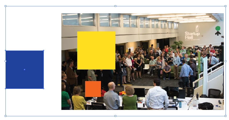

Illustrator randomly selects unrelated objects
About once  a day, when I click on an object with the direct selection tool, the bounding box will be way larger than it should, implying another object on another artboard is included in the selection.
This happens when the object I am selecting is NOT grouped with anything else. Moreover, is seems buggy because the mystery object doesnt have its "edges" visible the way it would if it were legitimately selected.
I can deselect all, but then anything I click on, the selection's bounding box is expanded to include the mystery object. The only way I have found to deal with it is to drag a corner of the bounding box, then undo, and then click off again. Then Voila! I am able to select my object (or any other) without the mystery selection happening.
I use clipping masks a lot, as well as many artboards, and have wondered if it's related to this, as the mystery objects are sometimes masked images, and often on another artboard. However, the mystery objects are not always masked.
Anyone else having this weird problem??
I had it with CS5, and hoped it would go away with CS6, but it has not.

I have also just had this issue in what appears now to be an 8-year-old issue.
(I'm no Illustrator expert btw).
I solved it... through luck.
In my case, the box was linked (somehow) to a 2-letter text box which I had moved to another layer and then hidden. Somehow this 'shadow' from the text box was left behind. I didn't see a clipping mask in the layers box. When I selected it (or more normally I selected 'off' a different object) this item was left behind.
My suggestion is therefore:
Select EVERYTHING - make everything visible and unlocked.
You may, like me, see that this phantom box is linked to a 'known' object.
Which I simply deleted.
It has worked (for now!?).

Playing around with my objects I discovered that if one of the objects has a drop-shadow, when selecting this object the bounding box is much larger. If I remove the drop-shadow the bounding box behaves as expected.

Same issue, been having it for years. I can get it to reliably happen by:
  1. Creating a clipping mask around a linked or embedded image.
  2. Dragging a selection that includes the clipping mask
  3. Shift-dragging to unselect some items that includes the clipping mask.
If the clipping mask is not deselected by shift-clicking on it directly then the embedded/linked item will remain 'ghost selected'. Shift-clicking on the embedded image won't deselect it, I have to click and drag the bounding box handles to resize the image, then cmd+z to undo it, which deselects it.
