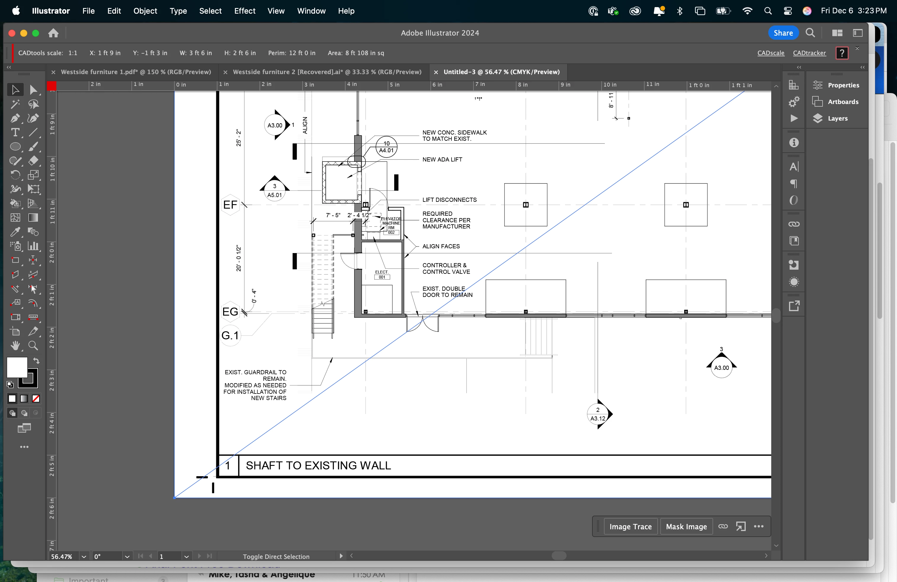

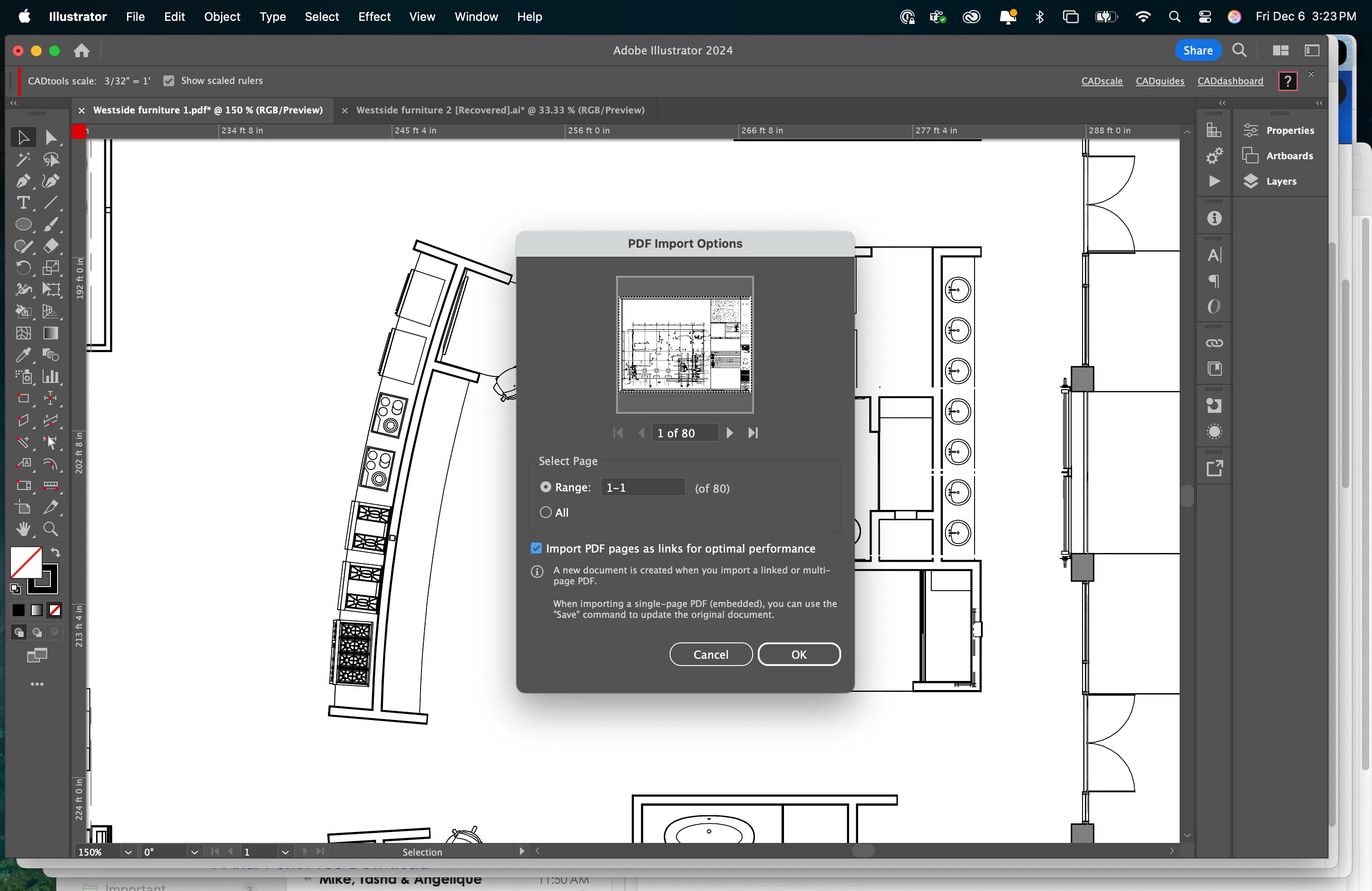

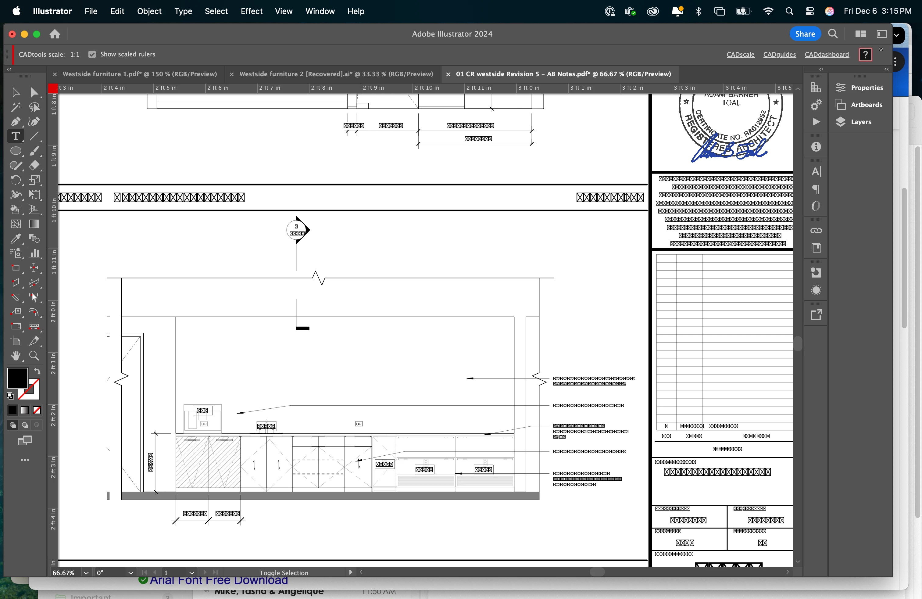

I could really use some help.  Any time that I open .pdf floor plans in Illustrator it replaces my font with boxed xyz's.  I am stumped.  The fonts in the document are Arial and Arial Bold, which are downloaded and accessible in Illustrator.  I can use them both if I am adding new text.  I have Googled this issue over and over and come up with nothing.  I have tried highlighting all of the text and replacing it, and that doesn't work either.  I can "Import .pdf pages as links for optimal performance" and the fonts DO come through, but the document is completely locked and I cannot make any edits.

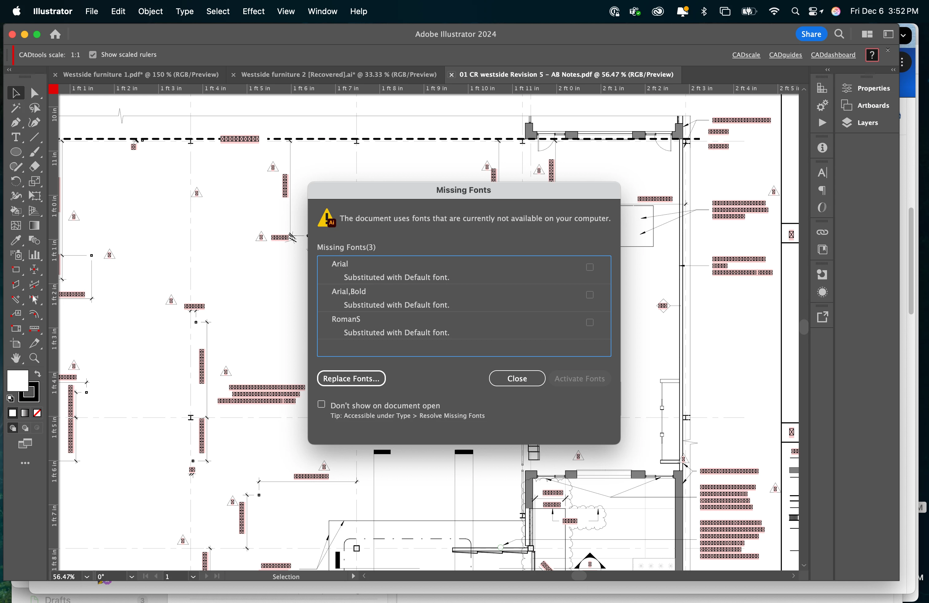

December 6, 2024
It hihghlights the missing fonts in pink.  The font is loaded on my compter but it says that Arial is not available.  I tried switching to any other standard font and it still doesn't pull any text in.  Just changes the Xyz's to boxes.

PDFs were never meant for editing and Illustrator is not a general purpose PDF editor.
All you can do it click on Replace fonts and then replace them.
