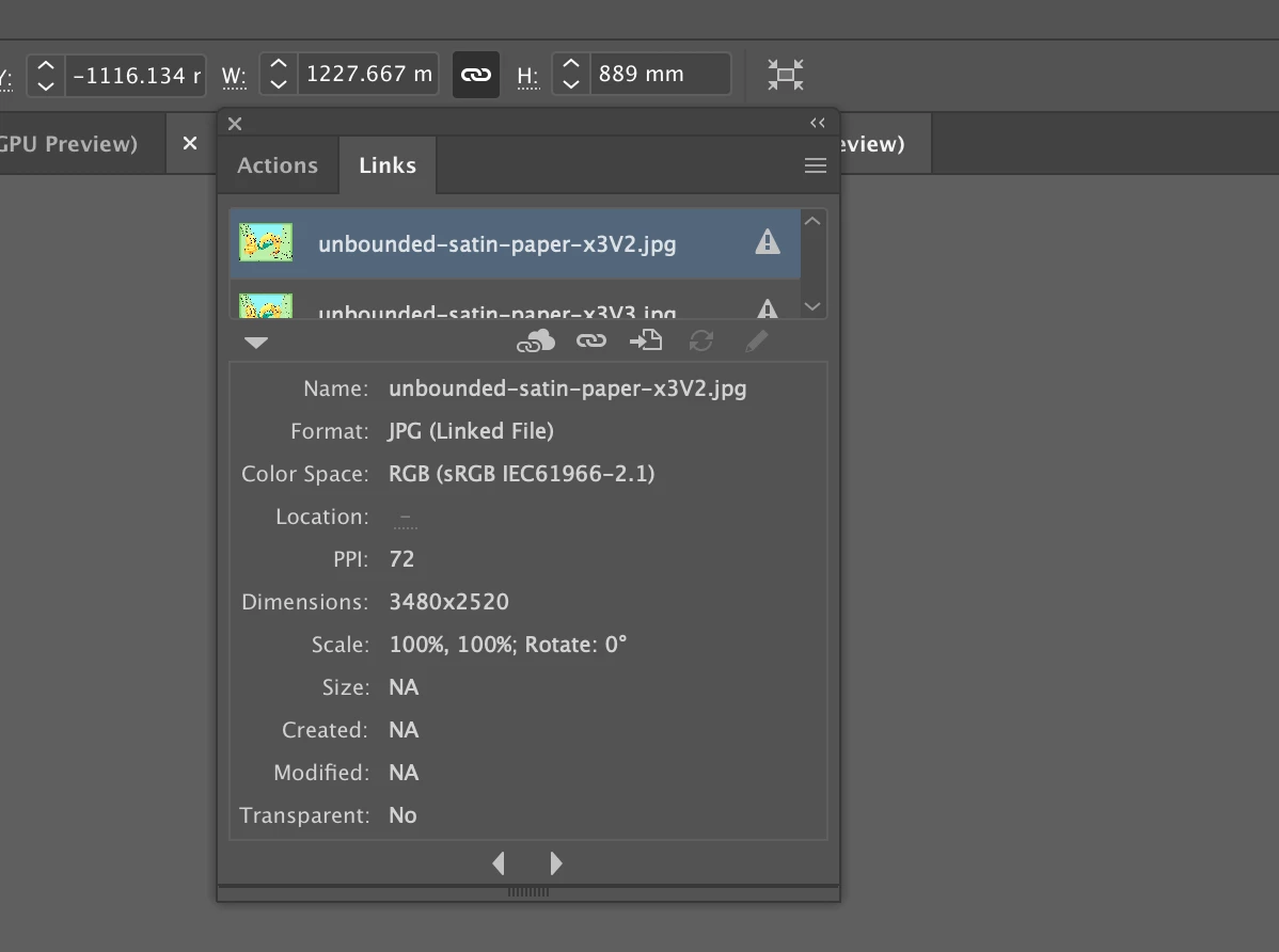

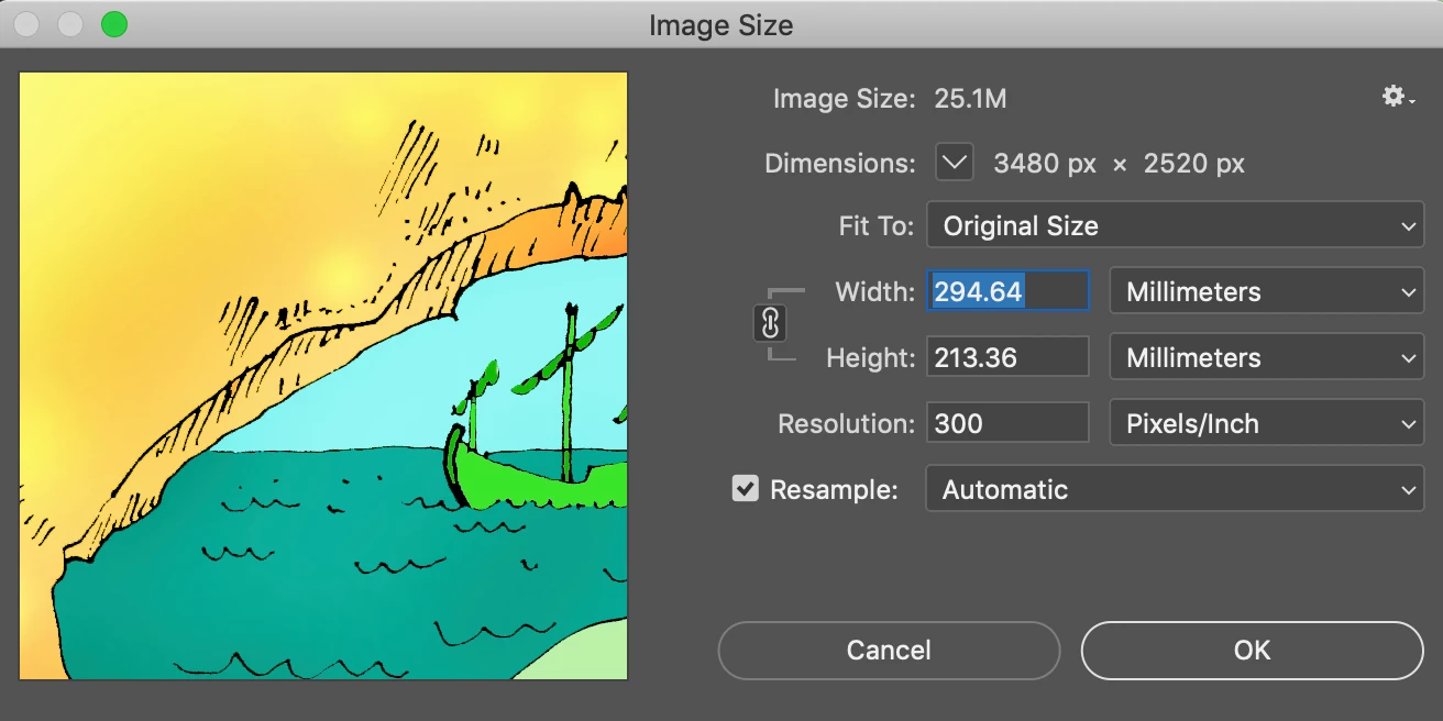

Upon his questioning we re opened the file in Illustrator and sure enough it was exactly the size we had printed, however... when we opened the same image within Photoshop its size was smaller and it had shrunk back down to the size of an A4, (It's intended size).
Please see image size information from photoshop and then Illustrator below;
Now I am capable enough to realise that illustrator has imported the image at 72dpi thus affectively increasing the size of the image by 4x what I am confused about is why? I have been playing around with the file trying to decipher why Illustrator has done this and am at a loss for the answer.
I have tried to recreate the effect without success. Every time that I create an A4 document at 300dpi in Photoshop and save as a JPEG, upon opening in Illustrator it is still sized as A4 at 300dpi as I would expect... so why is this clients image different?

Exporting for web as a JPEG and then opening the file does resample it to 72ppi and subsequently increase the size.
However, when you re open this JPEG in photoshop it is also 72ppi and larger than the original.
The file we were working in was opening larger in illustrator and its original size in photoshop which is what I am trying to understand.

Can you please show what you mean with larger?
