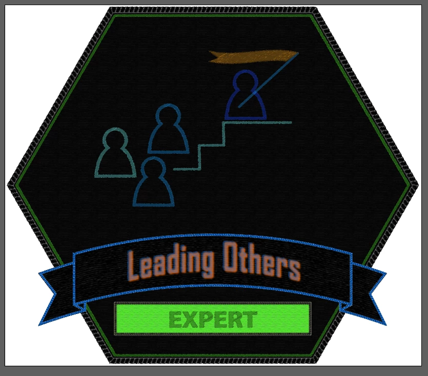

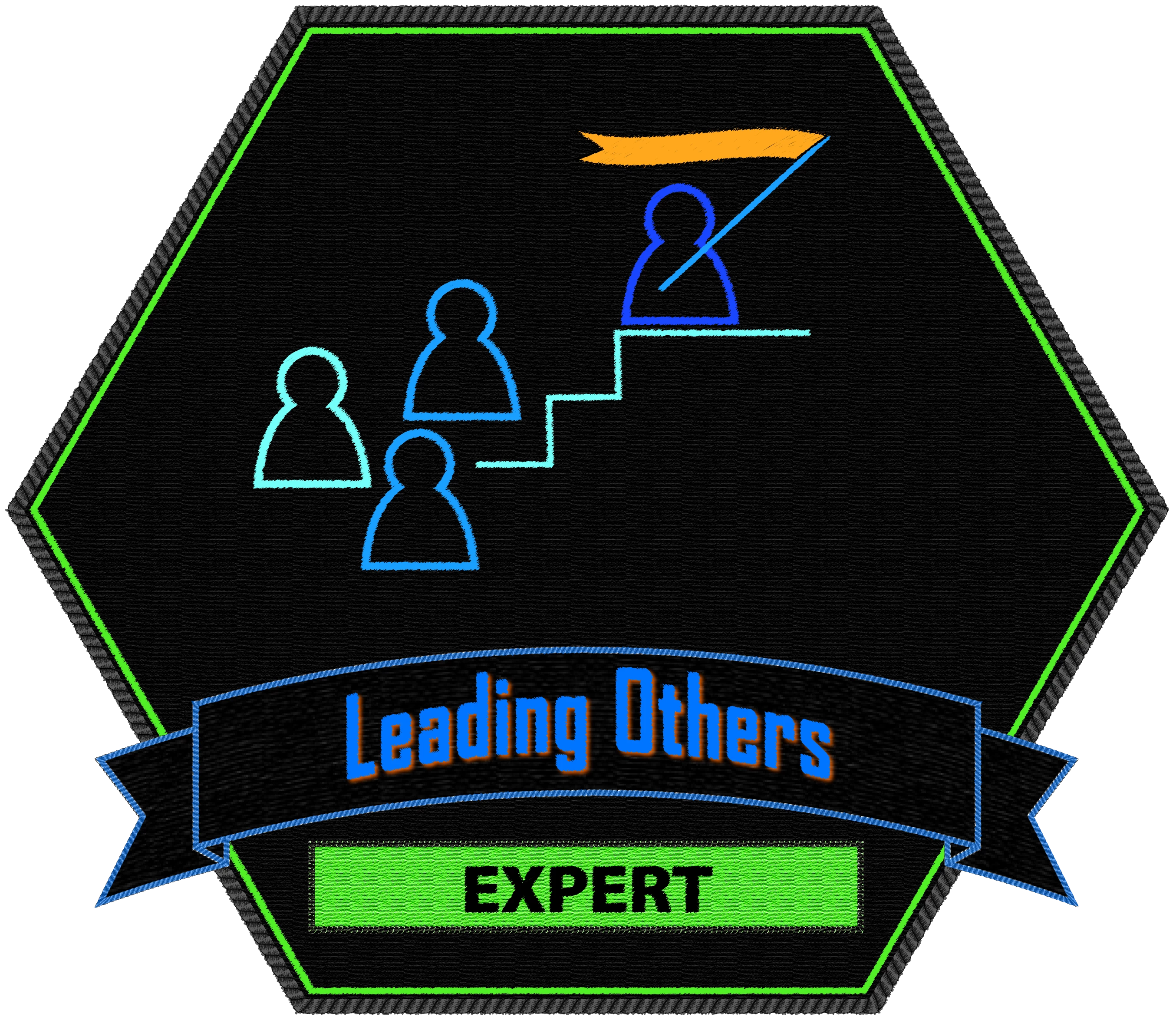

I am working on a project that uses the Scribble effect.  Yesterday everything looked perfect in the preview window.  I shut down the computer for the night last night, and when I got back into my project this morning, all strokes, text, and shapes using the scribble effect seem to be displaying at a reduced opacity (though all opacity is set to 100% in the graphic styles I'm using).  The background color seems to be pushing through and making the objects with the scribble effect applied appear dull.  When I zoom in to 300% or greater it all looks fine and it all exports fine.  It just doesn't preview correctly at anything under 300% zoom. Has anyone else experienced this?  Any thoguhts on how to fix it?
Illustrator v29.1 (updated 11 days ago 11/21/2024)
OS - Windows 10 64 Bit
Graphics CArd - Nvidia GeForce 3070
RAM - 128GB
Processor - AMD Ryzen 9 5900x 12-Core 3.7GHz

Wierd!  If I turn off the GPU all the colors are back to normal!  So that kind of works.  Is there some reason I can't use GPU performance?
And Thank you for ths simple fix.
