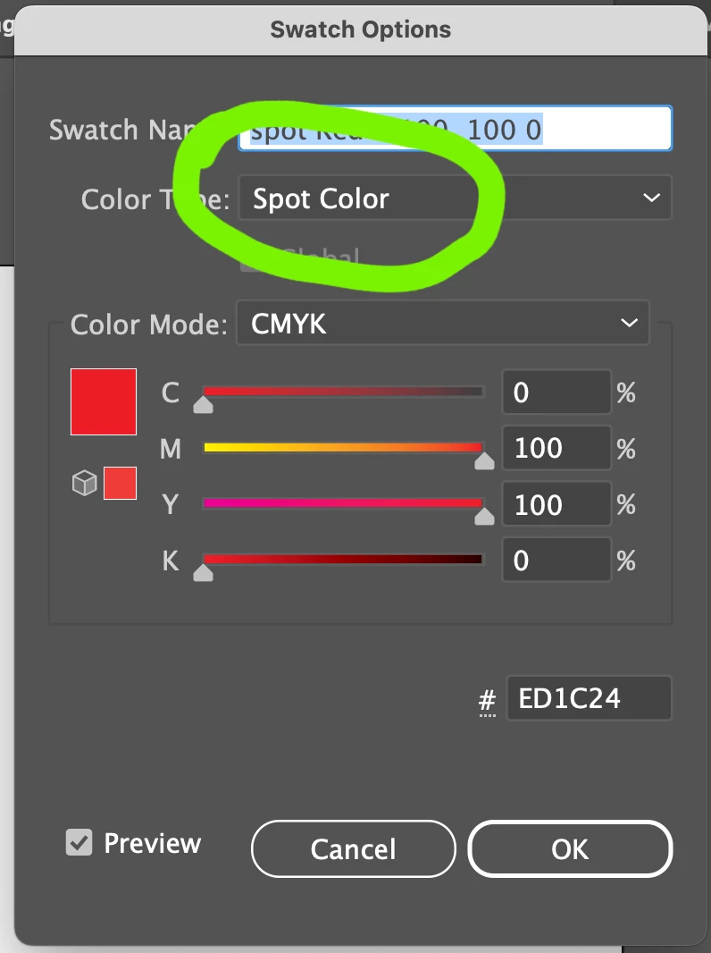

@Js1212Author
Sep 12, 2023 12:44 PM UTC
in the swatch panel i need the color type to change from Spot Color  to Process color. It will have the global color unchecked and that is how it shoud remain.
the name of the color in the swatches panel should change (if possible but not mandatory) to reflect that it is a process color by appending the existing color name with something like "_PROCESS" or "_CMYK"

@Js1212Author
Sep 11, 2023 7:55 PM UTC
Also, i want to keep the color names but maybe tag the color _PROCESS  (231_PROCESS)
