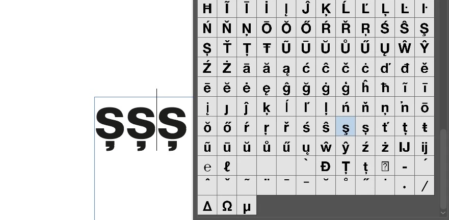

I'm editing a Turkish text and need to add an ş [s cedilla - Unicode 015f] to the text. Text is set in Helvetica Neue LT Pro 75 Bold.
When I click the Glyphs panel to add the character ş, instead of adding the correct character Illustrator adds an ș [s comma - Unicode 219]. I tried in a different font (Myriad Pro) and that seems to work as expected, but since there is no [s comma] available in that font I'm not sure if it could go wrong the way it does with Helvetica.

thanks for the feedback. I've tried copying from Word but the character is changed to the wrong accent letter as soon as I paste the text into Illustrator.
On top of that: when I look in the Glyphs panel, the character is present in the glyphs overview. But for some reason Illustrator picks another accent letter instead of the one I double click. Screenshot in attachment 🙂
