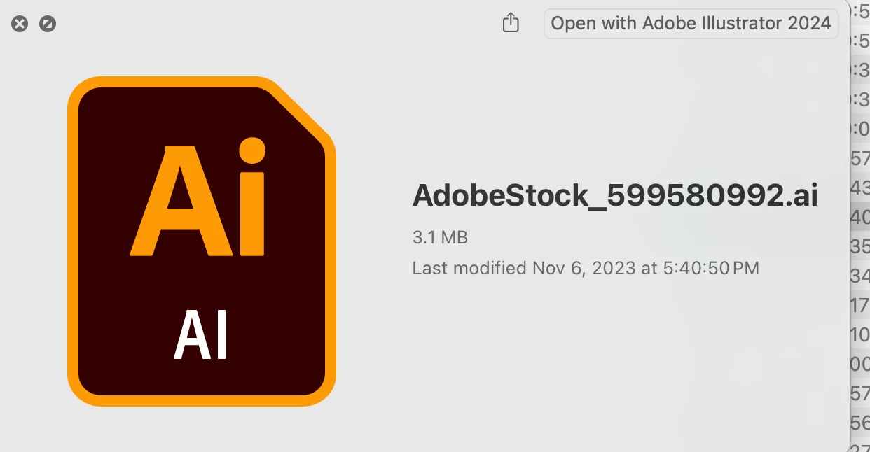

Illustrator Thumbnail Preview Not Showing Images Sonoma 2023
I download vector images from Adobe stock photos they have the .ai extension and up until recently I was able to select the file and hit the space bar to see what the image is.  Now I have no previews to look at. And this has been asked in other streams but this situation is different because I don't want to open every illustrator file to find out what it is or to save as pdf compatible.  This is very time consuming. These are stock images from Adobe stock.  I also don't want to have to open Bridge to see what the images are. I want it to be a quick simple thing like it has been forever. Any suggestions? I found the instructions to change the Illustrator.qlgenerator file and did so but it's not solving the situation.

Try viewing with Adobe Bridge. I don't use Sonoma, so I can't test it, but Bridge can generate a preview for .ai files without PDF compatibility.

But if you read the comments above, you will see that you need to complain to Apple who took that functionality away.
The only solution is to save your Illustrator files with PDF compatibility for your clients that do not have any Adobe applications.

Das Preview auf MacOS wird aus dem eingebetteten PDF in der AI-Datei generiert.
Ist kein PDF eingebettet, dann gibt es kein Preview.
Die Anwender*innen (nicht Adobe) müssen also die Dateien öffnen und PDF-kompatibel abspeichern (also die gleichnamige Option ankreuzen im Illustrator-Optionen-Dialog).

They need to be saved with PDF compatibility.

Save them "PDF compatible". MacOS uses that embedded PDF.
If a file doesn't have an embedded PDF you could never see what's inside in Mac OS (I've been using Mac OS for 30 years)

Hi, Thank you for taking the time to respond, I purposely started my own question becasue this is the answer on the other ones.  My question is what has changed that makes previously viewed by hitting the space bar files not being able to do so and how do I fix it?  I have been downloading these files from Adobe stock for years and now they aren't working. I don't have time to go through each one and resave and I have not had to in the past.  So something has changed. I don't know if it's from updating to Sonoma or not.

Previously MacOS could preview EPS files by hitting the spacebar. Now this ability is gone and will probably never return.
