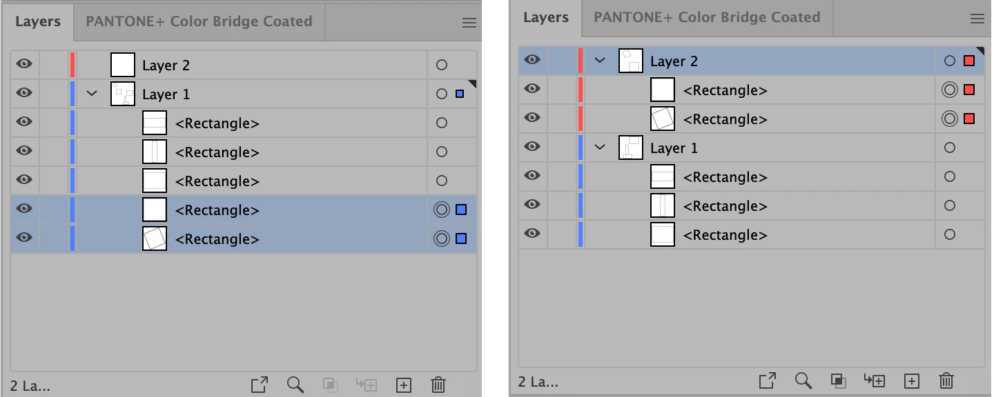

Are you sure that what you are seeing are 80 separate layers rather than one layer with 80 sublayers? In Illustrator every new object added on a layer becomes a sublayer. If this is the case for you then try selecting one of the five complex objects you mentioned. You'll note in the screen shot that the selected objects will have a solid square showing at the right of the sublayer. If you choose all of the layers with a solid square next to them you can then drag them all to a new layer that you've created in the layers panel by clicking on the square with a + sign in it from the bottom right of the panel. By repeating this for all of your complex objects you can wind up with five layers each containing only the appropriate sublayers.
