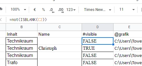

March 3, 2023
Add an extra column in your spreadsheet and name it "#visible" (the "#" is important as it later defines if it's visible or not). Below you add the funktion "=not(ISBLANK(C2))" so when C2 is blank you get a FALSE and if it's not blank you get a TRUE.
In Illustrator you make the desired object "make text dynamic" and also "make visibility dynamic". Then you replace the reference name "Variable1" next to the eye-symbol with "visible" as that's the actual name of your added column "#visible". You may need to reload the csv-file.

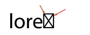

May 6, 2022
This was a good idea, but I tried it for mine and it doesn't work. I get a character that looks like a box with an X thru it.
Anshul_Saini
May 6, 2022
Hi @default4idfpndkfegd,
We are sorry to hear about the trouble. If you are getting a character like shown in the following screenshot, then I would like to inform you that it is a known issue while copy-pasting, and we are currently investigating it.
You may upvote this UserVoice (https://illustrator.uservoice.com/forums/601447-illustrator-desktop-bugs/suggestions/43954350-why-does-the-envelope-sign-appear-at-the-end-of-co) and add your comment there.
By doing this, you will get an update when it is fixed.
