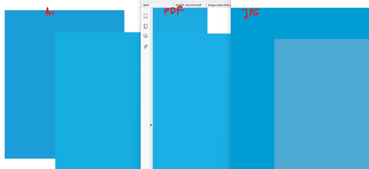

Jun 27, 2024 9:15 AM UTC
Thank you for answer, that clarifies usage of Pantone colors.
However, If we consider now situation without using pantone colors and using only CMYK swatches I still have problem with representation of CMYK.
In working space colors are different than on JPG or PDF.
PDF is brighter while JPG darker and more greyish.
What may be the problem?

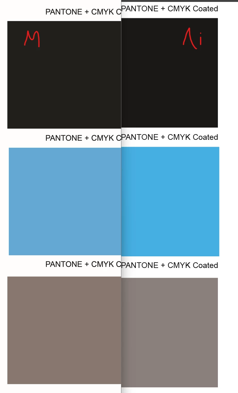

Why there is no way to edit the post?
Anyway, answering to my last question.  Even changing to Pantone CMYK Coated, export is still different to what is in working space. Here is picture. M stands for monitor, Ai for Illustrator working space.
