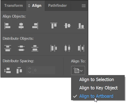

barbara_a7746676
October 6, 2020
To center an object on the artboard, select the object and in the Align panel choose Align to Artboard.
Then click the Align Verical icon and then the Align Horizontal icon.
