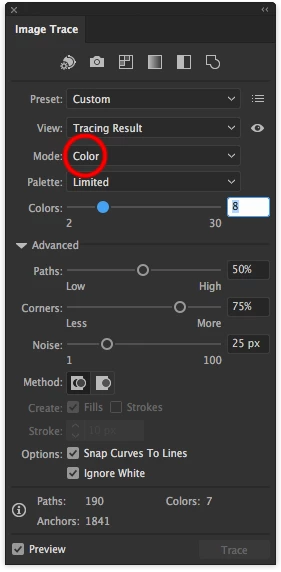

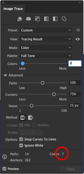

For me with grayscale was acting strange could never get 7 at the bottom, You may get llimited palette to work better in color mode.
Mike_Gondek10189183
March 1, 2018
Yes that is strange, try these settings and tweak # of color     s to get the number here to what you need.
