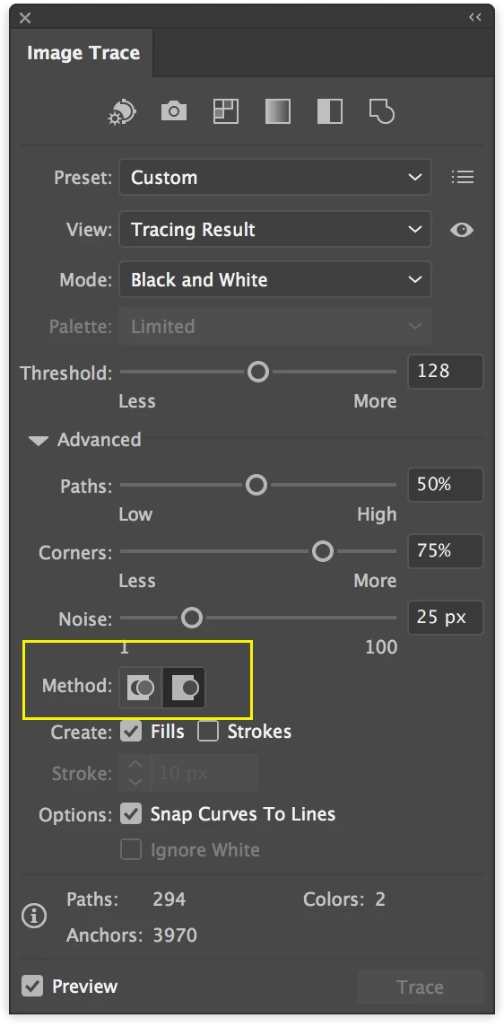

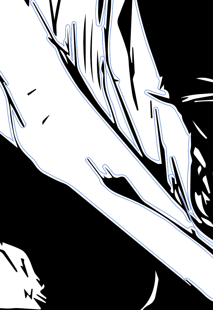

Image trace overlapping trace lines twice (Only just started doing this)
Hi there, I have not had any problems with using image trace before and have always found it very simple and easy to use. I just image trace to design t-shirts and create vector lines for my laser engraver/cutter to read. Only in the last week or so it has started tracing round my image twice, so when I convert it for t shirts, my vinyl cutter cuts round twice or my laser burns round twice making a big mess. The only way round this new problem I have found is to delete the first trace line manually but this can take a long time depending on the design. At the end of the day, this should not be happening as it was working fine before. Is anyone else having this issue. Is it a bug? Adobe needs to sort this please as its slowing my business down.

    I second the motion to check your options. But I think you might have accidentally turned on the “overlapping” instead of “abutting” option under Method.
    Here’s what it looks like in action:
    Hope that helps

    Thank you very much for all your help. I have now figured out how to do what I need. It seems as though this happened when my adobe cloud updated Illustrator from 6 to 7. As you said they was a bug on 6 and perhaps this bud was working in my favour at the time. I started using CS6 as my first Illustrator so never know any different.
    Thanks again

    Check your options. Did you maybe forget to check "Ignore White"?
    Also: Which version? There is a bug in CS6 that just fills paths with "None" the paths when you "Ignore white" instead of deleting them.
