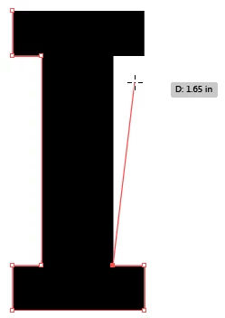

    ab90341972  wrote
    Is tracing with the pen tool the only option to get it right?
    To an extent, it depends on what you mean by "right." If you mean geometrically precise, with the fewest anchor points possible, then yes, auto-trace won't do.
    Sometimes, auto-tracing can provide an acceptable result or something close enough, and perhaps the result can subsequently be adjusted and/or cleaned up. But for something like this, manual tracing is always superior because you exercise first-hand control every anchor point and segment.

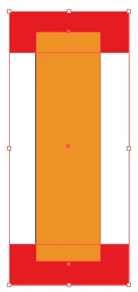

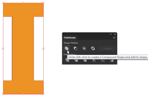

    But, having reread your question, I will say that limiting your tracing efforts to setting point-by-point using the Pen tool isn't always the best method. Of course there are many construction methods which can be used in combination. To oversimplify for example's sake; wouldn't it be silly to trace this capital I by setting 12 anchor points with the Pen...
    ...when you could so easily use a few easy-to-draw rectangles...?
