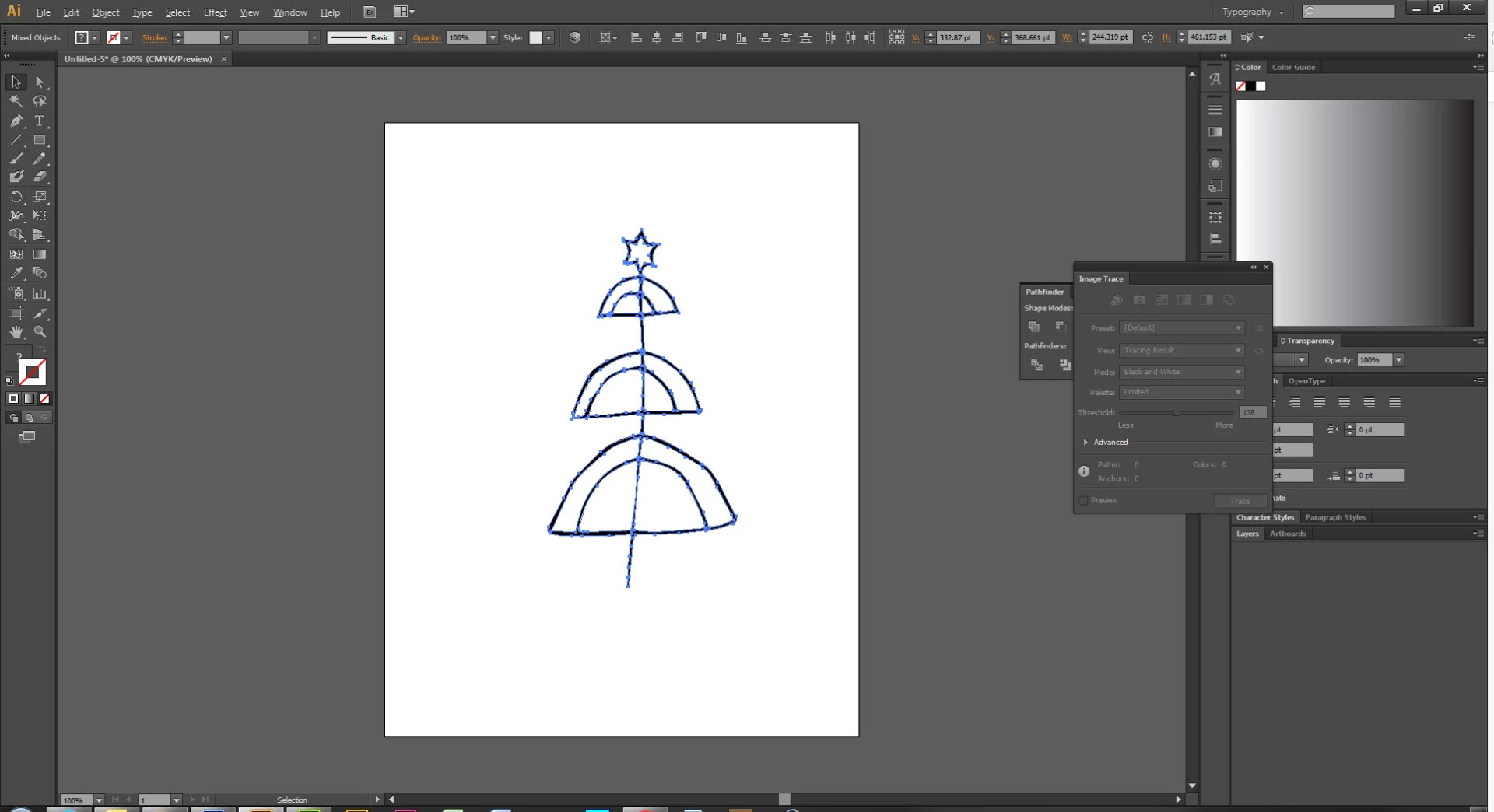

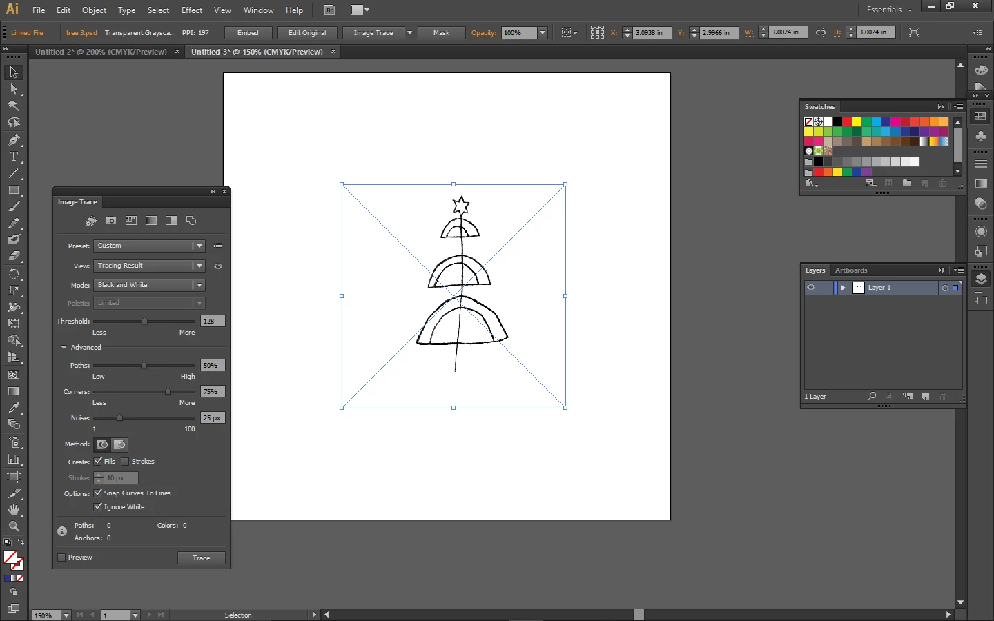

I am fairly new to Illustrator and am trying to image trace. I have a simple black line drawing that I have saved a psd file in photoshop in greyscale and place it into Illustrator.
Then I open up the image trace panel - select ignore white, trace and then expand.

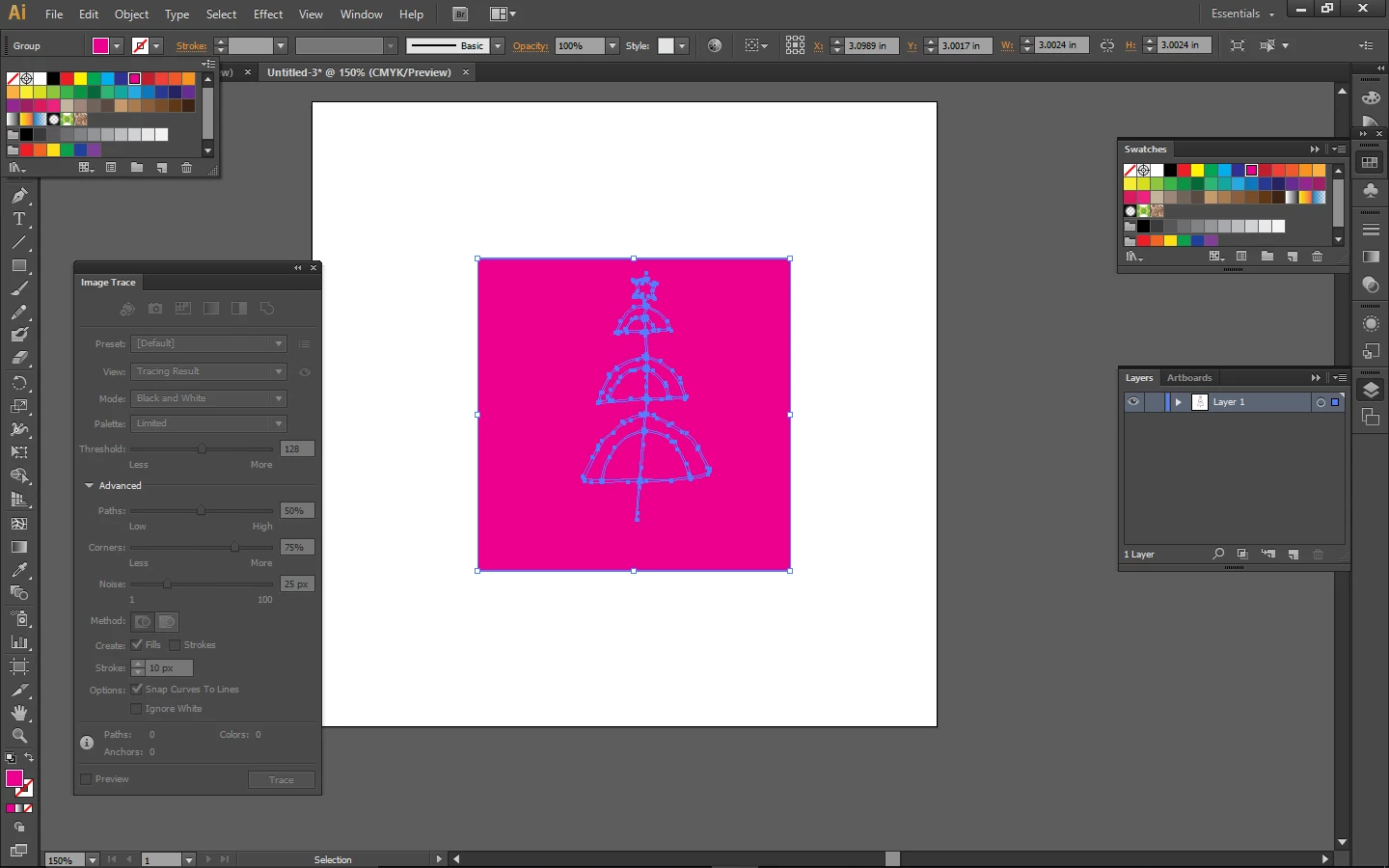

The line drawing is expanded just as expected by I have an additional square path which seems to trace the outline of the edge of the photoshop document.
I would like to be able to change the colour of the black line drawing but when I change the fill it fills the whole rectangle.
I have tried this side by side with my colleague who was doing the same thing on her mac and she isnt having this problem.After expanding, her traced artwork is neatly clipped around the object. Is there a setting I need to change? Any help would be greatly appreciated.
Denise

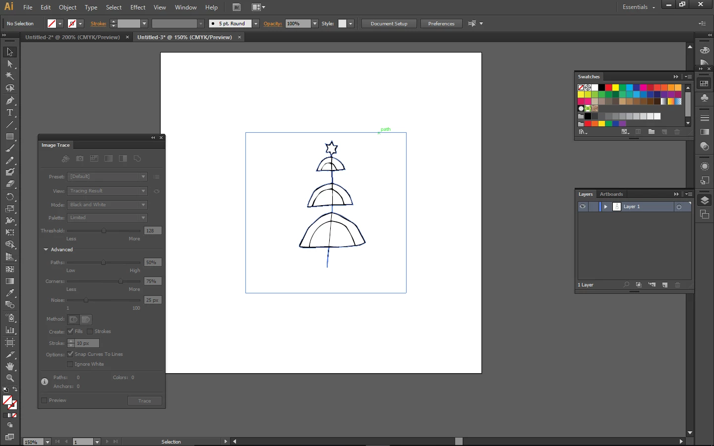

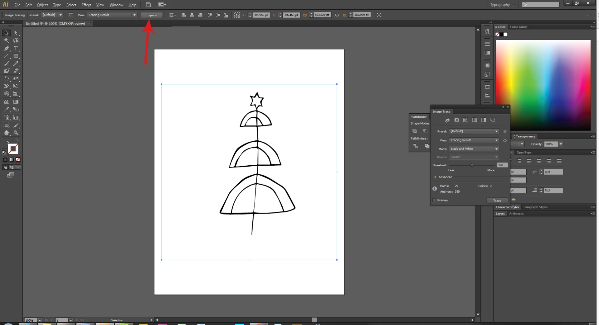

    After tracing the image you can select the expand which will convert the object into paths
    Then with your selection still active, ungroup ( ctrl+shift+G) and select and delete the pieces you do not want.

    Thanks Wildcat54 that works - Hurray!
