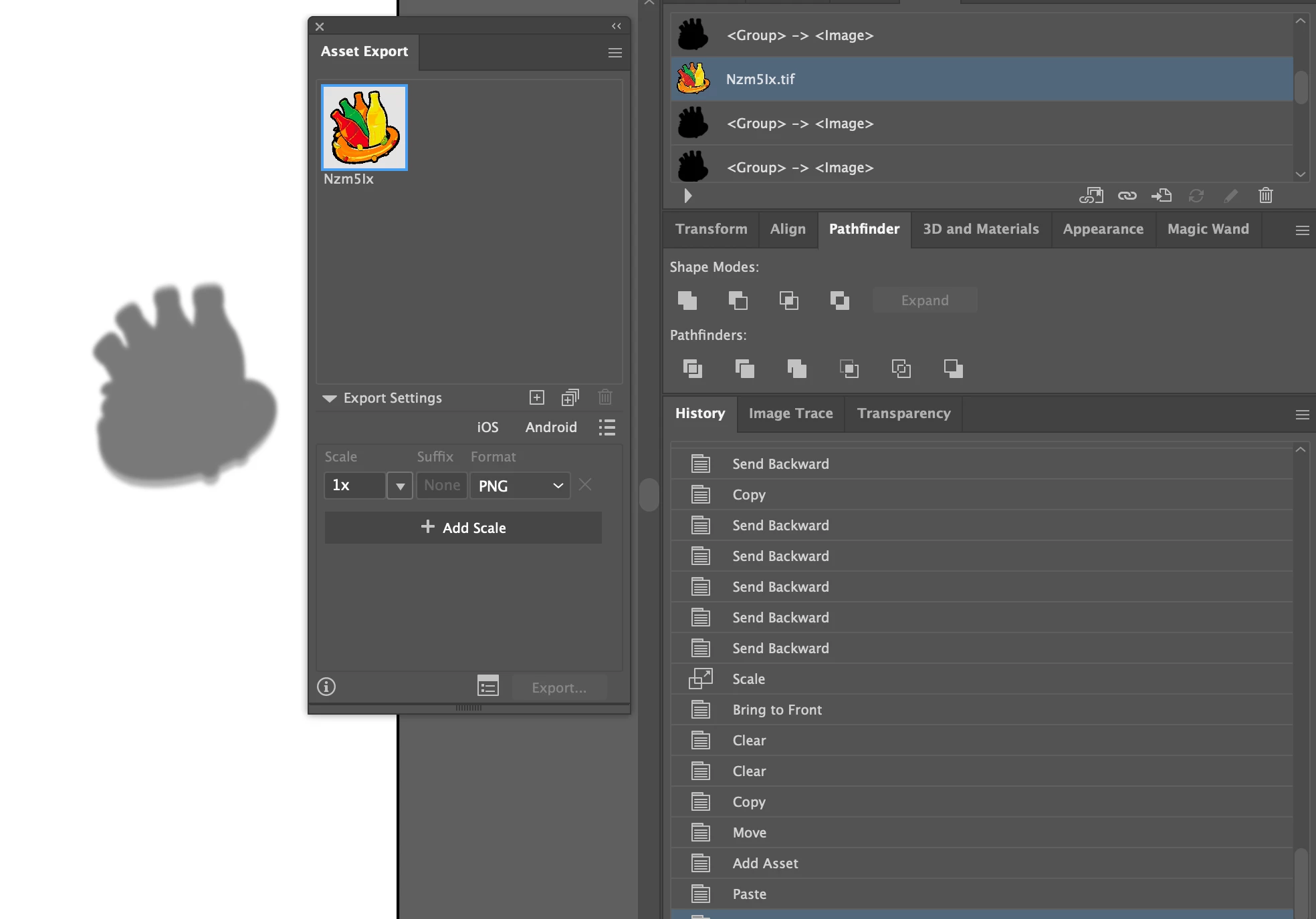

its been happening to me alot lately too. i drag and drop image add an outer glow effect for a shadow  then maybe hour later or next day working on file i move it or touch it with the cursor then it disappears.  it still shows in the links section (image added below) but no matter what it doesn’t come back. even trying to relink it doesn’t work because there is no red icon teling me i can.
WORKAROUND: i found if i do drag and drop a jpeg png or an other image to the vector file rasterizing  transparently fixes the situation somehow. its a quick fix but id definitely like to know why its been doing it lately to me in the past year, ive designed for years and its never happened to me until recently.
