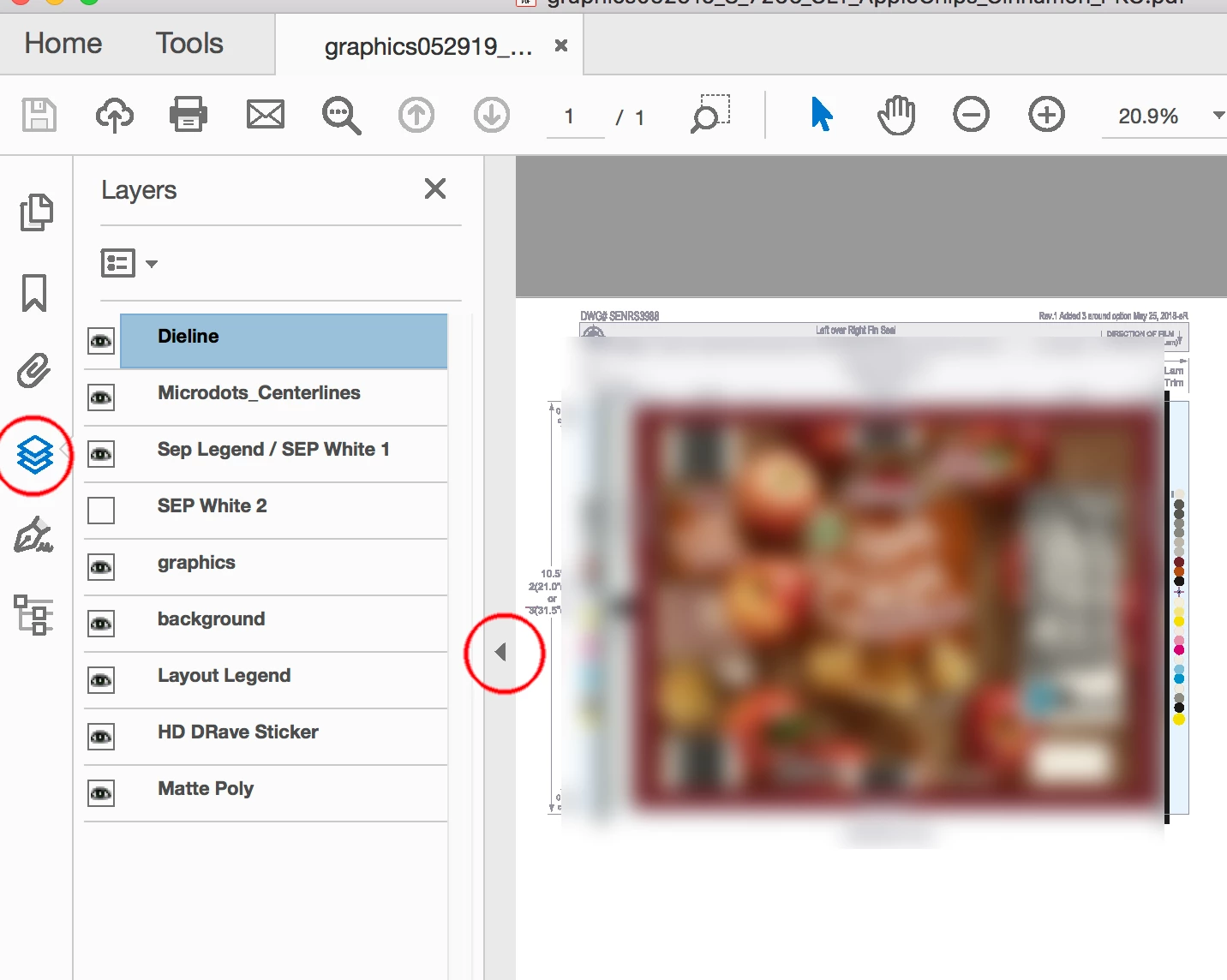

Importing files into Illustrator maintaining layer information
Hoping to get an answer to this, I've been asked to convert some normalised pdf files into Illustrator files but when I open the converted files all of the Layer information disappears. This information is integral to the files so we need to maintain this information into illustrator.
Is there a way to do this? (I've tried .ps .eps and pdf)
Thanks for any help
Ali
    19 replies
    Jul 23, 2019 8:04 AM UTC
    Thanks to all of the helpful messages and actions.
    I've now managed to create these files successfully by creating the files using a compatibility switch within the conversion software.
    Thanks to all

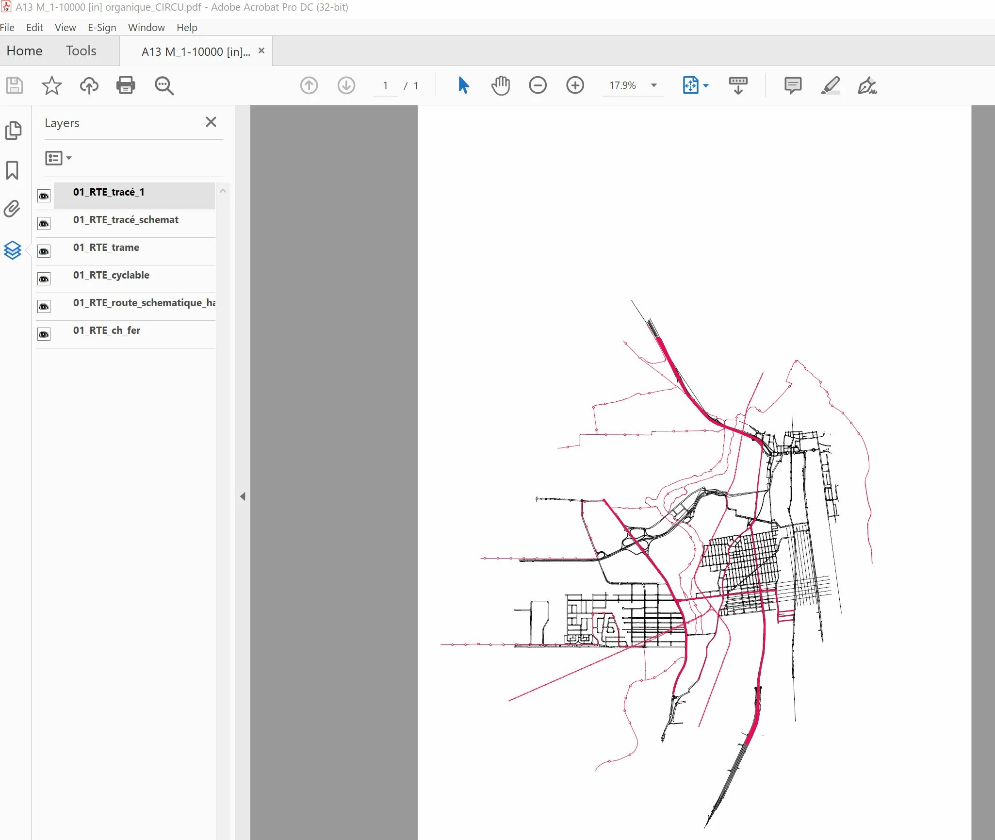

    Jan 14, 2022 1:04 AM UTC
    Hello there,
    Sorry to re-open this thread, but I'm facing the same issue.
    I exported (published) a PDF from Archicad, opened it in adobe acrobat and have acces to the layers structure.
    Although, When I import (place) this in Illustrator, the layer structure isn't maintained....
    I've seen many post but can't find the answer.
    Help would be greatly appreciated 🙂
    -Charles C.
