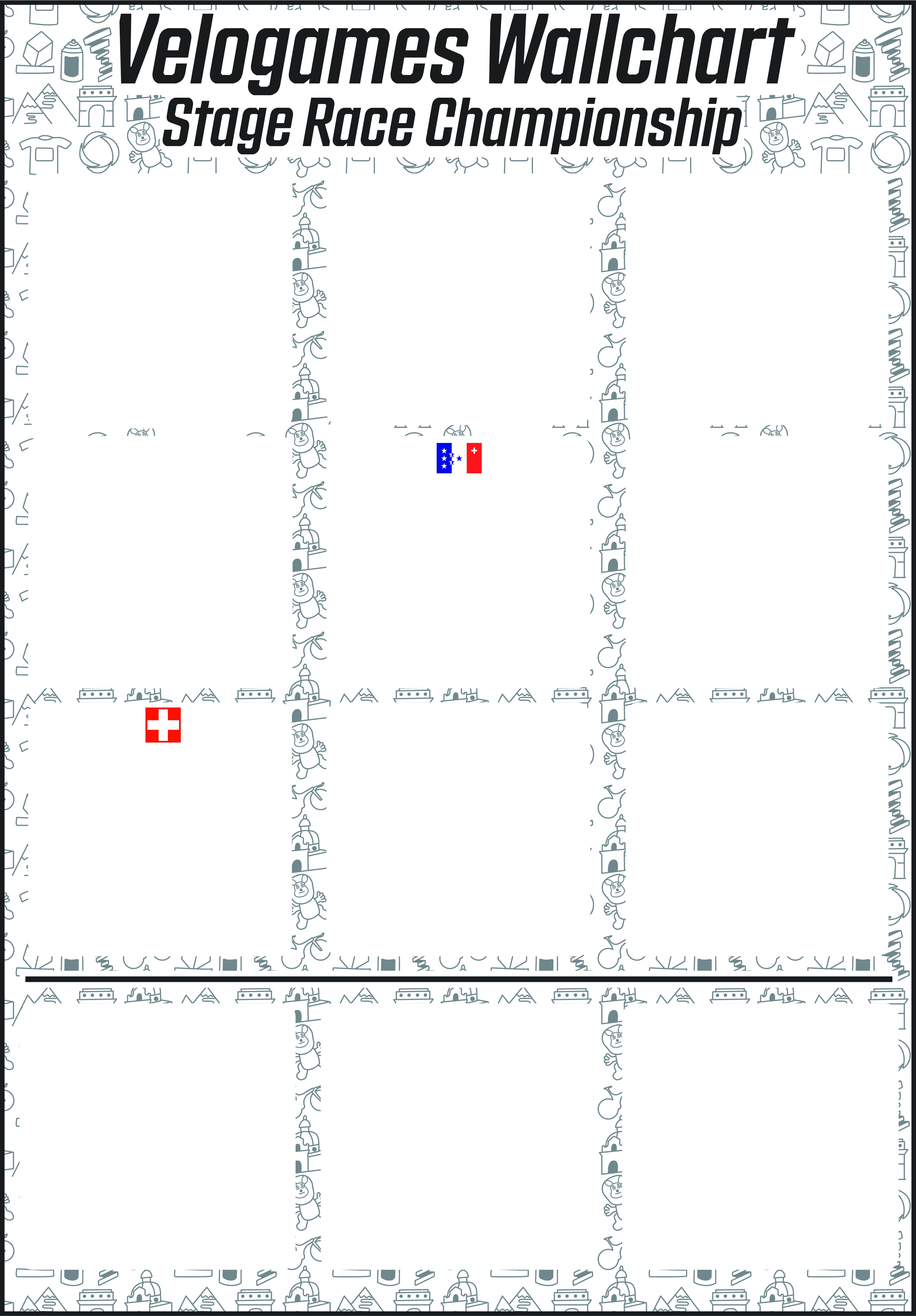

I'm quite new to Illustrator so forgive my ignorance.
I'm trying to upload a poster for printing but when I save the file as anything other than a png, the vectors disappear.
I've tried rasterizing these vectors but they end up becoming faded as if I've turned down the opacity (which I haven't btw).
Please can you make some suggestions as to things I should try. Thank you.

Hello @18274928,
Thanks for your patience. Would you mind copying all elements from this document to a new AI file and then exporting as a PDF to check if it helps?
Looking forward to hearing from you.
Anubhav
It worked! I've even uploaded it to the printer and it looks great.
You've made my day Anubhav, thank you so much 🙂

Yes, everything was made in Illustrator (excpect 2 flags). PDF seems the ideal format but I just need to find a way to preserve them when I save the file as a PDF because at the moment the vectors disappear.

Hello @18274928,

Hi Anubhav
Thank you for responding so quickly. I'm using Illustrator v 28.6. I'm creating a wallchart for a fantasy cycling game and I'm at the stage where I'm going to get it printed in bulk from a company called Solopress. They accept multiple file types (jpeg, pdf, EPS, TIFF) but whenever I export / save from Illustrator into one of these the vectors (colourful boxes) disappear. Strangely enough, saving as a PNG preserves them but this isn't a supported file type for printing.
I've tried rasterizing the vectors but they become faded when I do so. I've tried exporting each box as a jpeg and adding them back into the artwork but they're pixilated. A link to the Google drive is below.
