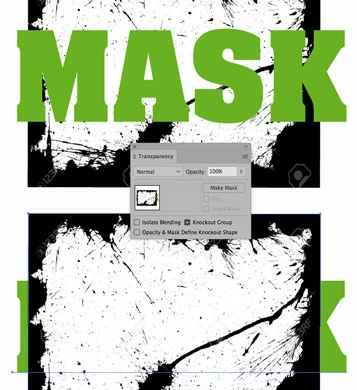

i use complex textures for clipping. i make it a .tiff and place it on the vector art from the opacity panel to make textures.
there is an entire course dedicated to this subject in Lynda.com:
Creating and Using Textures for Design

Like Mario suggested, use them as an Opacity mask.
But maybe you don't need to rasterize them to do that.
Mario Arizmendi
December 6, 2017
Rasterize your vectors in illustrator,  select both then use this as an opacity mask, see this simple example
