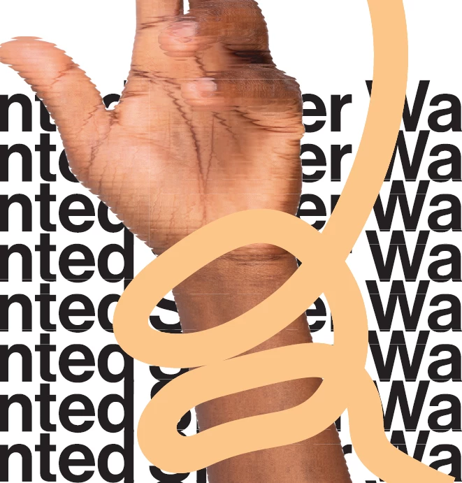

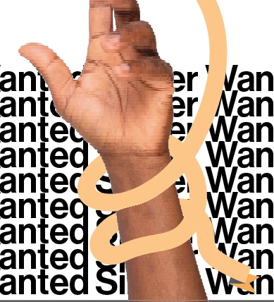

In Ai the ribbon is intertwined and when I do print preview it is fine. When I make it into a PDF, it does not acknowledge the layers and the ribbon is just sitting on top of the wrist.
Ai:
Acrobat:

    I got the hands from the adobe library, put a ribbed glass filter on it, then used the path to put a ribbon around the hands. I used intertwine for the wrapping. The text is in a pattern.
    When on Adobe Acrobat I have the most updated form.
