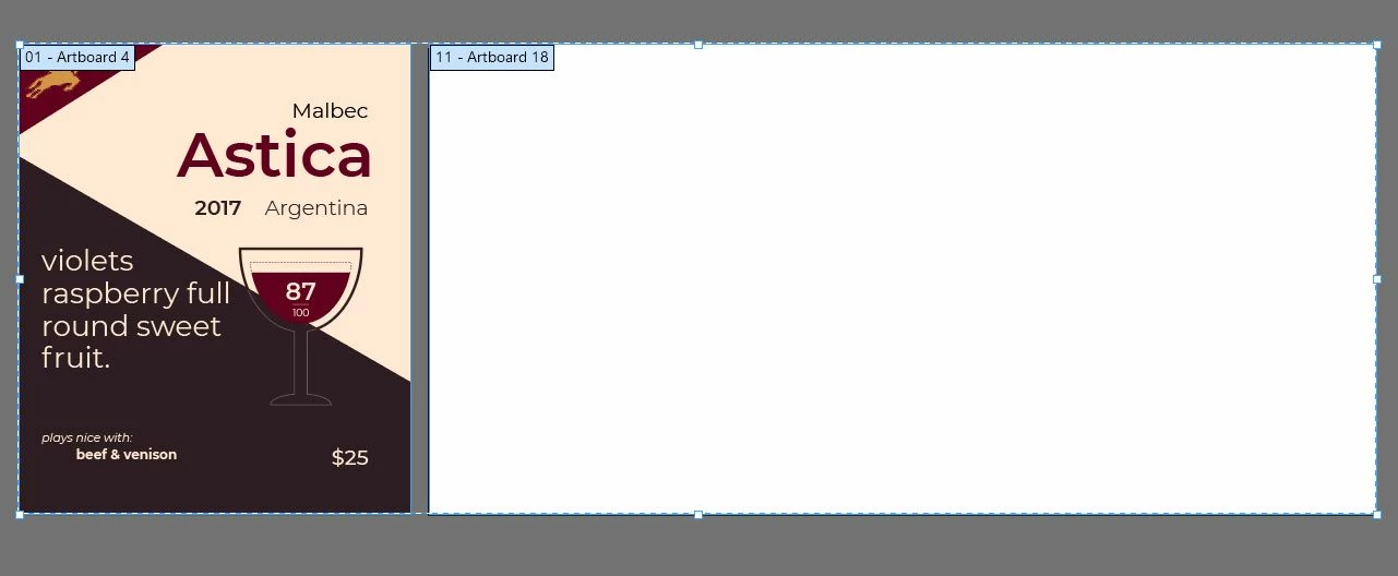

To make wine labels for a store,  I used the Variables function to automate switching out the text. However, there are still lots of minor tweaks to make to the labels, so I'd like to also automate the process of creating a new artboard in the document for each dataset. I've been at it for a few hours trying to script something for this, but I'm still pretty new to Javascript. Through stitching together some things I found online, I wrote this:

It creates 9 long artboards on top of one another to the right of the initial one-- I realize now this is due to the createArtboard() referencing the initial artboard when specifying the new position, but again, I'm unsure how to fix the position or size. I would attach the illustrator file, but it's coming up with a strange error that prevents it.

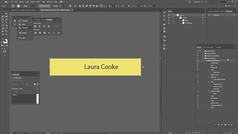

I created a sample test based on this use case and wonder if it would help you. Here is what it does: it uses actions and the batch process to copy some template artwork in the document and place it at a chosen distance from the last active artboard, then it creates a new artboard for the copied artwork. The copied artwork is going to be the live variable-bound art which will get populated with new text or images on the next dataset cycle.
Luckily the behavior of copy/pasting in Illustrator when it comes to variable-bound art does paste the item back in without the variable being bound, which is a good thing for this process.

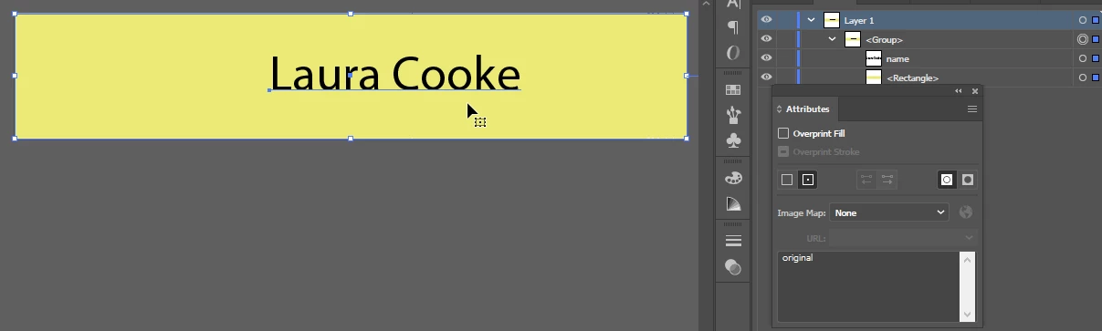

Here is the document setup: there is one layer with one group in it. This group has a textframe named "name" and a rectangle the size of the artboard in it. More in-depth the group actually has a special note in it inside of Attributes > notes that says "original". The yellowish rectangle also has a note in it that says "bg". These are used later by the action.

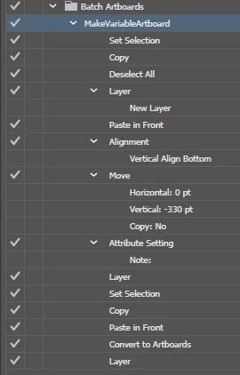

Here is the action:
  1. Set Selection - selects all objects whose note has "original".
  2. Copy - copies the selected group (the original group).
  3. Deselect All - deselects the original item selection so that the next paste can go into a new layer.
  4. Layer (New Layer) - makes a new layer which is now the active targeted (blue highlight) item in the Layers panel.
  5. Paste in Front - pastes the copied original group into the new layer.
  6. Alignment (Vertical Align Botton) - the pasted art is still selected and it gets aligned to the last active document artboard. Note: make sure to leave your alignment options on "Align to Artboard", not "Align to Selection".
  7. Move - moves the pasted art downward from where it was last aligned to an active artboard, which should be the last bottom-most artboard as this artboard collection expands downwards.
  8. Attribute Setting (Note:) - the pasted art is still selected, and now the action erases the word "original" from the selected group's notes. To remove all notes, simply delete the note text inside the Attributes > note section.
  9. Layer (Enter Isolation Mode) - there are many ways to go about this, but my easiest way was to enter isolation mode (recordable as a flyout menu item inside the layers panel) and duplicate a path in order to convert it to a new artboard. Entering isolation mode allows the rectangle with the note "bg" to exist in multiple places such as in the result state of the document, but the action can still use it only on a single group as intended.
  10. Set Selection - selects all objects whose note has "bg", which is the background rectangle the size of the artboard as part of the original art.
  11. Copy - copy the selected rectangle.
  12. Paste in Front - paste this rectangle in front of itself.
  13. Convert to Artboards - found in Object > Artboards > Convert to Artboards menu item, this option will turn any selected rectangle into a new artboard.
  14. Layer (Exist Isolation Mode) - now it's time to exit isolation and repeat the process with the turn of the next dataset.

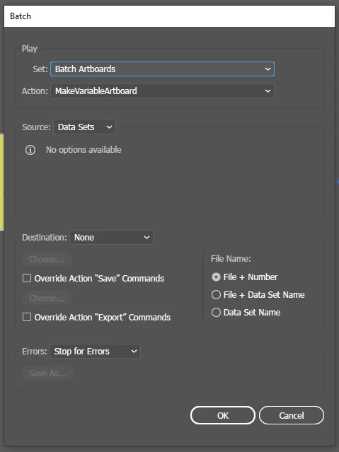

Remember, the batch action dialog can be set to a source of Data Sets and a Destination of None, which will export no files but allow you to run a series of custom actions on the same document for each dataset record.

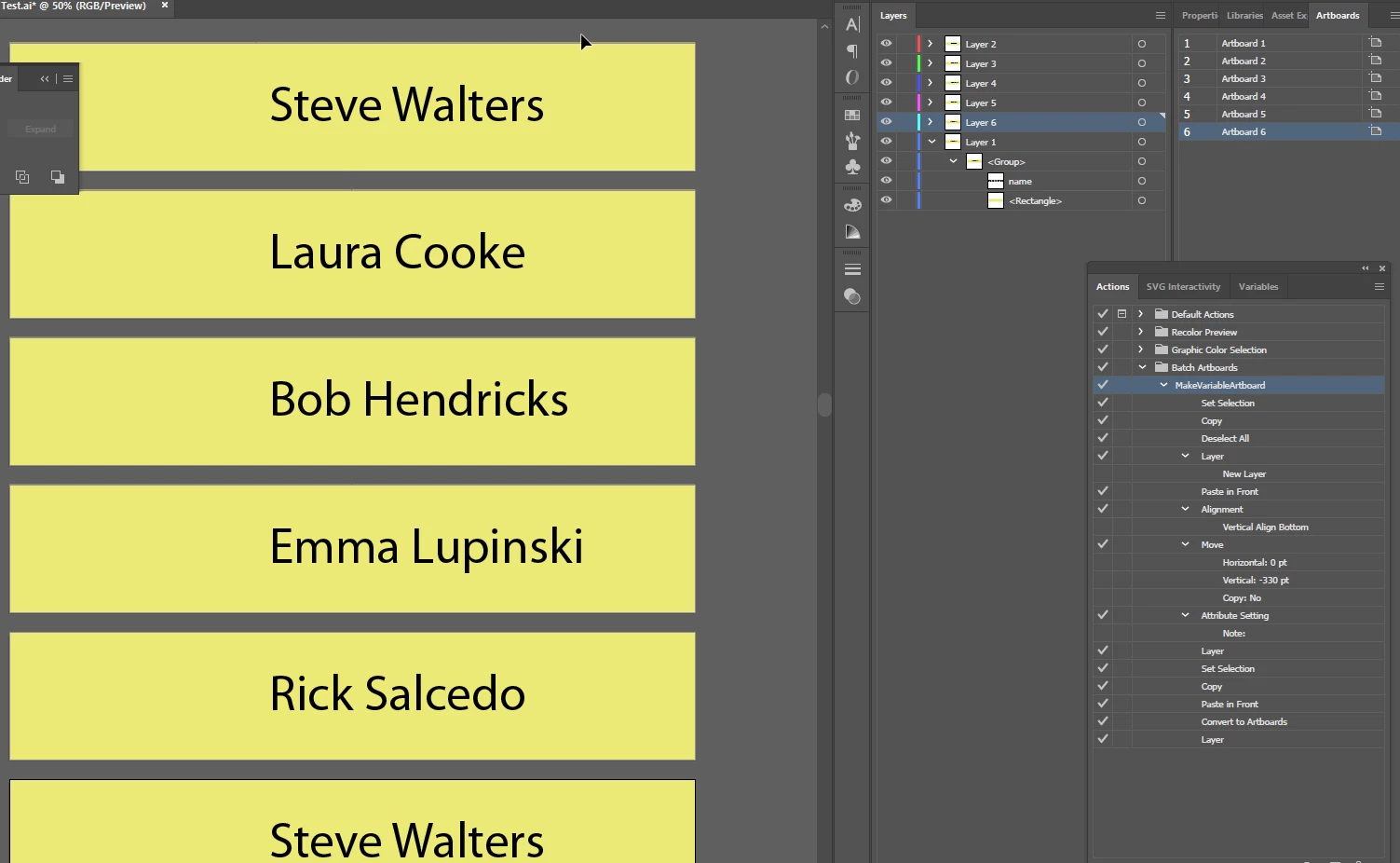

The batch actions play and create the new artboards with the different versions of editable art on their separate layers.
The very first layer contains the original artwork that is bound to the variables, and it has the values of the very last dataset after the process is over. You could hide or delete this artwork, choose to keep it and ignore this first artboard when using asset export or do whatever you wish with this extra artboard as it suits your workflow.
