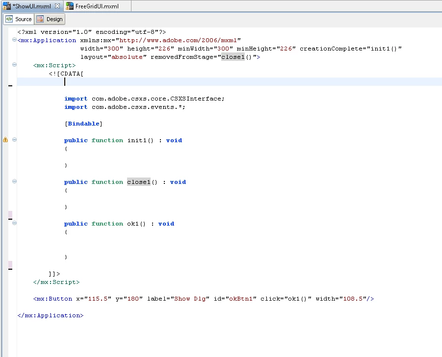

  I am having 2 mxmls :
   1)FreeGridUI.mxml is Same as Illustrator Sample FreeGridUI.mxml.This is the First Dialog.I added a button to show the Sub Dialog.
   2)ShowUI.mxml Is the Sub Dialog's mxml.see the ShowUI.mxml in the below image.

please give your Suggestion to Solve this problem.
