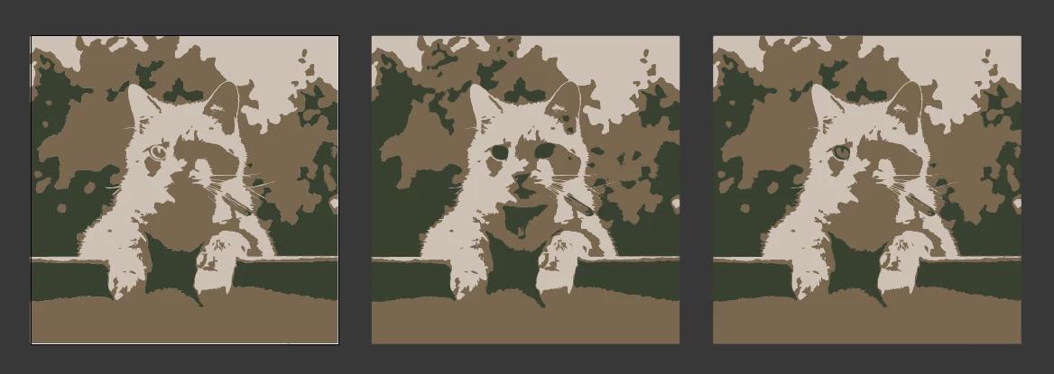

Results in Layers panel on the left with a 16-color image trace for simplicity:
Since you're using Image Trace and didn't give too much detail, I assumed you only wanted fills to be checked, item names intact, layer names to be the specified color in hexadecimal form, the layer label to be equal to this color (though this would make selection hard, comment out the layer.color line in createLayer() to remove), and didn't touch the original layers just in case there's more to the document than these items.

I somehow do not get the script working, it gives the following error:
Inventsable
January 2, 2020
See here:
https://adobe.ly/2QiJZGP
Hi Ton, the issue for this file is that the layers are created in the order which colors are detected, and there is no way to stack these 3 final layers in such a way that it completely preserves the all original path zIndex positions since overlaps exist within this sample. I may be wrong and can try flipping the stacking order to place objects at the bottom as they move to the layer, but I assume this is the problem. For example, in the script output when you rearrange the layer order:
As you can see, nothing was actually removed or recolored but rather the stacking order was changed since the request was to put them in separate layers and layers must exist below or above one another. If a setting for Image Trace which had no overlap were used this would not be a problem, and I could solve this in a few different ways but it wasn't technically in scope of the original question so I didn't know that I had to, also without knowing what settings OP is using or anything about their desired output I'd only be making further assumptions that might not be what they'd intended.
If it's needed I can add it in
