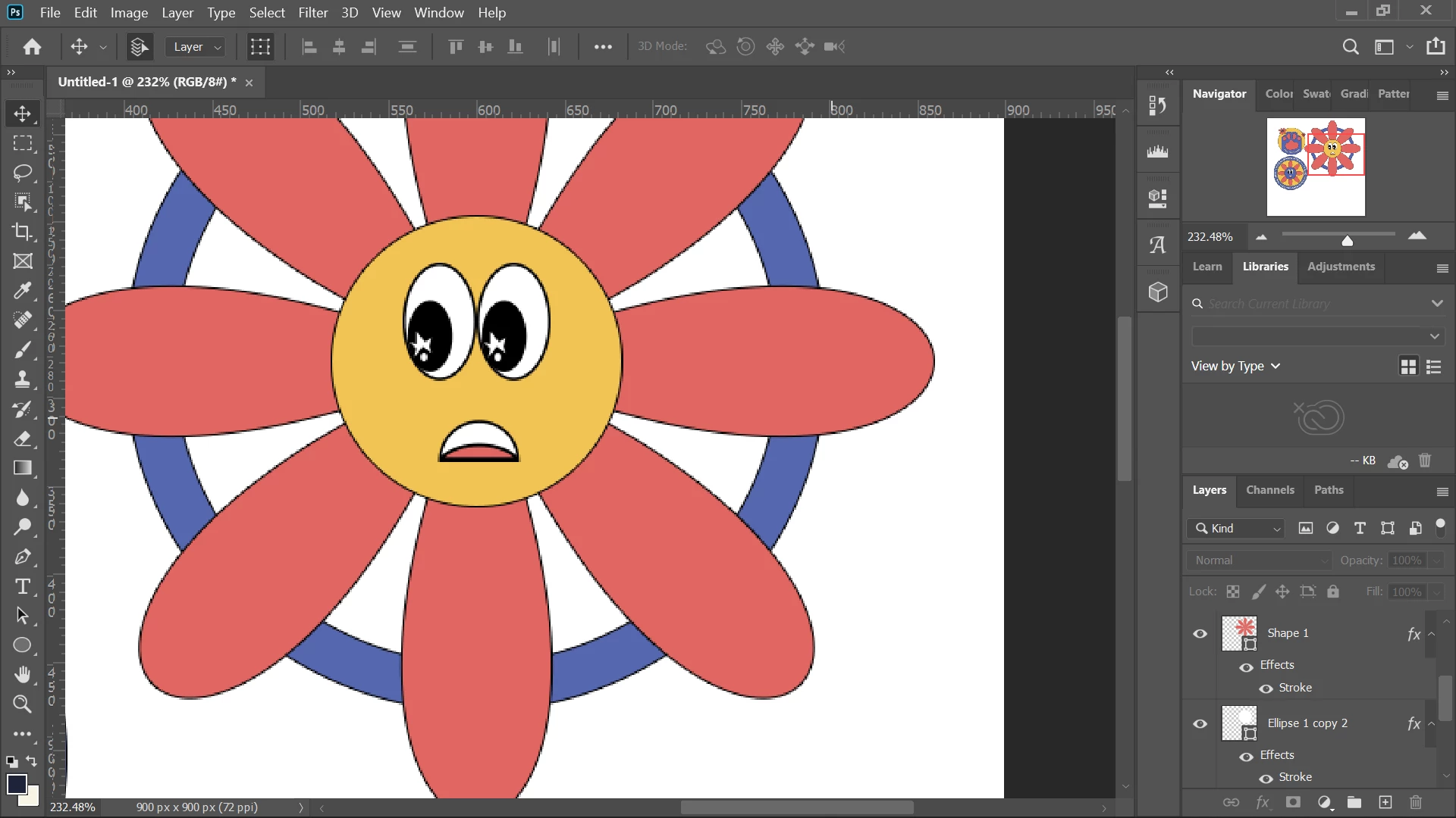

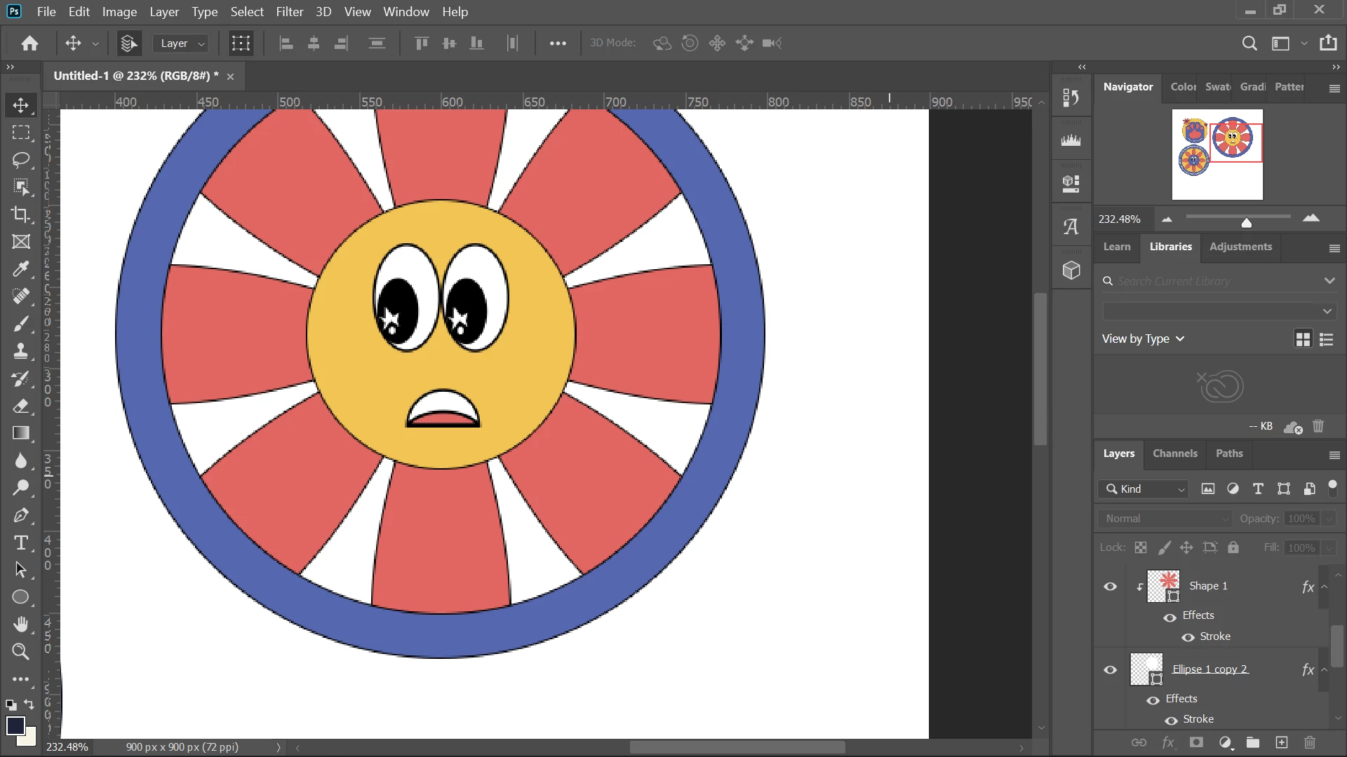

is it possible to use shape builder tool on a shape that has given an effect like bloat & pucker?
  • October 29, 2022
  • 286 views
how do i make this into this in illustrator
