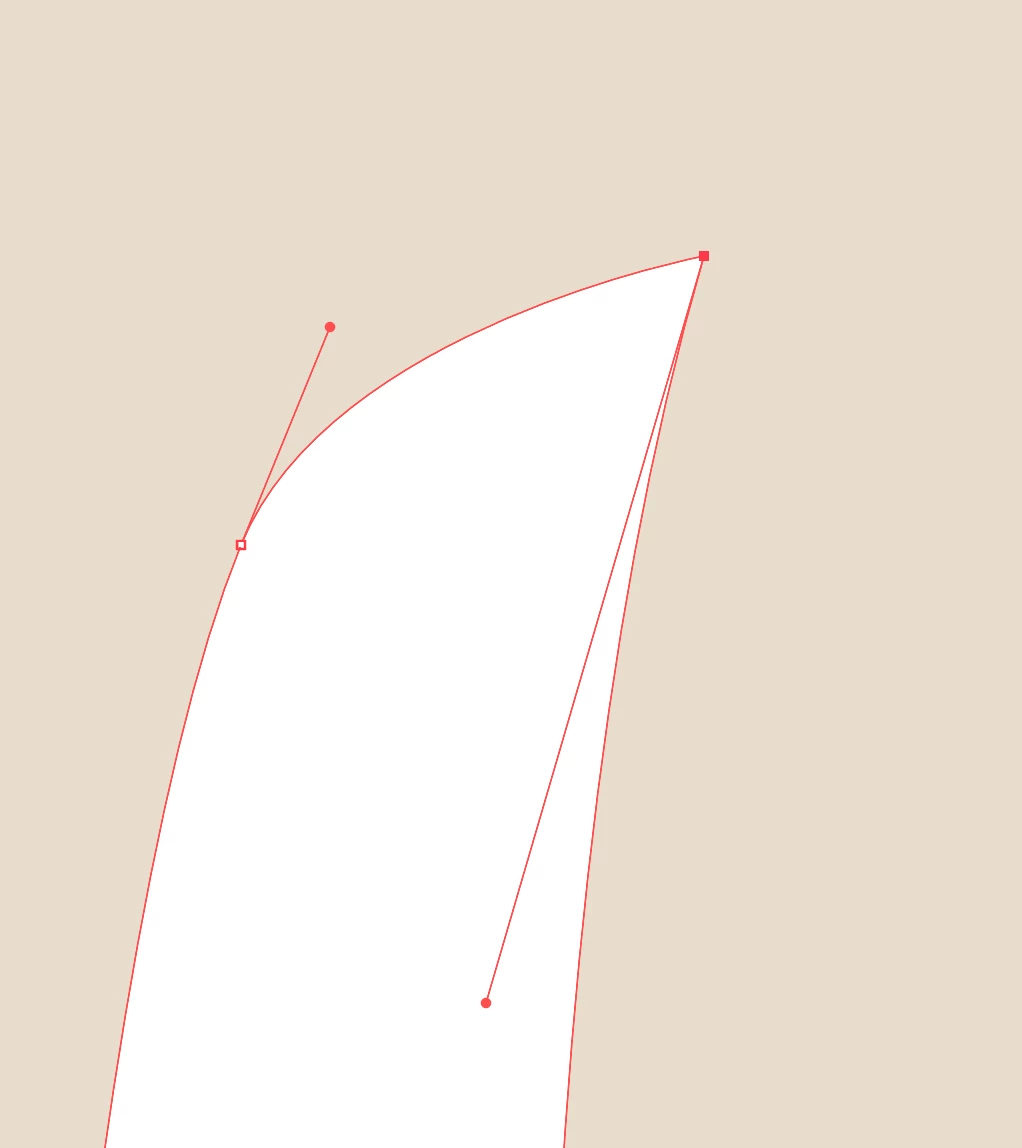

I would like to know how to do this too!! I find it irritating that I can't add a missing directional handle without disturbing the existing.
For example. I want to add a handle to the selected anchor.
Brad @ Roaring Mouse
Mar 6, 2022 8:04 PM UTC
Select the anchor point with the direct select tool, then move the direct select slightly to the left so it changes to the reshape tool, then pull slighly enough to cause a new handle to appear, then drag back towards the anchor point. Now you have a handle to play with!
In my example, I added green guides to show how the existing handle at left changes slighly during this procedure, but you can minimize it by the pulling back towards the anchor with the reshape tool.
Obviously, zooming in helps.
This is even easier if you have the Preference for "constrain path dragging on reshape tool" checked in your "Preferences > Selection and Anchor Display"
