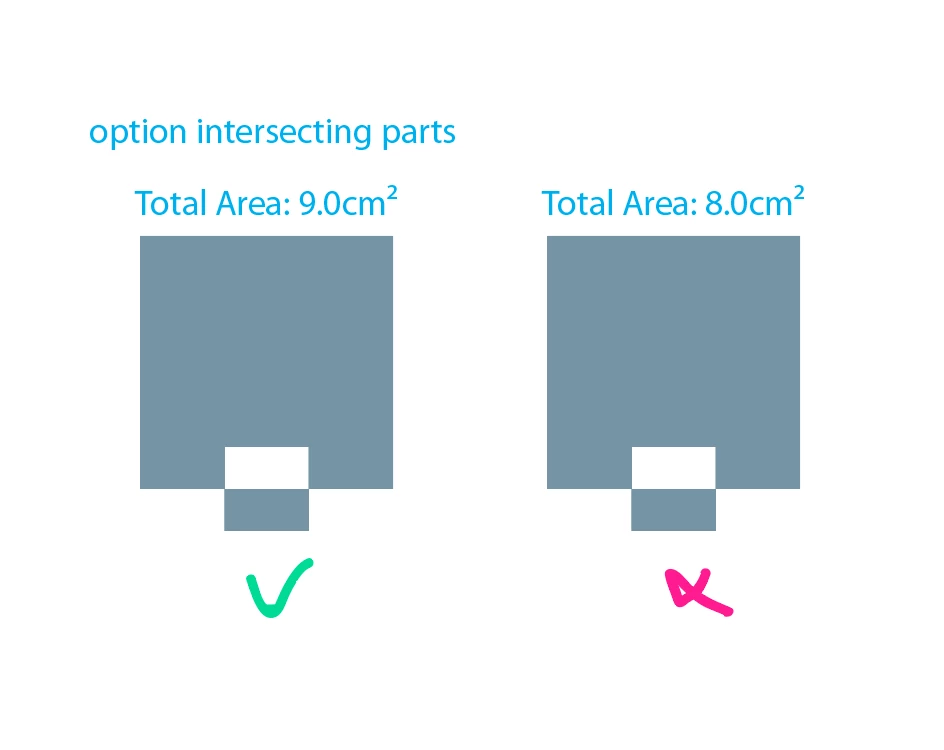

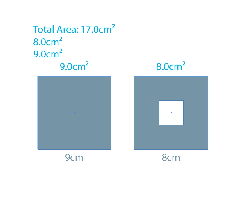

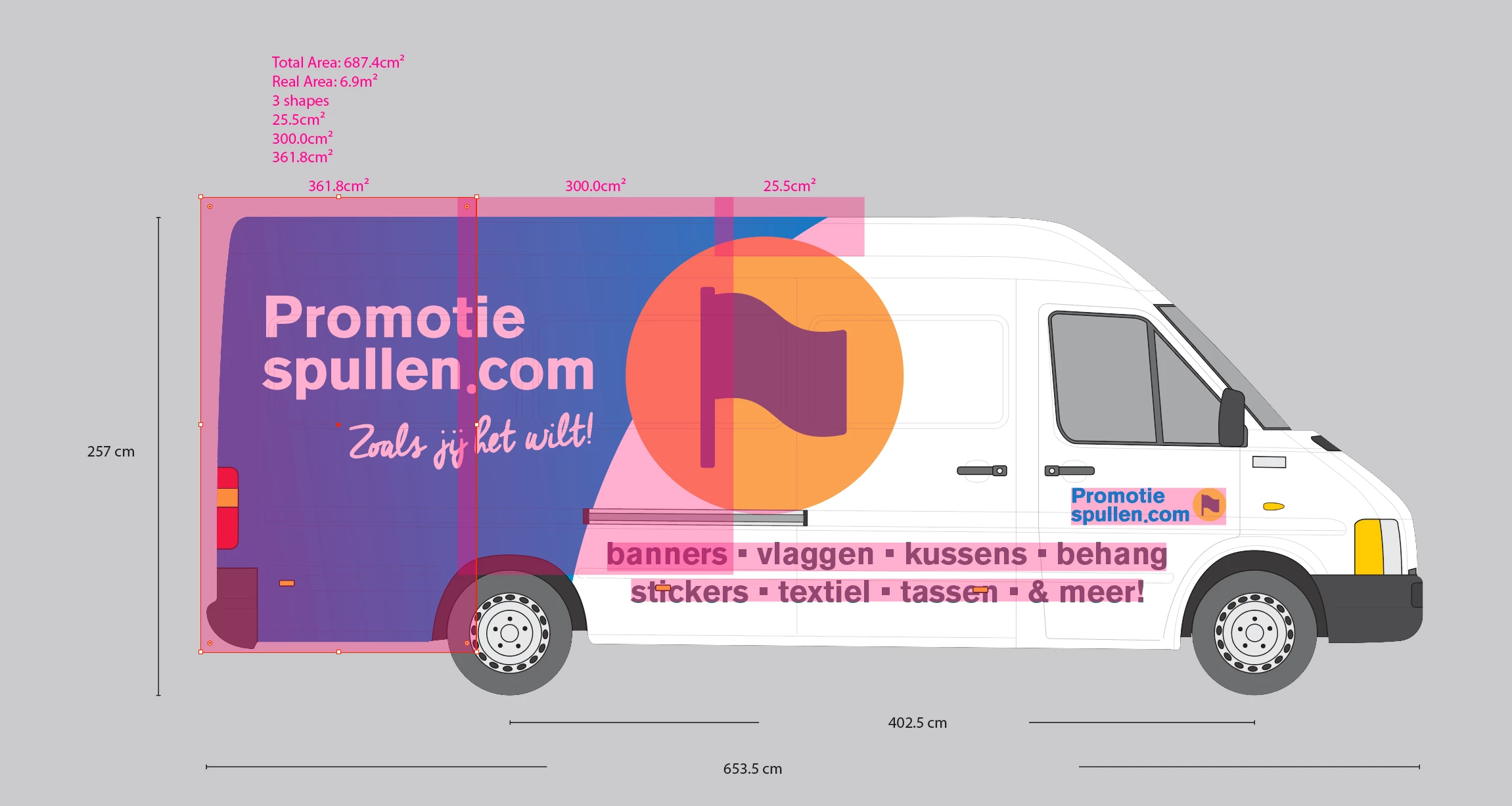

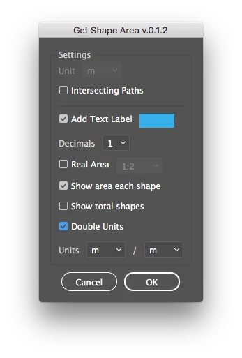

@tynell
Ive worked on that scripted and added a dialog and more functions. You can find it here https://github.com/schroef/Illustrator-Scripts/blob/master/GetShapeArea-dialog.jsx
I can can show multiple digits, 2 different units and can also show real world size. Currently still only m2
Ive also solved issues with pluginitemsshape and compoundshape items
Though there is one issue with very complex shapes. But there is a solution, if we group multiple compoundshape items first, then run trim function then the script
