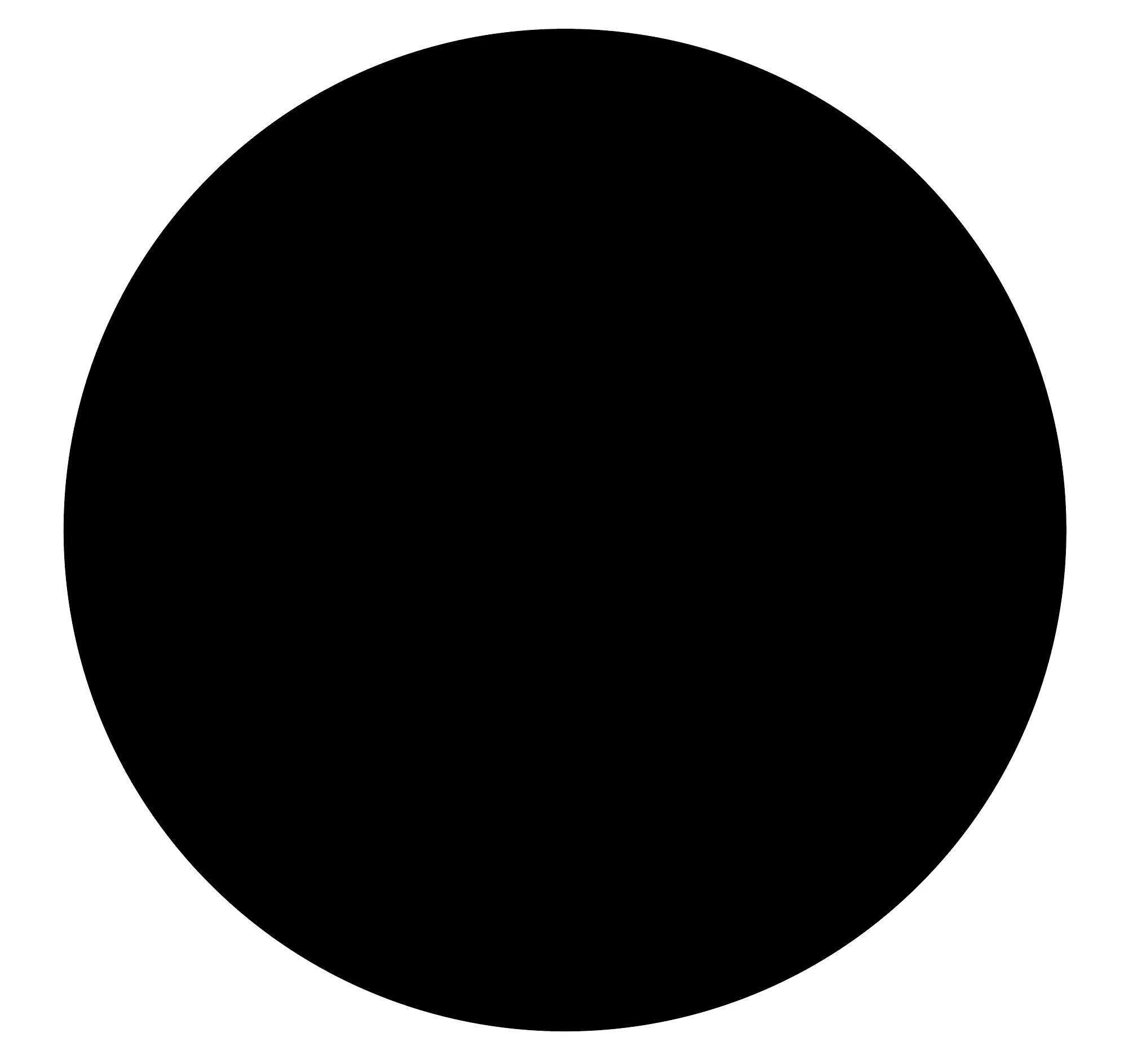

  1. Draw a line segment and add a 2pt. Stroke.
  2. Option (Alt)-Click on one end of the Stroked path with the Rotate tool (R).
  3. Enter .5° for Angle and press Copy.
  4. Press Command+D (Control+D [Windows]) as many times as needed to make enough copies to complete your "perfect" circle.
I said that it's ridiculous, but it does work. At any angle this is turned it's exactly the same radius. I got the idea from Sandee's Flatness post.
See screenshot below.

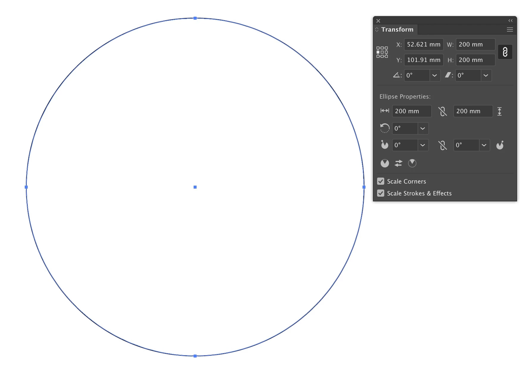

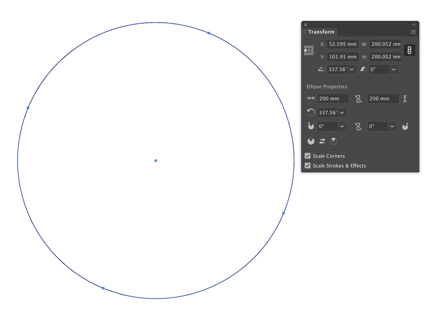

A Bezier circle created with 4 Anchor Points created to have the exact diameter at every 45 degrees, in other words vertical and horizontal and midway in between (as Illy does it, and she has made a good choice), is inherently bulging in between (in between).
Circumference ratio compared with true circle 1.000012175, deviation 0.000012175 or about 12 in a million.
Bulging rate (relative radius/diameter) at 22.5 degrees compared with true circle 1.0002617, deviation 0.0002617 or about 262 in a million.

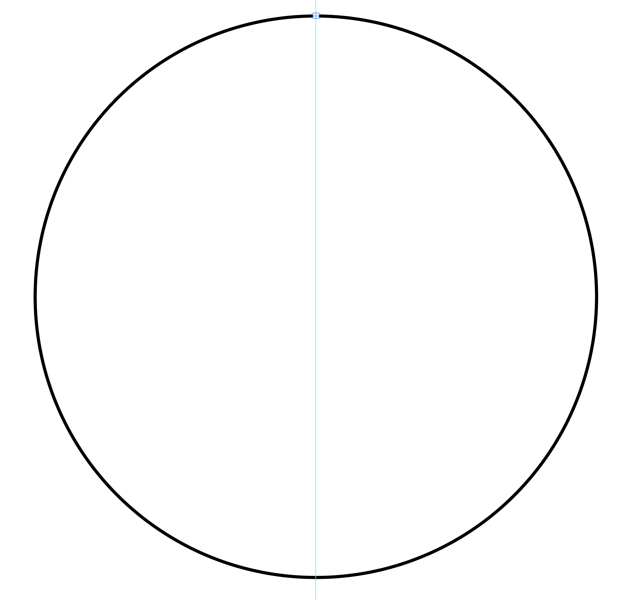

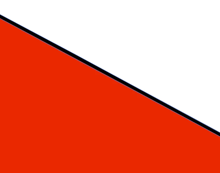

The following image shows the edge of two identical 400 x 400 px "circles".
The orange circle was rotated 6° and the edge zoomed in at 64000%.
Both circles were selected so you can see the faint blue vector line for each.
