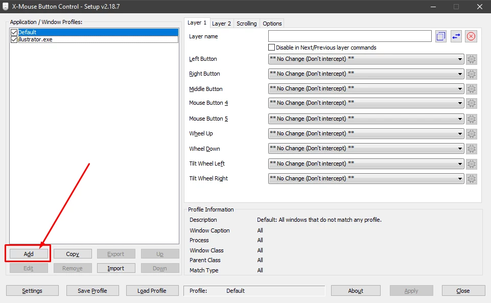

    You will see the first page. I suggest making the new command only for Illustrator (or whichever software you want to assign the key to). In order to do that, click Add in the lower left corner to add just one software.
    Afterwards, scroll the software list until you find "illustrator.exe"
    Then, click it once, erase the Description field contents (don't erase the Application field contents untouched) and click OK on that bad boy.

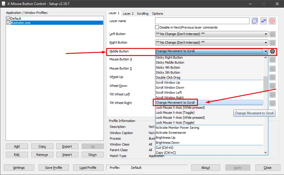

    Now, back to the first screen, you can see a list of the available buttons for changing. Click the dropdown menu for Middle Button, and scroll the list until you find Change movement to scroll. Click it.
    After that, if the configuration window doesn't pop-up, just click the little cog icon next to the field to make the settings appear.
    Now, this is where you season it to your liking, but the closest I could get to the spacebar dragging was this configuration.
