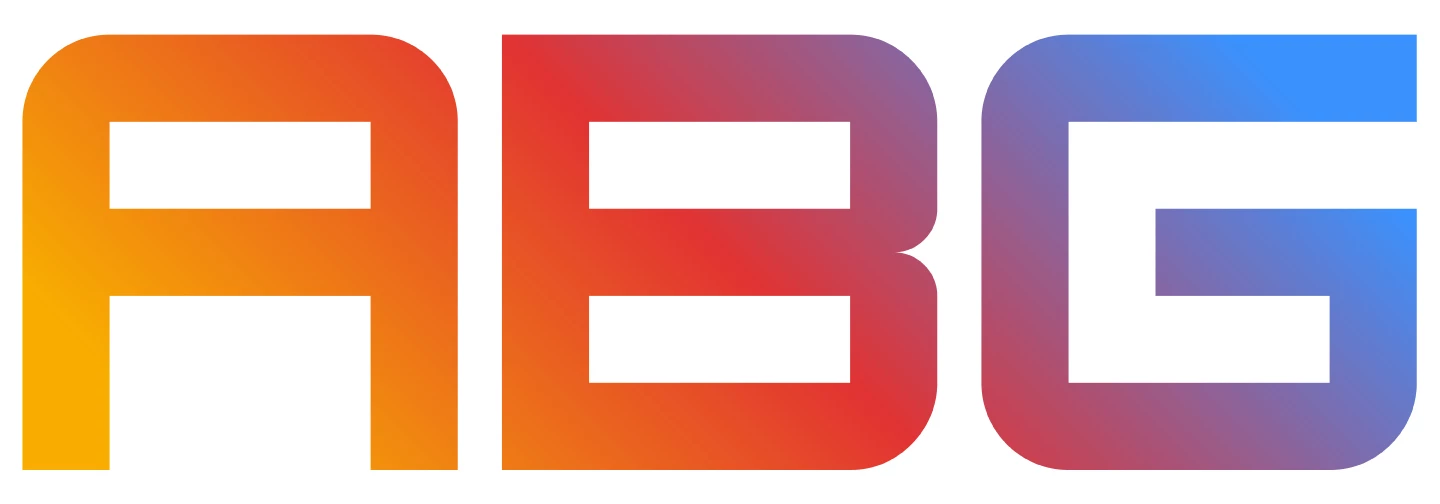

I have a flat PDF design with 3 letters with a gradient applied across the 3 letters. I need to create a cut line for the vinyl printer to cut these letters out individually. I need a .125-.25 bleed to be safe for the cutter.
I do not have the original vector file or i could do this easy.

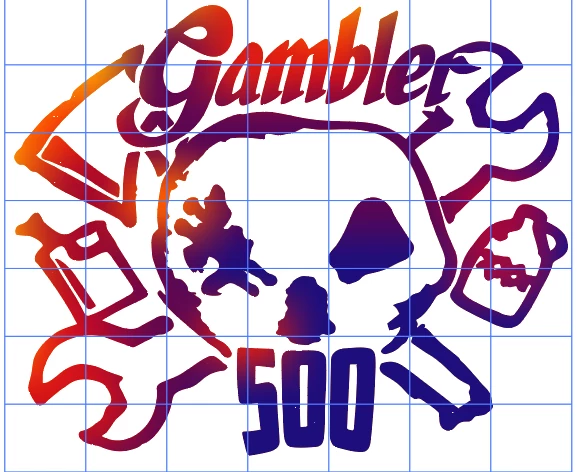

The second file is a design made by AI with intricate edges and designs. This is custom and not an easy piece to work with. It is also flat but it does have a transparent background. There is no way to recreate the gradient on this because it also has a texture applied.

As far as the custom skull n crossbones, i have no ideas. The gradient isn’t even a consistent single direction path.

    For the first one i would:
    Upscale/increase image size in Photoshop and add a Black/white adjustment layer and adjust the Levels.
    Then trace in Illustrator > Expand
    Simplify the path. (Optionally straighten the corners)
    Add the gradient
    Create an Offset path
    For the second one i would:
    Same first 3 steps.
    And a rectangle with a gradient mesh and use the traced image as a clipping mask.
    Add a scatter/grunge brush for the white “noise”.
    Offset path the clipping mask.
    Jun 23, 2026 7:19 AM UTC
    Can you share the files so we can see how they’re built? That would make it easier to advise properly on expanding the gradient.
    For the first one, my gut feeling is that it may be a solid gradient frame sitting behind a keyline outline of the lettering. In other words, a large gradient rectangle with the letter outlines overlaid on top, possibly set to overprint.
    The second one looks a bit trickier because of the applied effect. I’d need to inspect the file to see how it has been constructed before suggesting the best approach.
