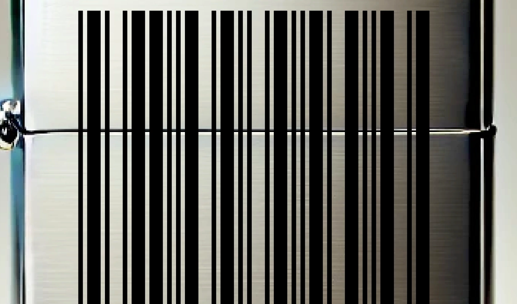

Hi everybody,
I have a bunch of lines I'm trying to cut through. I've tried both Scissors and Knife. I don't want to individually slect each line to use Scissors, and Knife is sloppy. It doesn't have a Shift-slide option to cut a straight line (or I haven't figured it out).
So I'm like...can I just draw a box across this thing and pathfinder delete / punch it out or something? That's what I'd do in Photoshop.
What's the best practice for something like this? This has to be a routine/easy thing to do.
Thanks for reading everybody.

If you do something that actually cuts stroked paths, the shape/direction of the cut ends will be determined by the chosen Cap, Butt/Round/Projecting, basically perpendicular to the path direction at the end.
If you wish to have the (appearance of the) cuts follow a path that may be form any angle with (each of) the paths, you can:
A) If you just wish to hide the ends, use a closed path on top as a Clipping Path, selecting it together with the bunch of lines and creating a Clipping mask/Set; this is reversible;
B) If you can live with filled paths, Object>Path>Outline Stroke for the bunch of lines and use a closed path, or just an open one if only for one end, on top and (without selecting the bunch of line path) use Object>Divide Objects Below, then delete the outlying unwanted end parts; this is irreversible.
Remember to always make a backup of artwork before you destroy it.

This is where I always get messed up. There's no sense of hierarchy with layers in Illustrator. Groups, paths, compound paths, clippings masks...it's a mess, man.
I've got the <Rectangle> sub-layer on top of the Group of lines and nothing shows up in the menu drop down. Not even Ungroup. To do this for above/below, what do the objects need to be? There just isn't a known standard for this that's ever been evident. It's just one of those things you're supposed to figure out like Clipping Masks (which I have over and over then forget, lol).
Can you please tell me what object format these tho things need to be top/bottom so I can get Object>Divide Objects Below to show up or something of that nature?
Thanks for the help, Jacob. 🙂

As far as I understand your request, the Shape Builder tool, the Shaper tool or Live Paint may help.
If that does not help, you may want to share a sample Illustrator file with further instructions, so one can have a look.

Hi Kurt,
Sorry about that. It's been a while since I've been on communities. I have to get in the habit of posting visuals. a picture says a thousand words. I need to slice these barcode lines at the gap. The photo in back is inserted into Illustrator, so I need a good clean slice across the middle. I'll tryout what you suggested in the meantime, but that's the idea. Thanks!

As far as I can see, in your screenshot there is an unknown animal, probably a monkey or a sloth, residing at a blue trunk. With its long forearm it's embracing another stem at the right handside of a barcode wood.
In case that forearm represents the desired cut line, the suggested ways may work well. If not, you may provide a sample Illustrator file, not just a screenshot.
