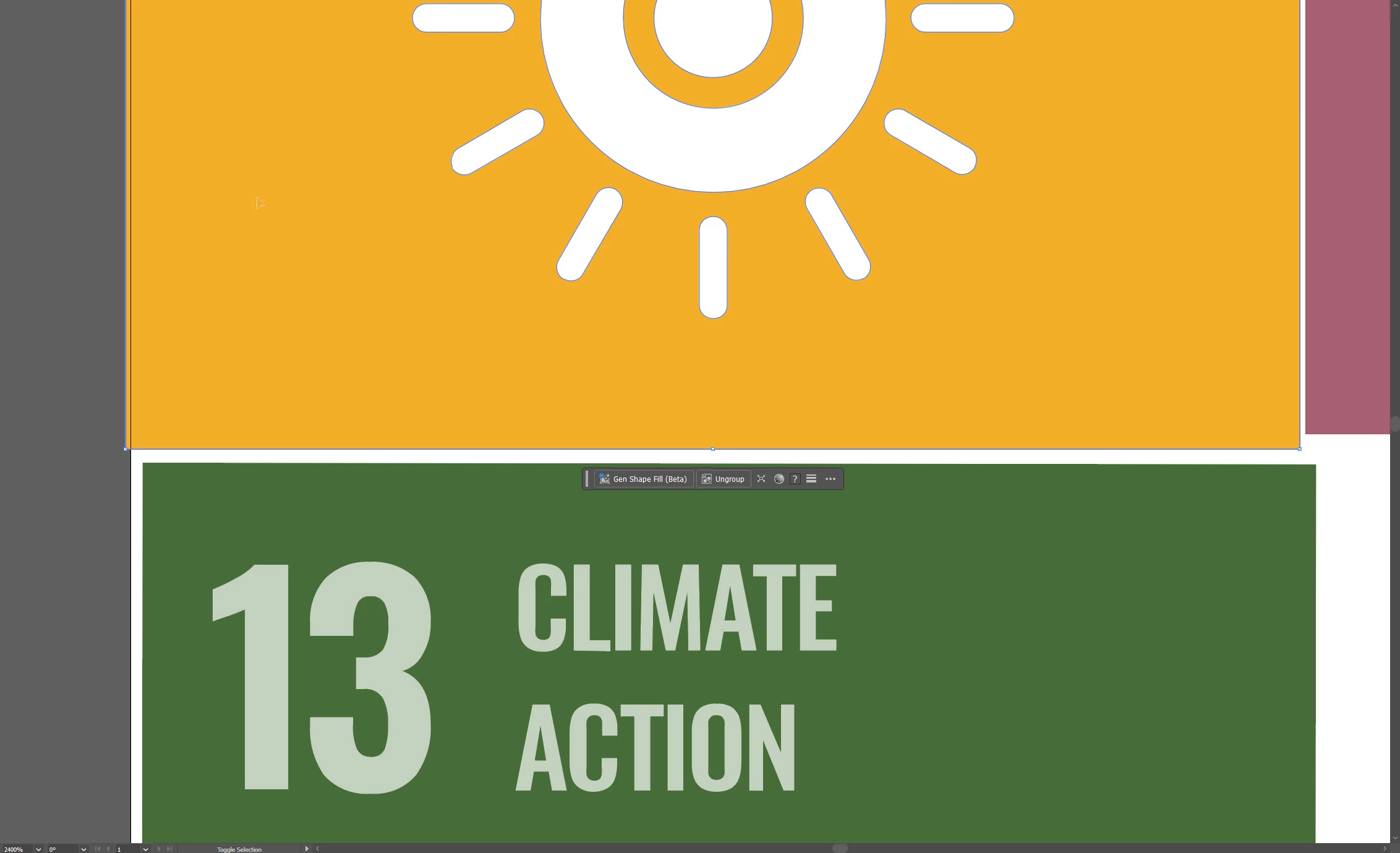

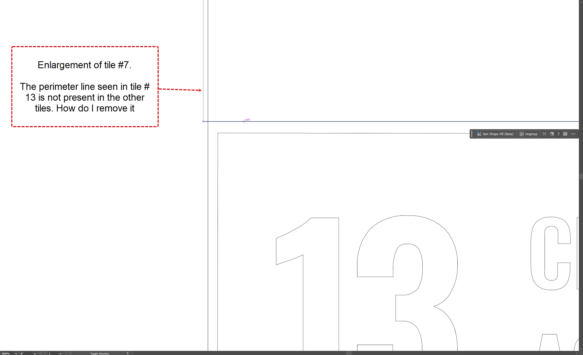

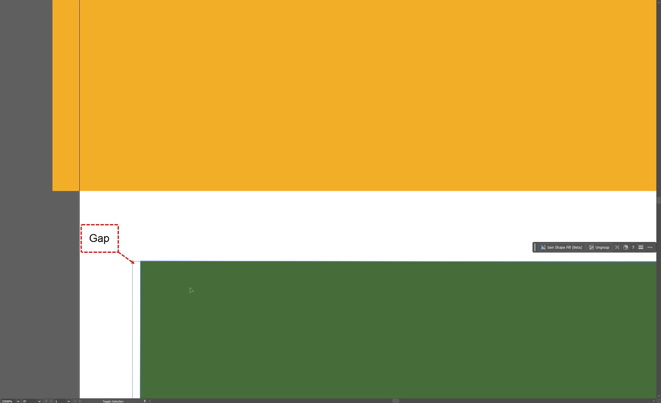

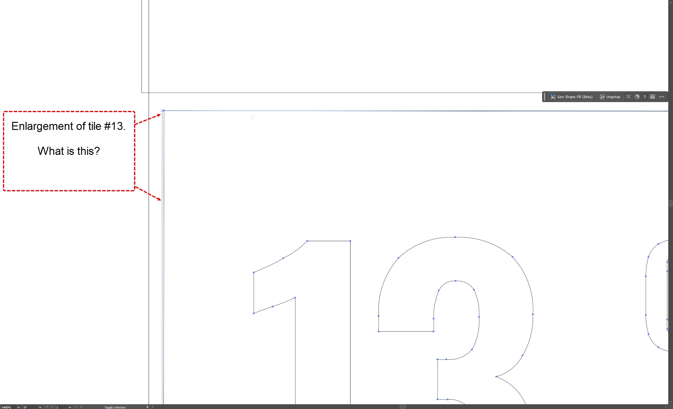

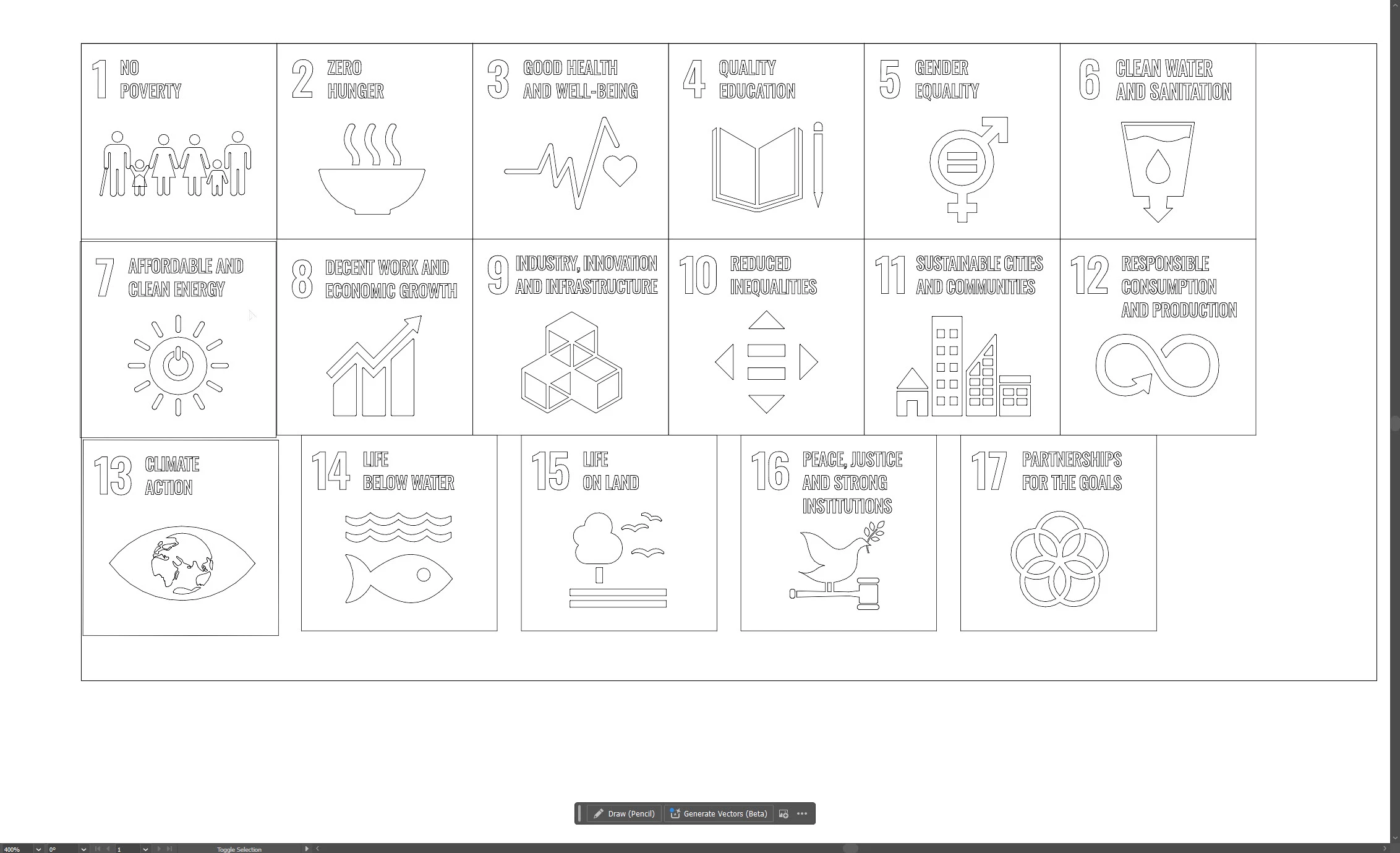

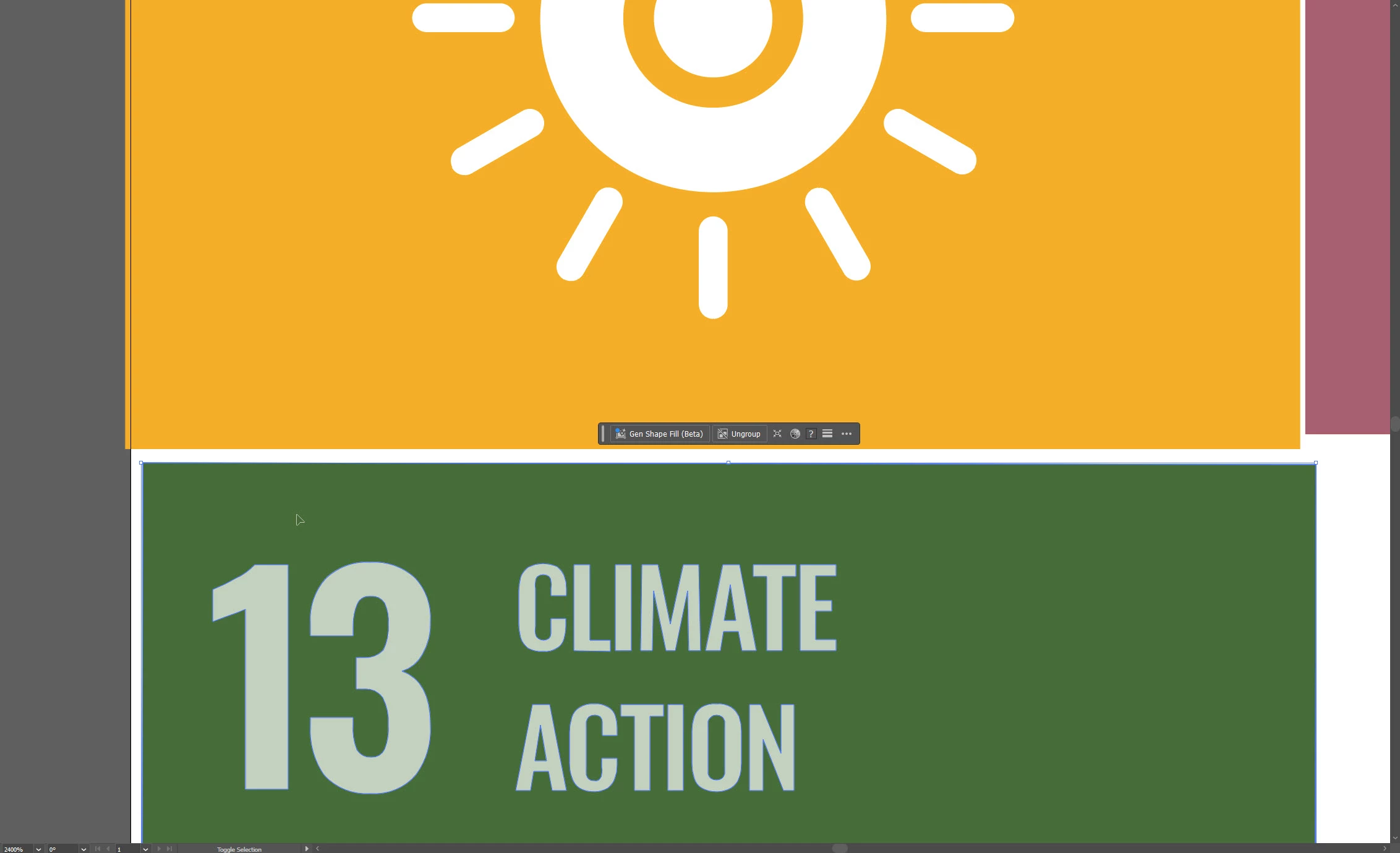

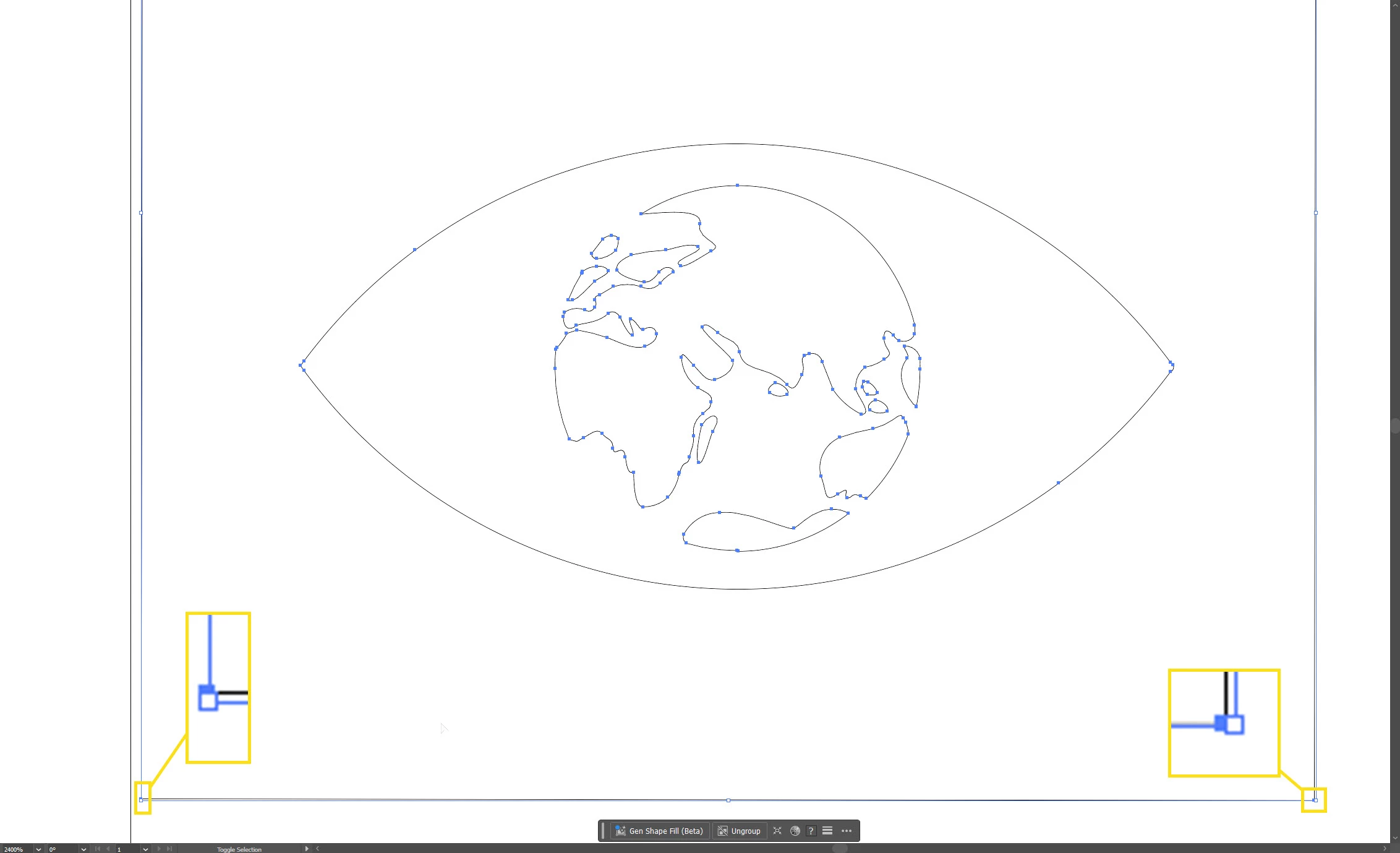

Can someone explain to me whether it is possible to intervene on the element highlighted in the screenshots as it interferes with the precise positioning of the object.
When I bring the object closer to the target point the snap to point feature attracts the point outside the perimeter line.
I have numbered the images for ease of reference

Regarding the ‘Snap to’ options, I have only activated ‘Snap to point’.

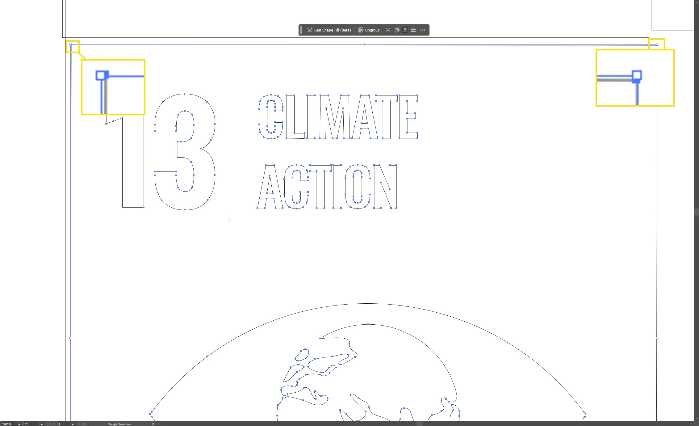

I enclose two more pictures showing in detail what I see when I select the individual object. Tile 7, the one with the yellow background, when selected, the selection border leaves no gaps. This does not happen with tile 13 (the one with the green background) when it is selected. See screenshot.

Would have been better to embed the screenshots in your post.
Oct 21, 2024 3:00 PM UTC
       The images in preview mode are two different images. In one I have selected tile 7 which is not affected by the problem. The other is of tile 13 which has the problem.

Can you show one of the groups in Preview mode with the appearance and layers panels visible?
Oct 21, 2024 3:01 PM UTC
  They are two different images. In one I have selected tile 7 which is not affected by the problem. The other is of tile 13 which has the problem.
Doug A Roberts
Oct 21, 2024 3:17 PM UTC
Looks like tile 13 has been rotated slightly, thus the discrepancy between the object edges and bounding box.
