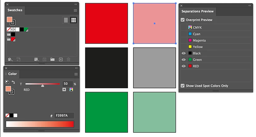

Jacob Bugge
July 14, 2023
Fatih,
"My question is, if I add another red color with 50% opacity, will it count as a new color while printing?"
As I (mis)understand it, the answer is yes but it could be no.
If it is to be printed with CMYK inks ("I have red, black and green colors in my CMYK design."), you will need the K for the black, you will need both M and Y for the green, and C for the blue (along with at least one of the others), so you will need all of C + M + Y + K.
If it is to be printed with spot inks, you will need the red, black, and green, as the 3 colours/inks.
In that case the answer to your question is no, if the "other red color" is/can be made from the same ink by using a tint of the full red colour ink/colour.

Ton Frederiks
July 14, 2023
You could use a 50% tint of the red color.
