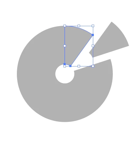

Apologies, I see the issue with polar grid. Shape builder can be finnicky with circles. Try turning on Gap detection (double-click the tool for options):

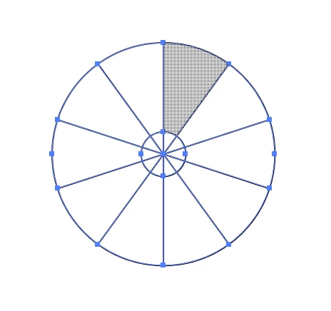

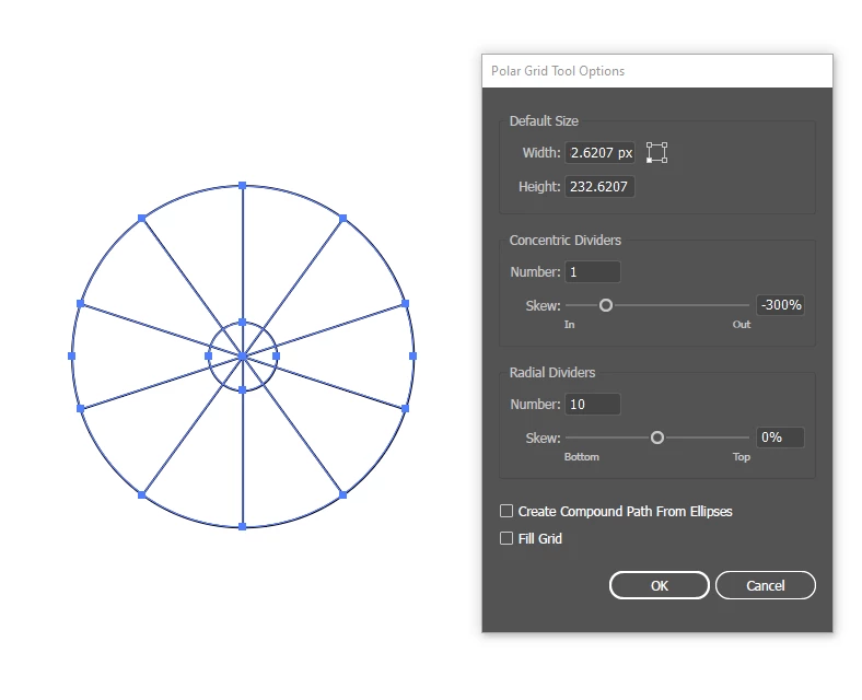

1. Create your base with the polar grid tool
2. Ungroup it. Use shape builder -- click on each 'stair' to make it into a separate shape:
3. Delete the centre (or keep it as your future 'pole'). Give the remaining shapes a fill. They should be separate like so (but don't actually move them -- this is just for show):

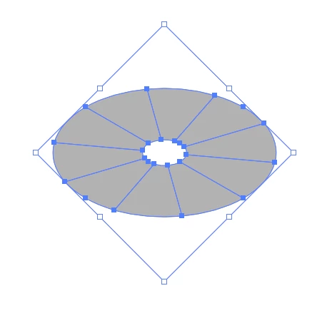

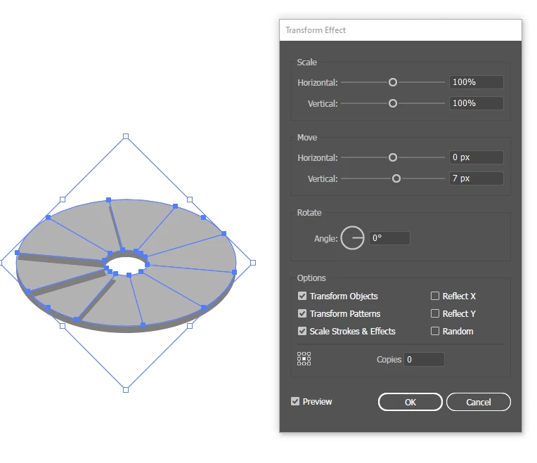

4. Group it again, and use an isometric transformation on the group. This one rotates 45 degrees and then scales vertically 57.74%. Use Object > Transform to do this. Once done, ungroup again.
5. Here I've given the shapes another fill, put it below the first, and used a transform effect to move it down slightly. This is to make them more visible for this demo. If you're drawing this properly, you'll want to extrude them yourself -- but that's on you I'm afraid.

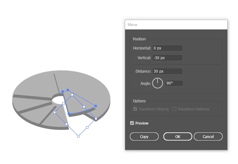

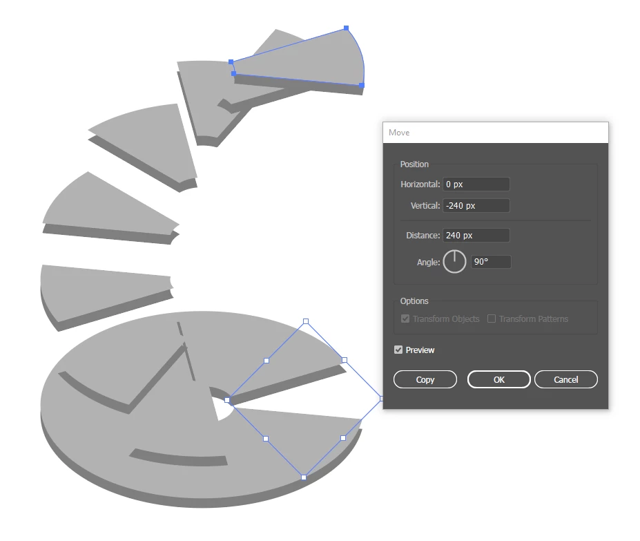

6. Start wherever you want and go around the objects moving each some arbitrary amount vertically. Here I've used 30px, which works at the scale of my drawing.
7. Move the first 30px, the second 60px, the third 90px and so on. Use the copy button so you don't run out of shapes.

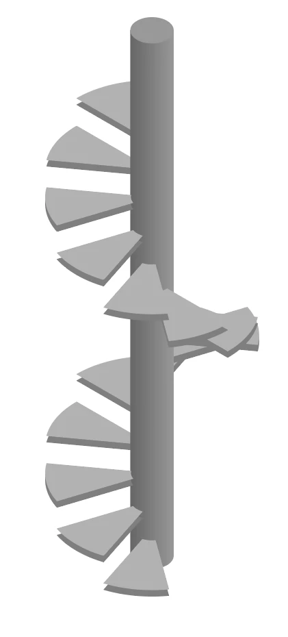

8. You could probably make the pole first, but I forgot. It could be an ellipse with Effect > 3D > Extrude and bevel, but do it however you like. Bring forward/move backward each stair relative to the pole/each other as appropriate.

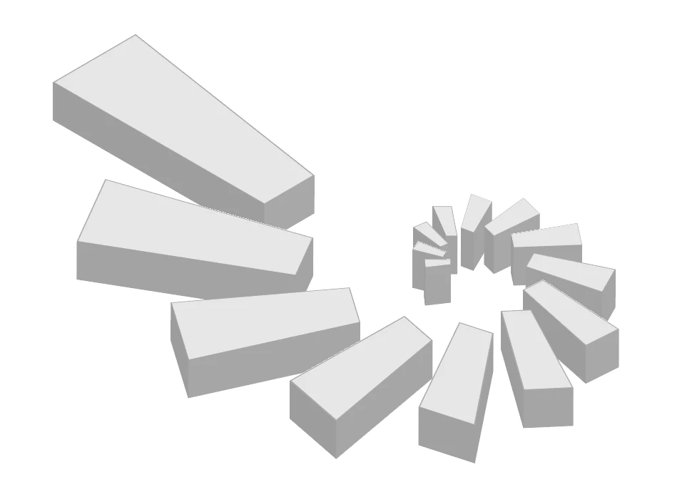

Monika Gause
April 22, 2021
Like this:
