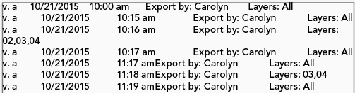

I am making an "Export Log" that captures the version/date/time/artist name/layers affected to help our quality control team. My issue is that any new text added to the box ignores the existing paragraph styles, and I can't see to get it to apply what I have in the file.
I can trace the style, so I know it exists, and I can also trace the text box, so I think those paths are correct and working, it is just the applyTo that seems to not working. Here is my code below:

This is really an aesthetic issue, but I just can't stand the text to look like this:

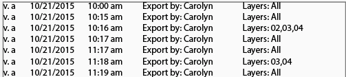

When it could look like this!
