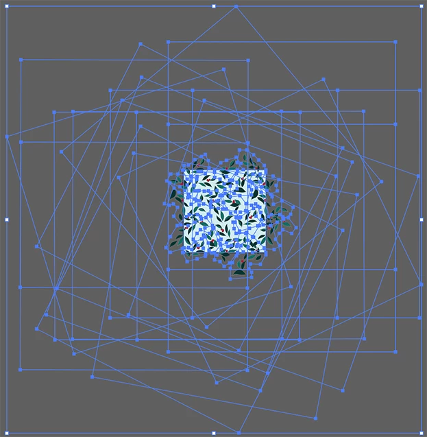

You may have overdone it a little with the amount of clipping paths.
This is what happens when I select all no stroke no fill objects.
Ton Frederiks
Dec 11, 2020 9:47 PM UTC
These simple shapes look like vector, but they are all images.
It should not be difficult to create them in Illustrator.
Now the file is unnecessary complex and heavy.
Clipping Masks: 36
Opacity Masks: 90
Embedded Images: 414
