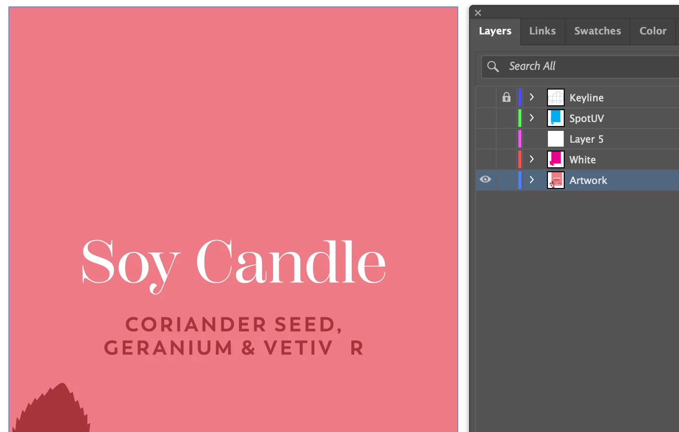

At some point a outlined letter in the Artwork droped to the white layer changes the colour to the white.

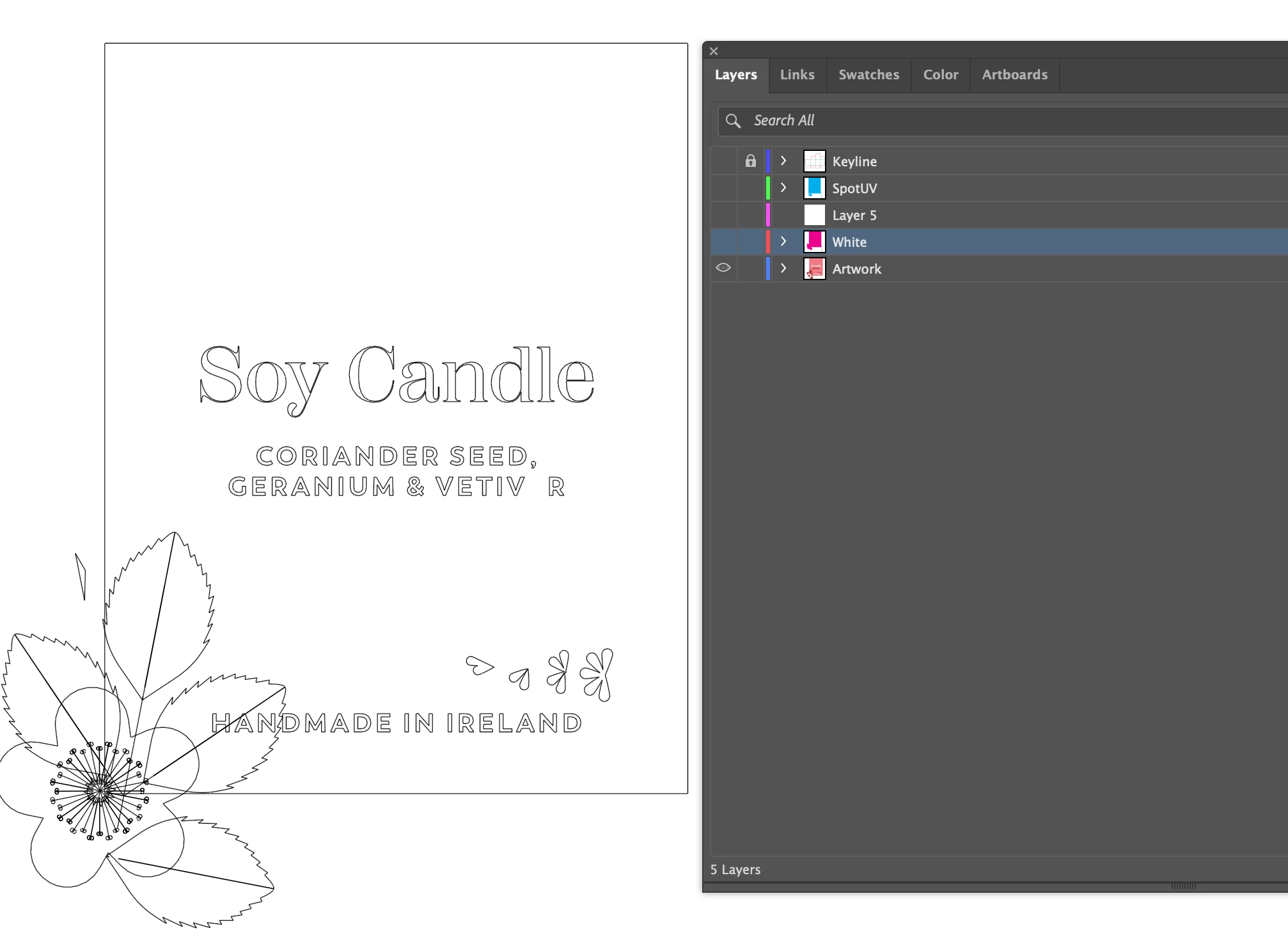

I was not able to grab it only in the outline modus of illustrator.
it was not detectable as it was in the white colour.
Yet it somehow still managed to keep the knock out the on the artwork. Which in this location doesn’t make sense.

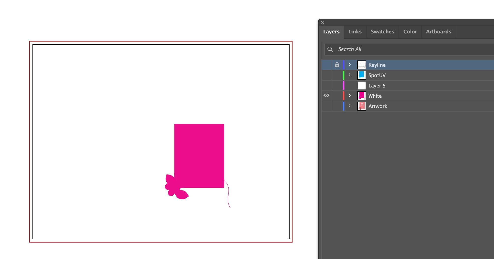

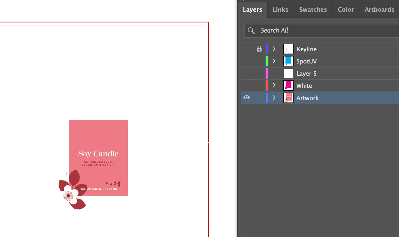

Thats what I do. Artwork is the lowest and locked layer.
I only move the Technical spotcolours with that method to their own layer.

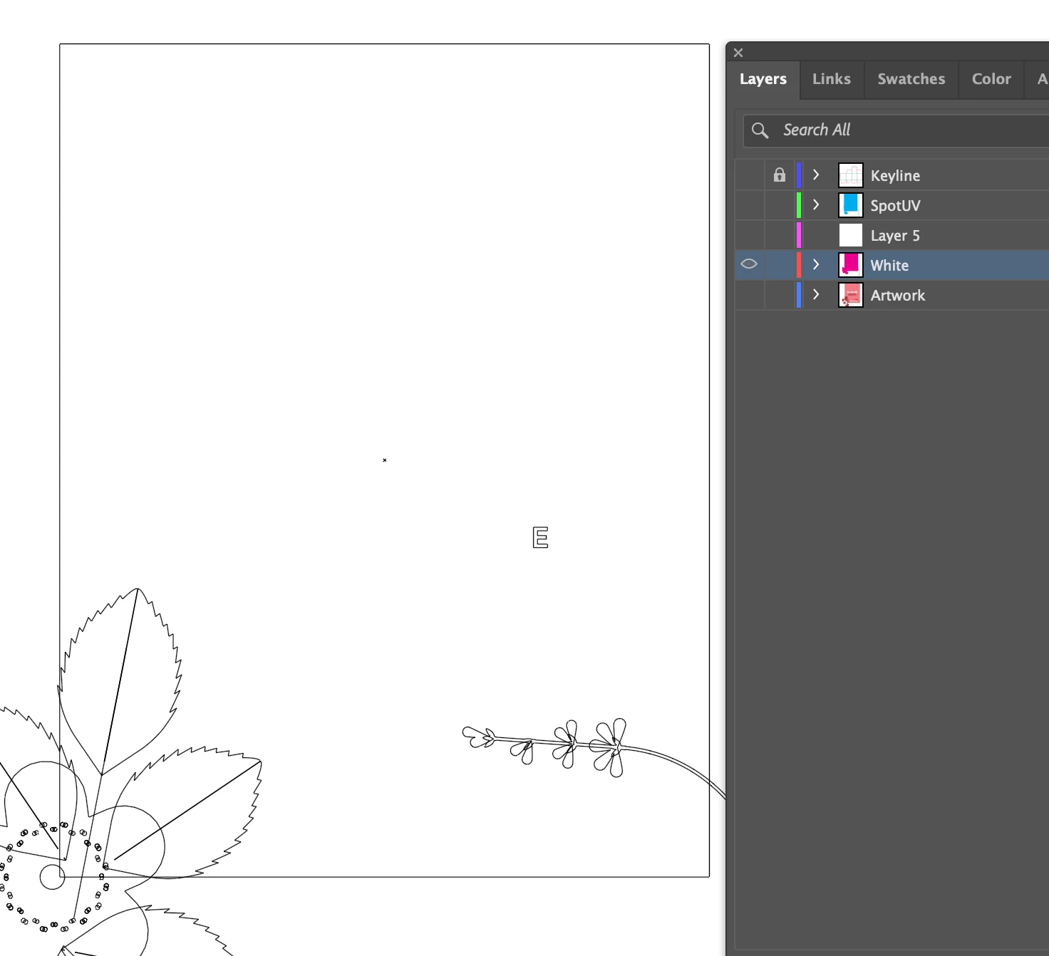

Ther odd thing is that the "E" disapeared from the Artwork layer (colourd in dark red) to the background, used that colour and is not touchable, except in outline modus. I suspect that it is a mask.

There seems to be only the mask on the wrong layer.
