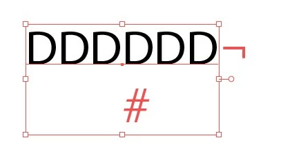

Issue while using force line break
Hi, I have an issue while using force line break in illustrator the forced line break content is created as a new paragraph instead of a line break I have used \n in my script to break the line

Jun 7, 2022 5:58 PM UTC
I need this symbol to represent in code  instead of
