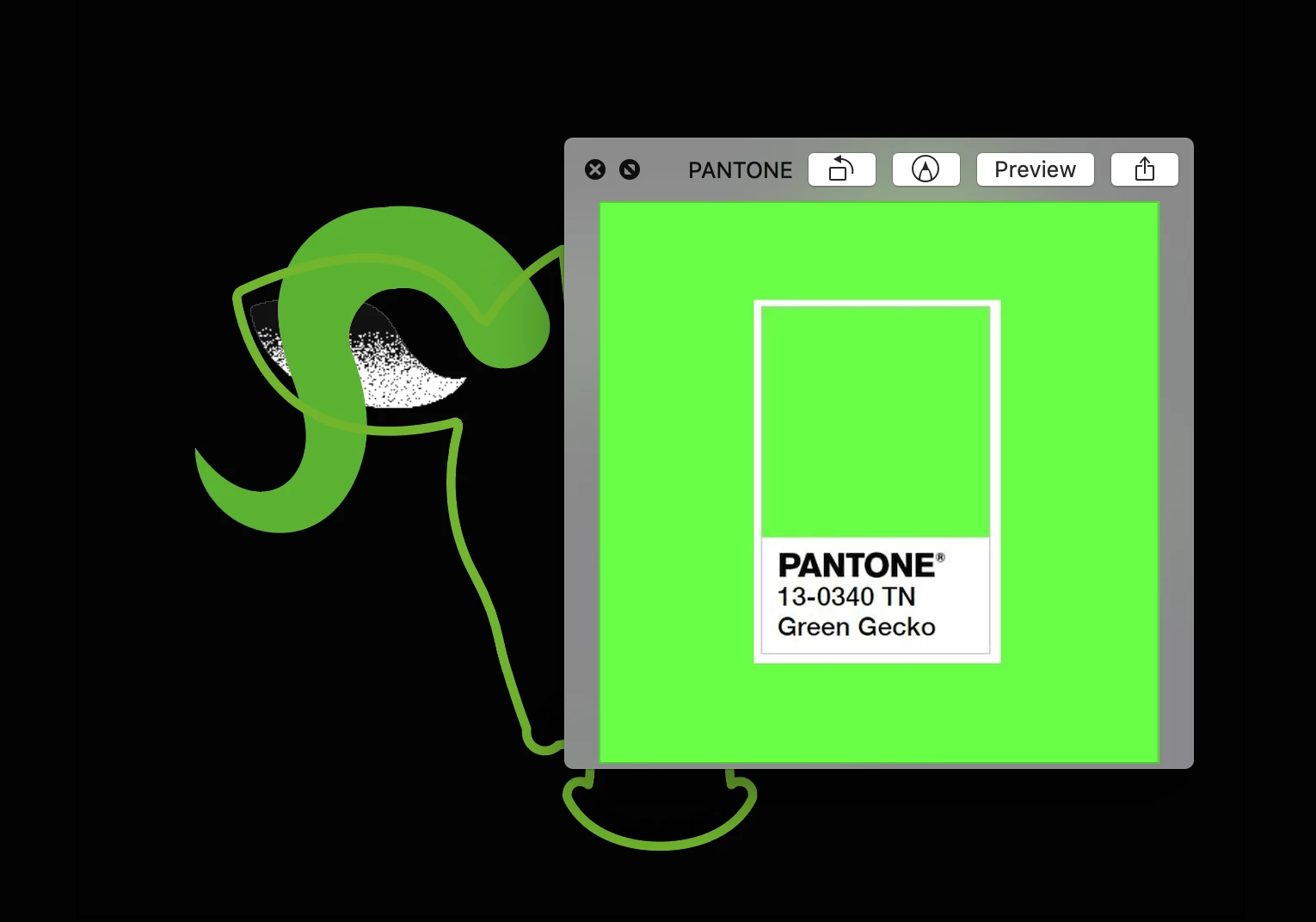

Hello, I have a issue with my logo; I convert my file in CMYK and then insert Pantone Colour 13-0340 TN Green Gecko in the swatches -> library, downloding the file .ase from here: https://color.adobe.com/PANTONE-13-0340-TN-Green-Gecko-color-theme-8779013/; however the visualisation of final outocomes does not much with the pantone colour. MAy i forget some step or may i have to change setting? Thanks

Did you use Lab values for the Spot color and did you use Overprint Preview?

Thank you. I forgot to set Overprint Preview. Many thanks for the advice
