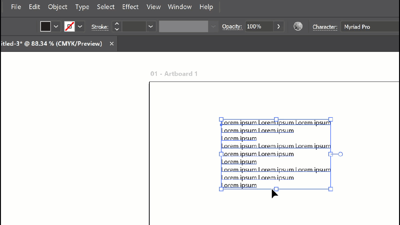

    Thank you Monika for the link (I’m a fan of your tutorials). I still have the same problem. Here in this screen recording, I convert to area type, select the path with the direct selection tool, choose a turquoise color, but my background behind my text does not change.

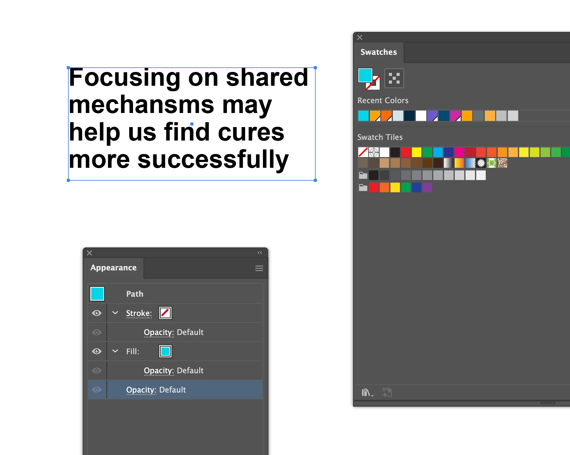

    Can you please show screenshots? They should contain the Appearance panel for the selected object. A background for point text objects is often applied via additional fills and effects.
    Jul 20, 2026 6:23 PM UTC
    Thank you! Here’s an example.
    I’ve added a blue background to the text box but it isn’t showing up.
    Monika Gause
    Jul 20, 2026 10:02 PM UTC
    Thank you.
    You can add background to point text with the appearance panel. In Area text you need to select the area itself with the direct selection tool:
