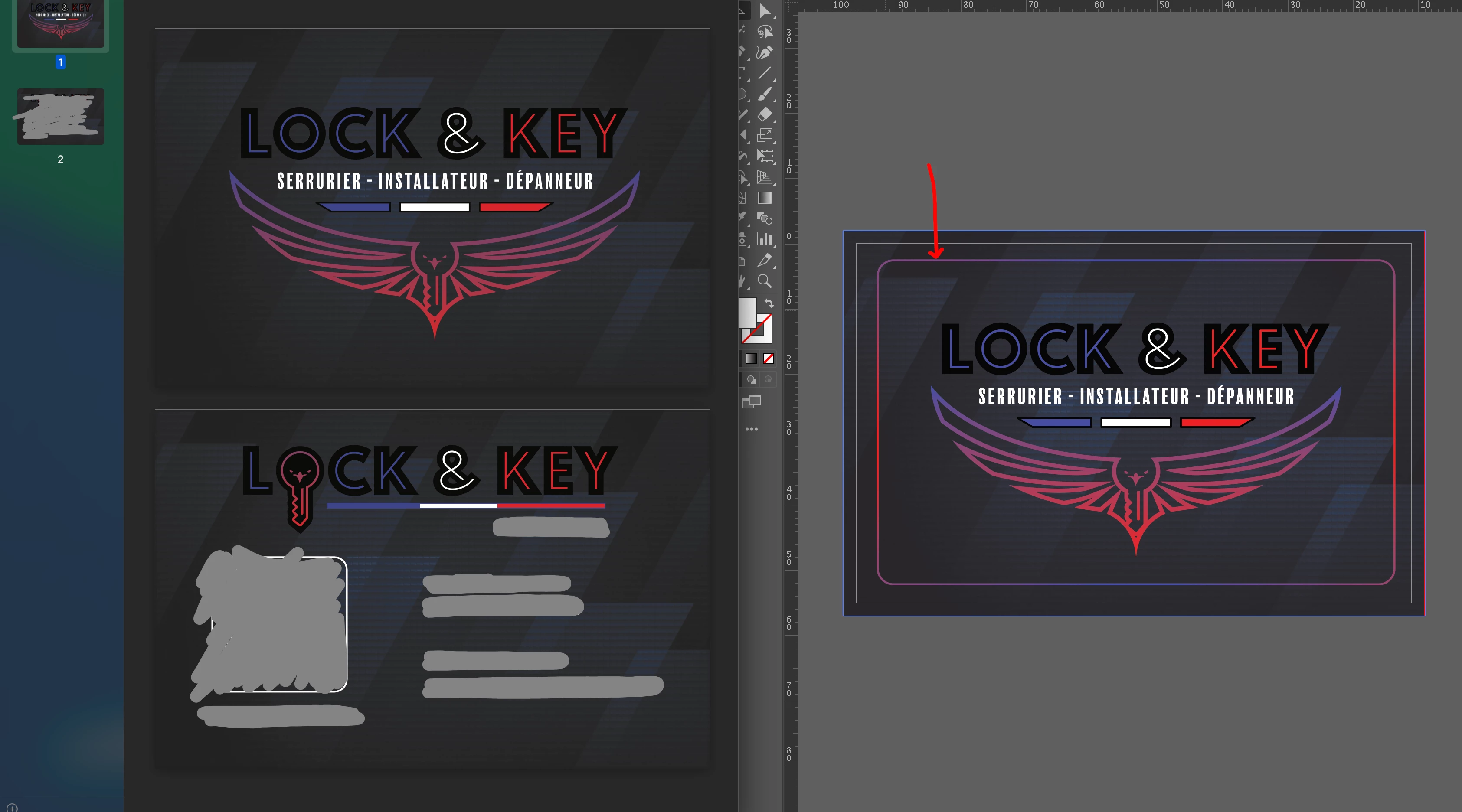

2023, same issue here! I have a quite simple and light file, business card, front and back sides, one simple bitmap image as a background and the rest is vectorized. I have a thin gradient frame all around the content that does not appear on the exported pdf but is very visible on my Illustrator file. The comon fact that I see with my file and the author of this topic is that we both have two or more artboards. Could it be the reason?? I have not tried to remove one of them since I need both sides of the card in one single pdf file anyway.
See the screenshot: the pdf file is on the left, without the frame that you can see on the Illustrator file on the right.
Monika Gause
July 13, 2023
What kind of gradient is that? A freeform gradient?
Which PDF viewer do you use? If not Acrobat, please try that.

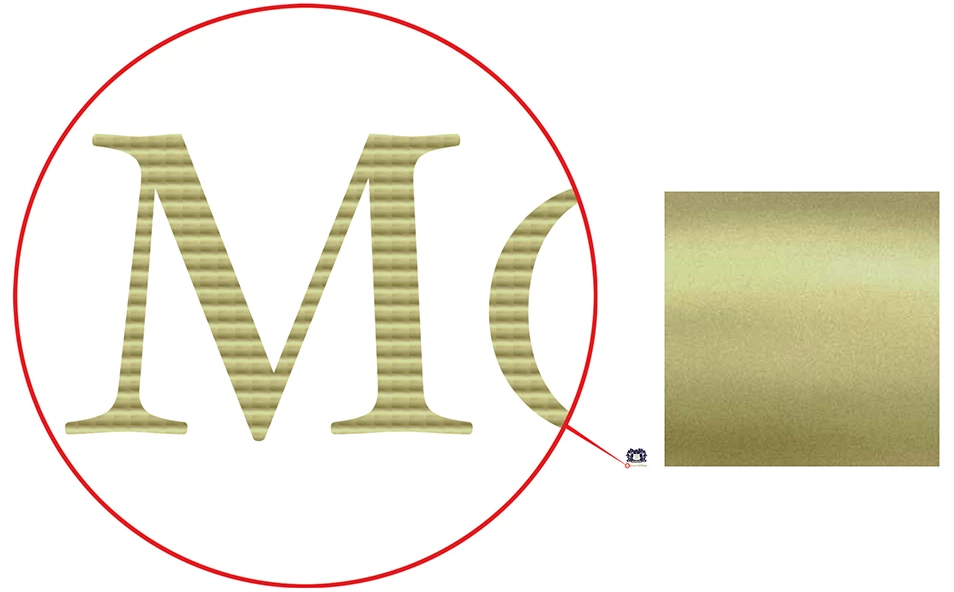

On the right, a single pattern tile, used in logo text, shown at 100% in the middle.
On the left a zoomed view of the text filled with the enormously scaled pattern.
Ton Frederiks
November 9, 2020
You probably made the file too complex by using image based pattern swatches that were scaled a lot, resulting in an enormous amount of images.
Look at the golden patterns (like New Pattern Swatch 76) try to do a select > similar > fill and replace by a flat color (or a gradient).
